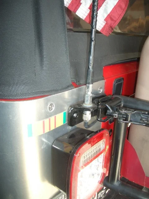

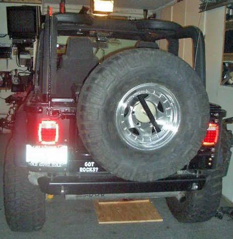

This is the style of antenna I would have recommended had you asked first.... a Firestik II FS series which is available in lengths from 2' to 5' though I'd go for a 2' or 3' at the tallest. http://firestik.com/CatalogFrame.htm and click on the Firestik II link. Amazon sells them. Personally I'd go for the Firestik FS-2B (black) or FS-3B which are 2' or 3' tall antennas, depending on what height you want. I prefer 2' tall since it doesn't get hung up on obstacles or need to be removed when I drive into my garage. It also works extremely well even when I am leading large groups of Jeeps around, the tail-end Jeeps always hear my CB loud and clear. You don't need a real tall antenna just to go trail riding with friends.
18' is not a critical length of coax cable for the style of antenna we use, though most come in 18' lengths. It can be 15' or 23', it doesn't matter. The 18' length thing is an old wive's tale based on a partial non-thorough RF education that sounds good but isn't true in reality. SOME antennas require a specific length of antenna cable but not the type of antenna we typically install onto our Jeeps.well looks like i made a good buy, I dropped by a LOVE truck stop and picked up a Uniden PRO505XL CB. i dont know how that differs from your 520XL Jerry, but ill bet they are close. A truck driver handed me the FireStik II FS3VB so thats what i bought and was all on sale. I have not bought a mount yet or the coax, but it says use with 18 ft. of fire-Flex Coax. Is it important that i use exactly 18' of coax? also where did you mount your fireStik II
That's fine. Some may start screeching and complaining you can't coil excessive antenna cable, that it has to be coiled in a figure-8 to prevent problems, but that's not really an issue for a typical size loop at the frequency our CBs operate at.Jerry, if it only actually takes 6' to make it to the radio from the antenna, do ya just coil up the excess and put a zip tie on it and throw it under the rear seat?
Doesn't matter at all, it wouldn't matter with the hard top either. My Firestik antenna is only 2' tall so it doesn't extend up past the roof top either.Jerry, I have a soft top, So is it important that the antenna stick above the soft top or does it really matter with a soft top?
