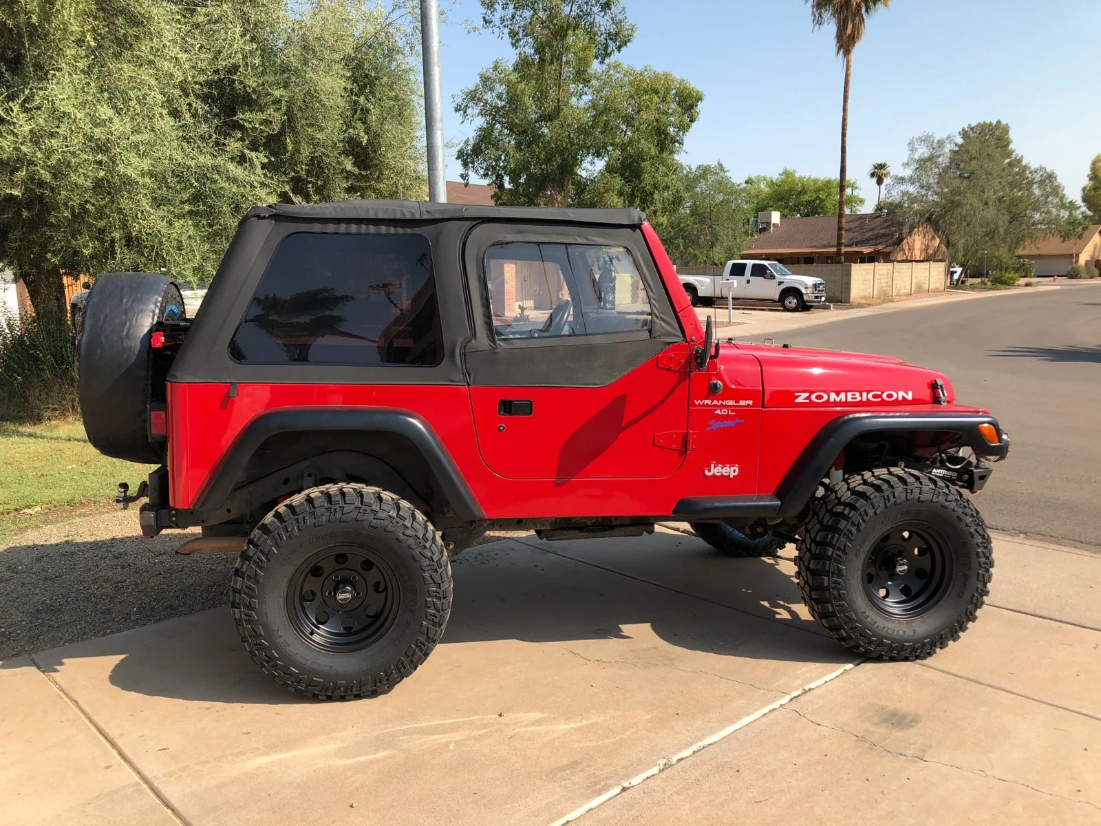

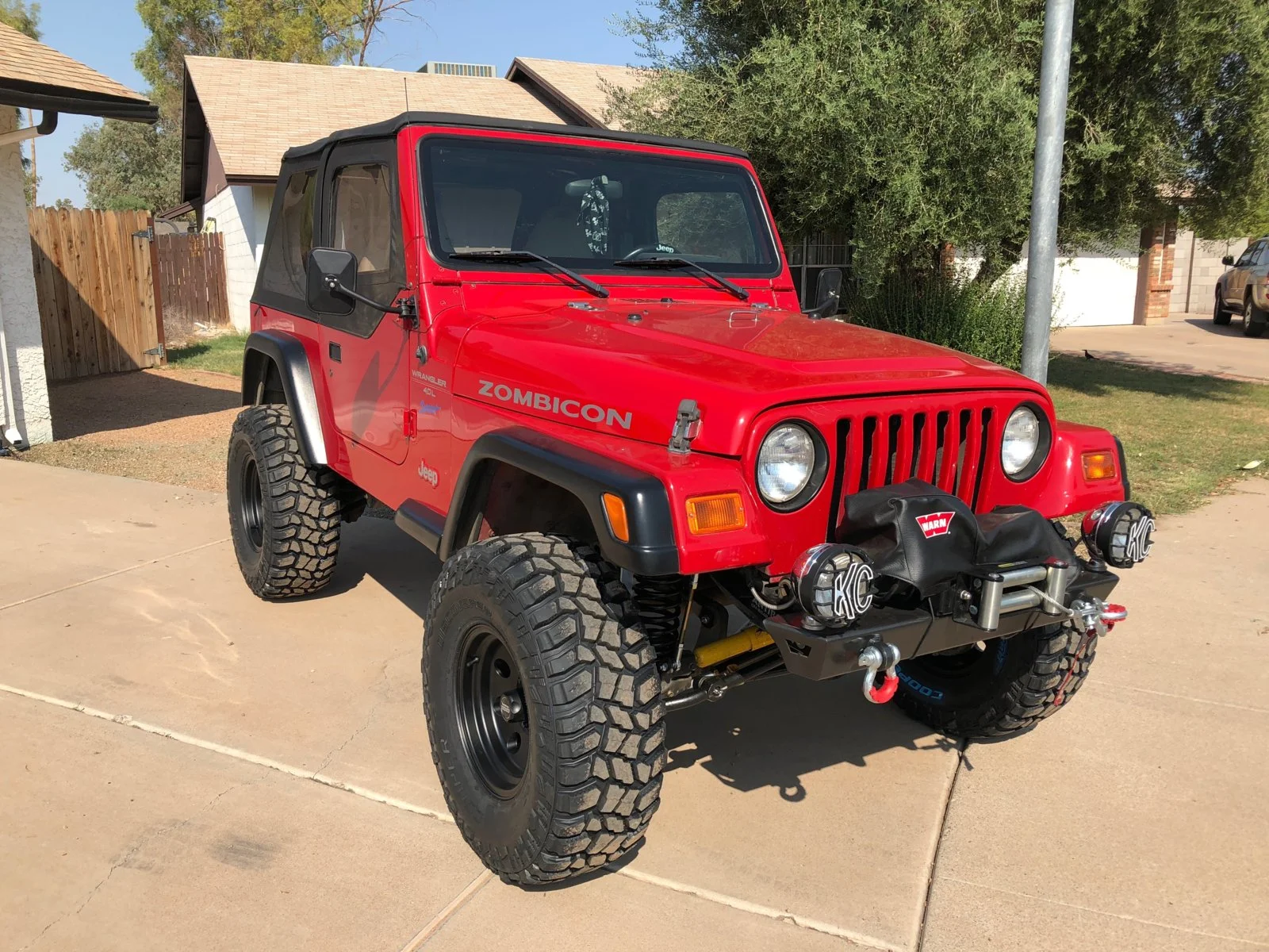

might want to let a little air out. looks like you are running more on the center of the tread.Ok last update, Got my lift and tires on. Still need to plumb the air bags and probably re torque and check adjustments, but here it is with the new wheels and tires:
I set them all to 30 before I drove it. I could let a little more out but then it will lower my lift hehe. What PSI are you running on yours?might want to let a little air out. looks like you are running more on the center of the tread.
Ok I will drop some more, I didn't even notice that. I was just looking at the awesome lugs.Im at 25psi. It runs flat.
I used a tire marker at autozone and marked them ran around the block. Let air out. Rinse and repeat. Till the mark was gone completely.
That thing looks beastly! :thumbsup:Ok last update, Got my lift and tires on. Still need to plumb the air bags and probably re torque and check adjustments, but here it is with the new wheels and tires:
Haha, Thanks, I get the reference, I am old.Looking good, Mr Kotter! (younger guys might not follow, just Google LOL). Glad it worked out for you. I love the red with red accents on the winch and hooks!

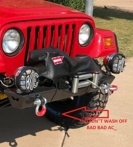

Wash the blue off the Cooper white walls on the inside with bleach white looks great
I was hoping to wash them with mud water soon haha!Wash the blue off the Cooper white walls on the inside with bleach white looks great
That works too!I was hoping to wash them with mud water soon haha!
