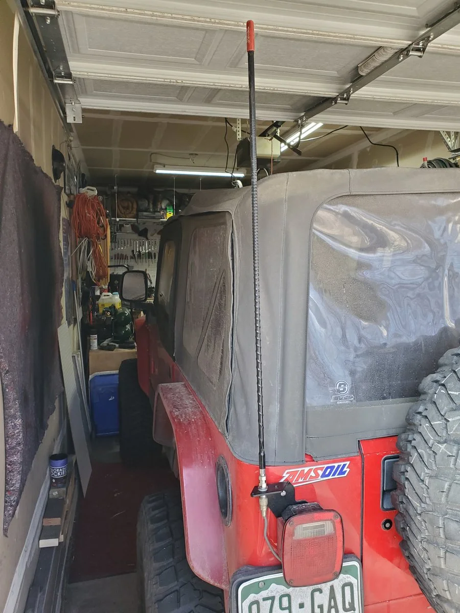

Well until I get my swr meter and route the coax to the other side, here's the the new 2' firestik and mount
Do you have an SWR or do you want to borrow one?
I have the same mount and haven’t routed my HAM yet. The antenna is sitting there but decided I’ll probably route it up front so it has a better ground plane off the hood (and my antenna is an NMO or SO-239, both are larger than the holes in that mount).
I've got one coming, hoping today. My previous one was stolen a few years back.

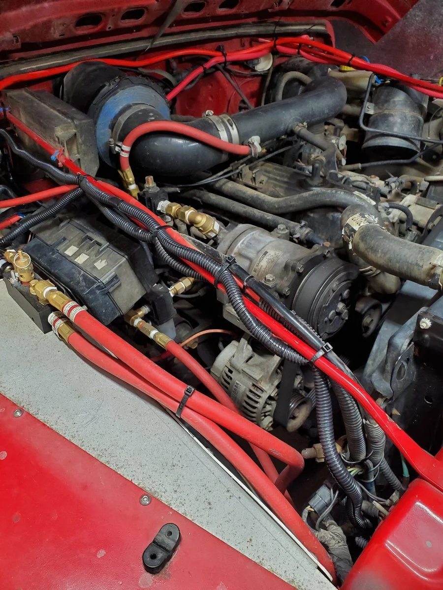

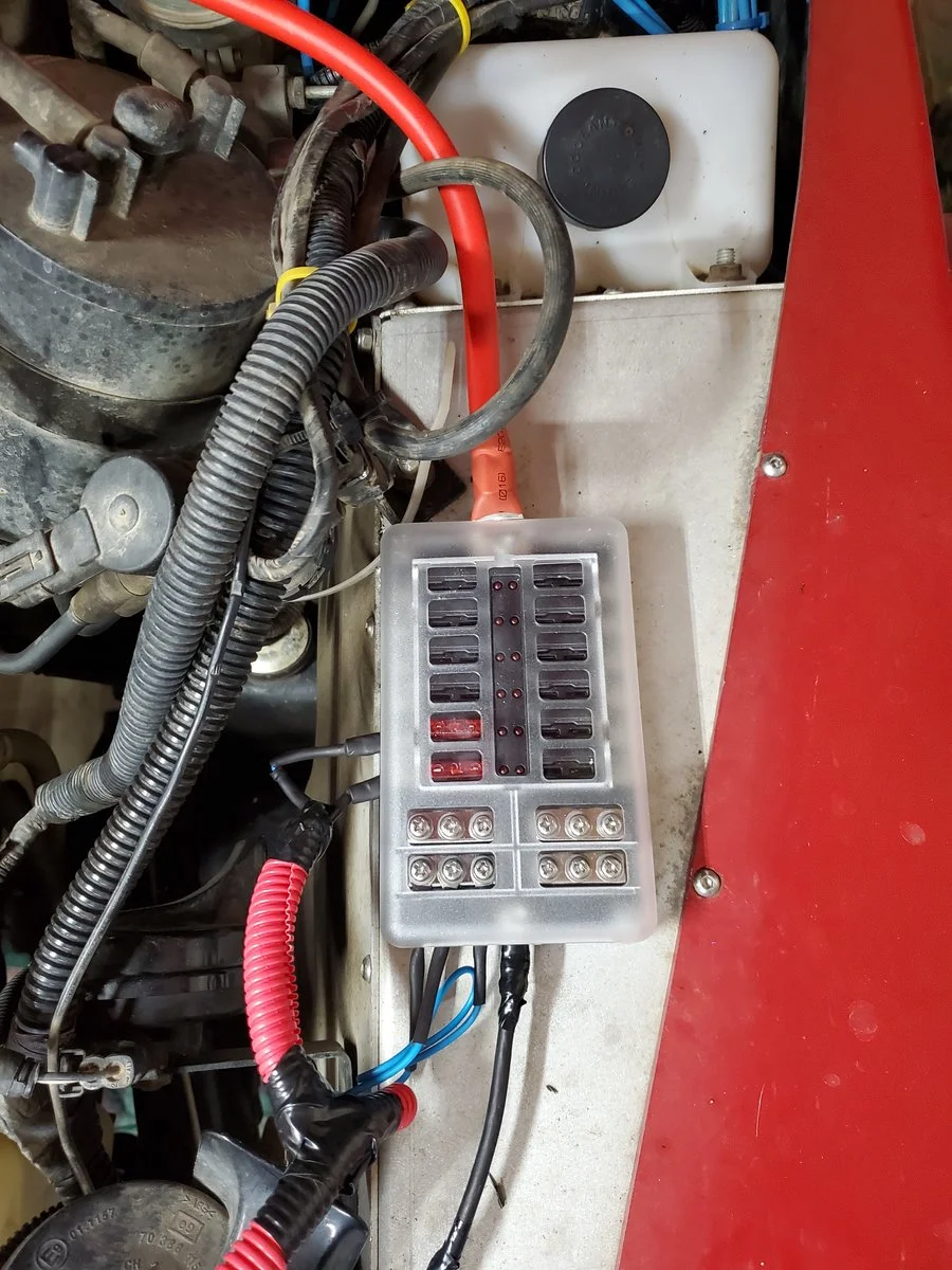

I didn't get everything done that I wanted to, but the seat heaters are rewired to the new distribution block and appear to be working again. I want to run the power from the rearview to it still. 2 ga. wire is powering the block since it is capable of 100 amps for anything in the future

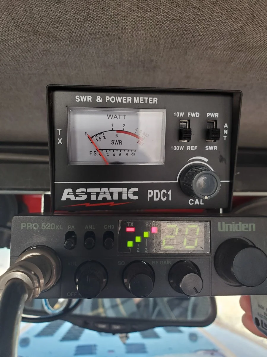

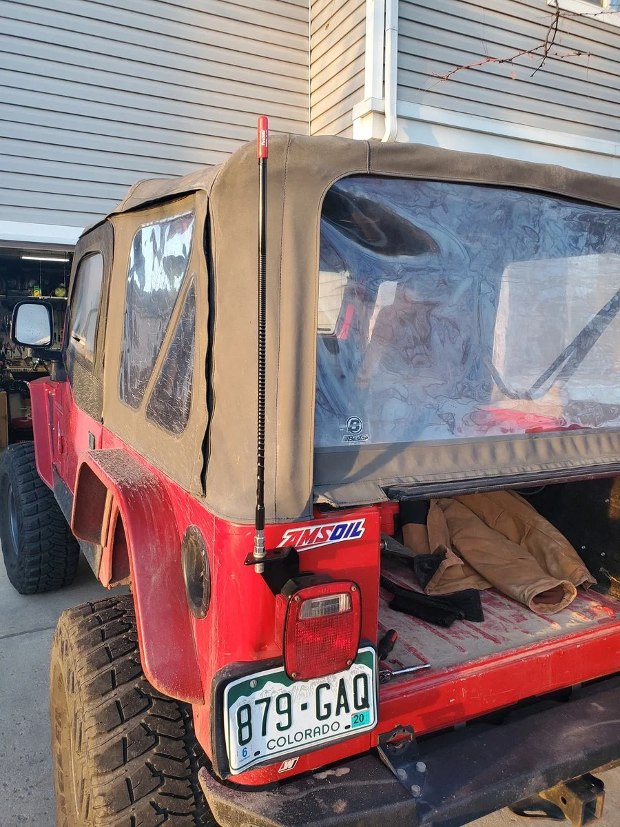

My CB was having a hard time receiving and sending. I pulled out my SWR meter again and the SWR was sky high. Long story short, the needle jumps like crazy with a little bit of movement of the box. I think its a faulty meter. I borrowed an SWR meter from a neighbor (also a TJ owner) and tried that. With the 2' firestick, proper grounds and proper isolation on the mount, my SWR wouldnt tune below 2.5. I put on my old 3' firestik and was able to get 1.6 on channel 1, 1.1 on channel 20, and 1.6 on channel 40. I would like it a bit lower (both SWR and the antenna), but for now I should be fine.
