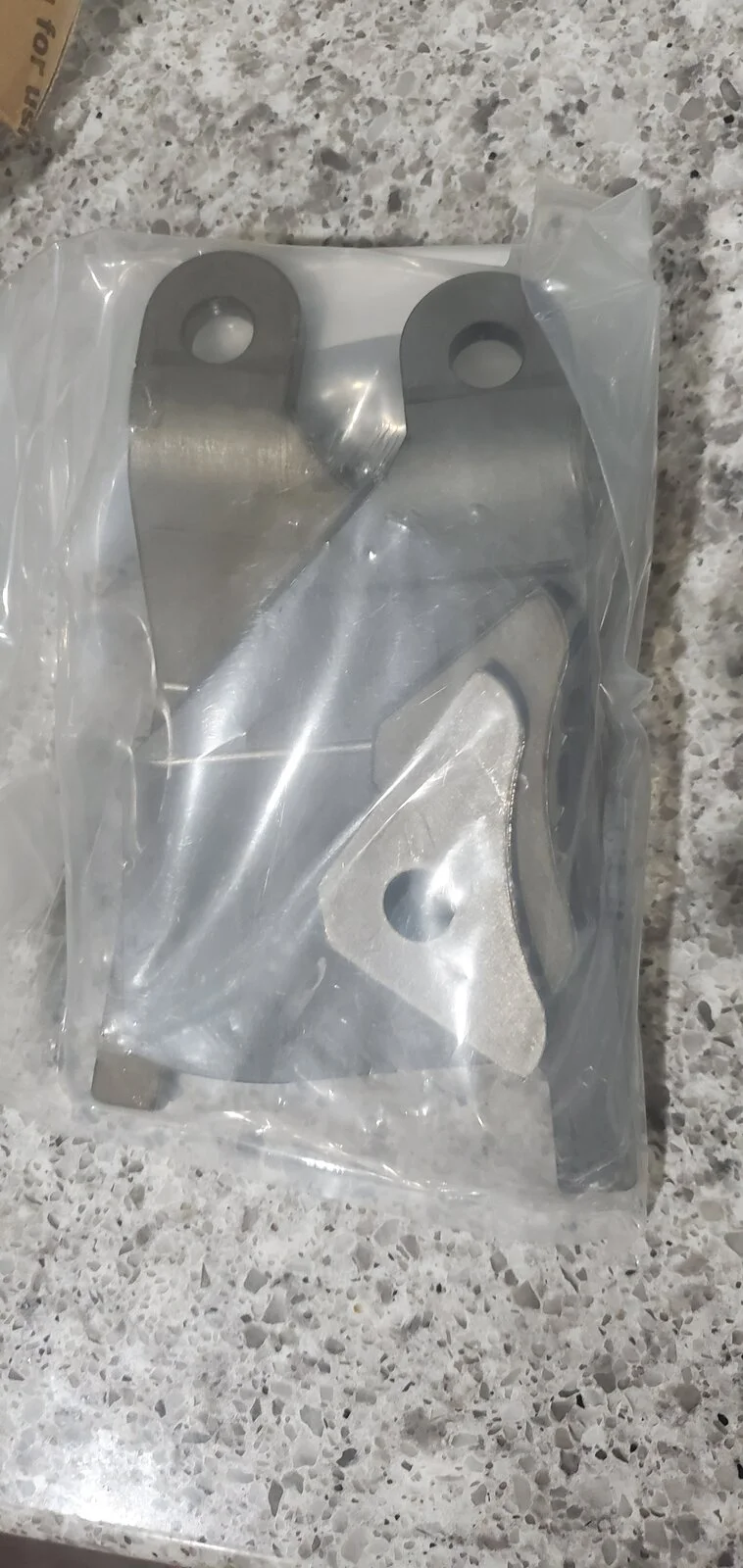

The artec sway bar brackets need to go. Replacing with the BMB brackets.
Also have disc brakes coming in near future so the reverse brake cables were in order

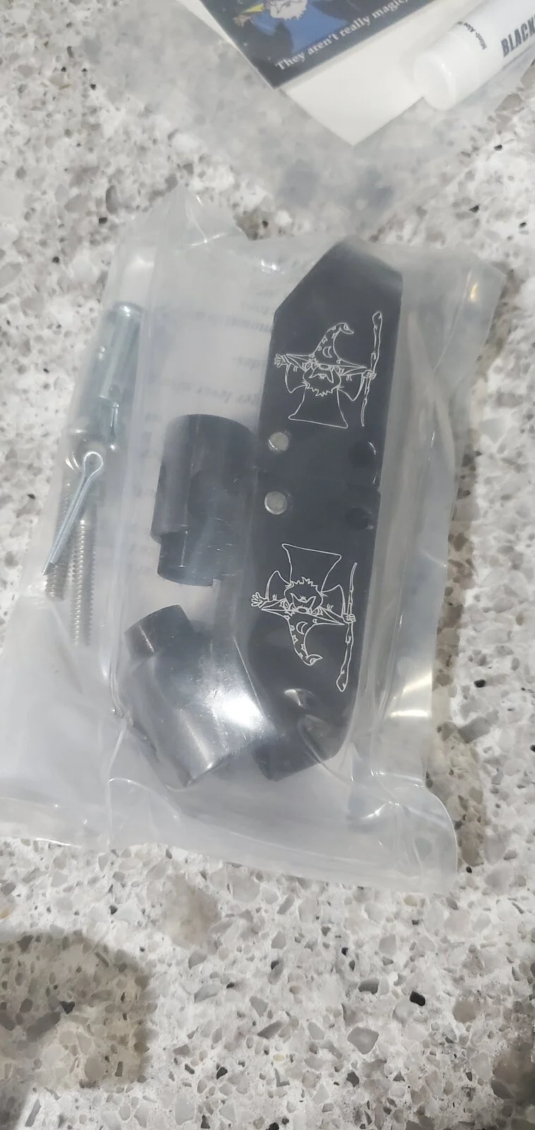

Also got the elusive BMB sticker to add to my collection
Finally, my replacement rocker plate came for the front locker. The little side tabs have broken twice now. OTRTTW sells them for about $4
I have these sitting on my bench too, seems like a good offseason project!
We did some close looking the last time we were at BFH garage--The currie tie rod would contact the artec brackets quite a bit if flipped. Also looking at losing the 1/4" CA skids due to their arm placement. Looking back--I should have kept the original spring perches on the hpd30 and just reworked the arm mounts and sway links

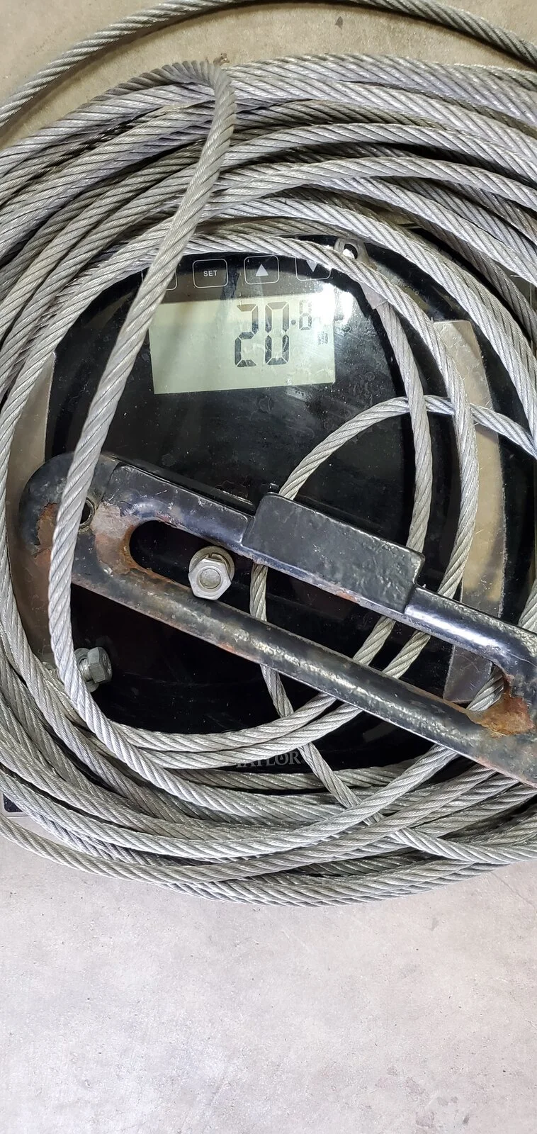

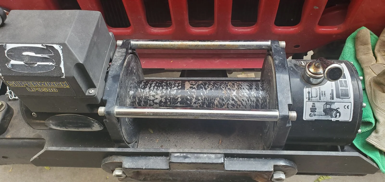

Before. 21 lbs ( I thought sure it was heavier)
Cleaned up the drum. I didn't feel any burrs so I just wiped it down

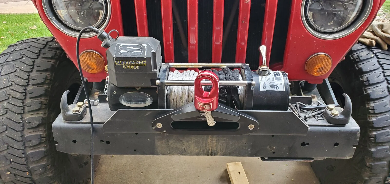

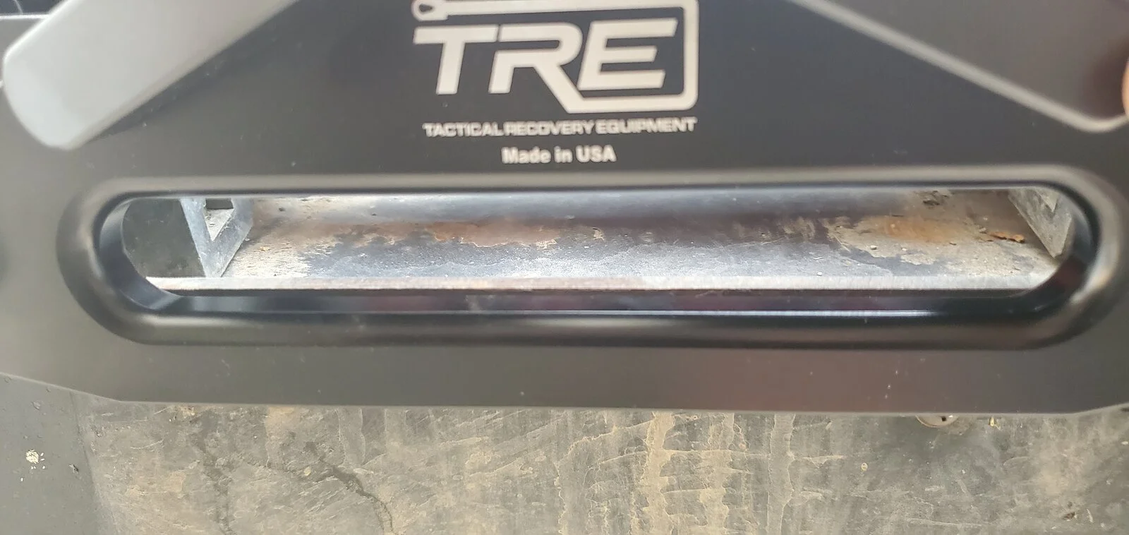

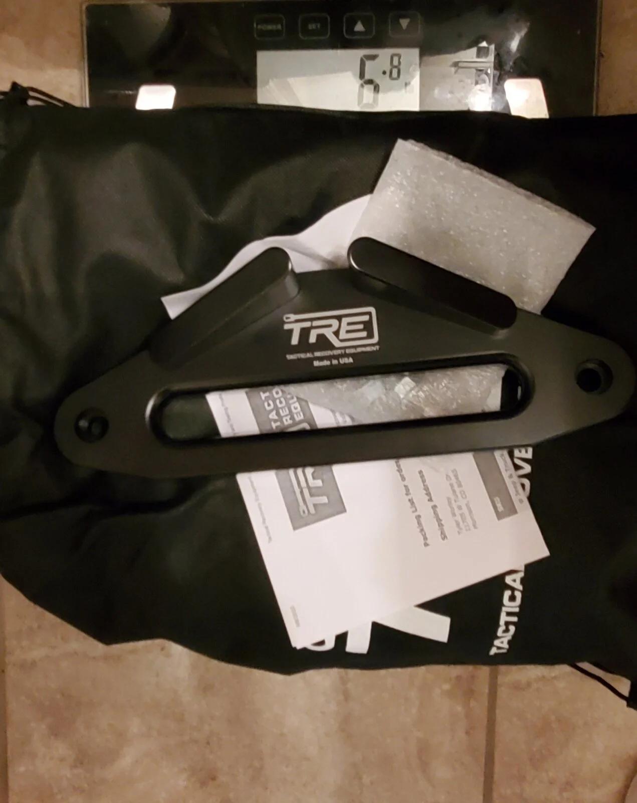

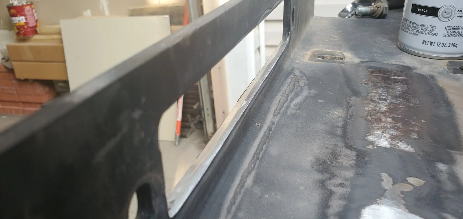

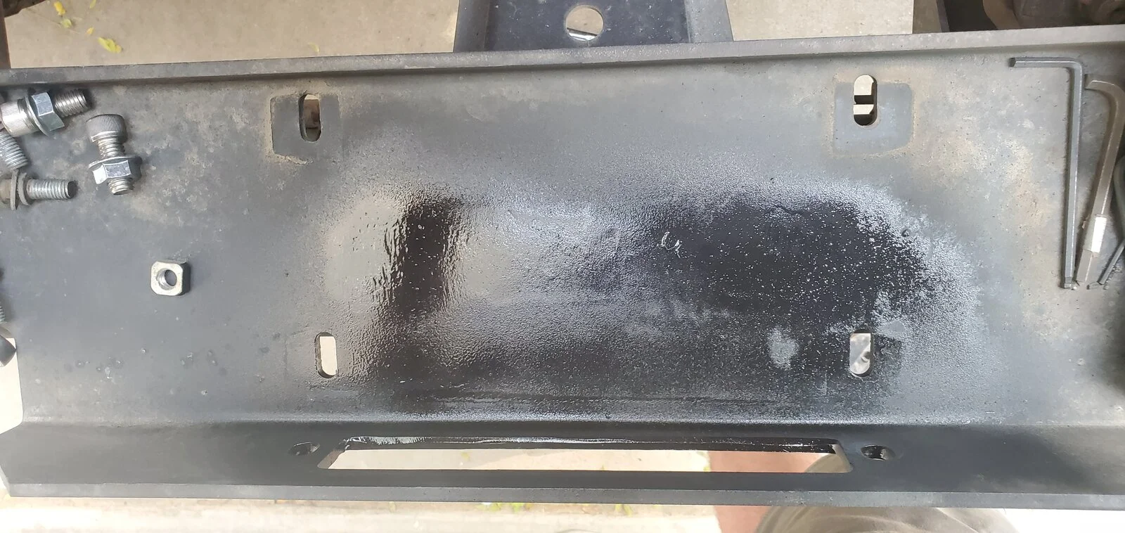

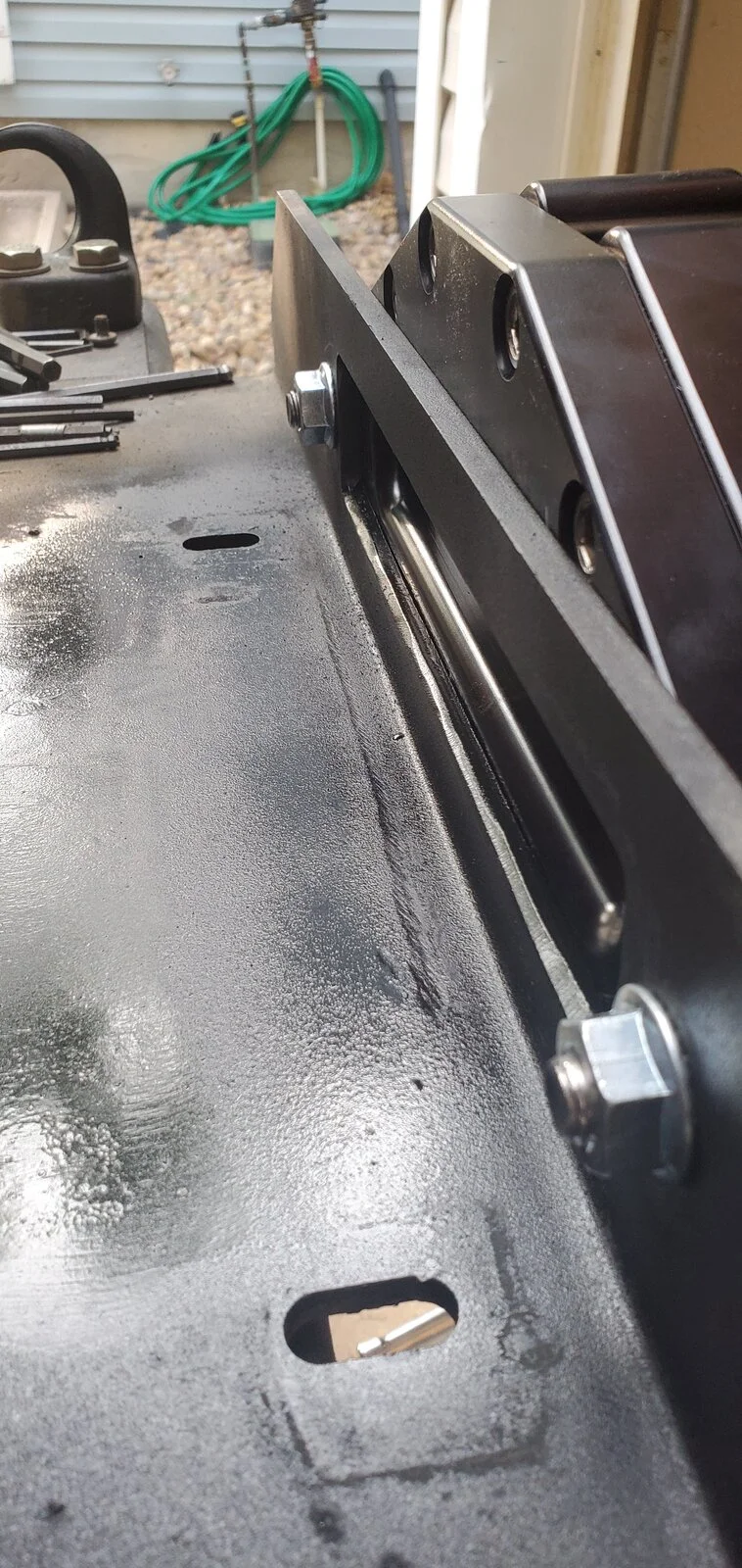

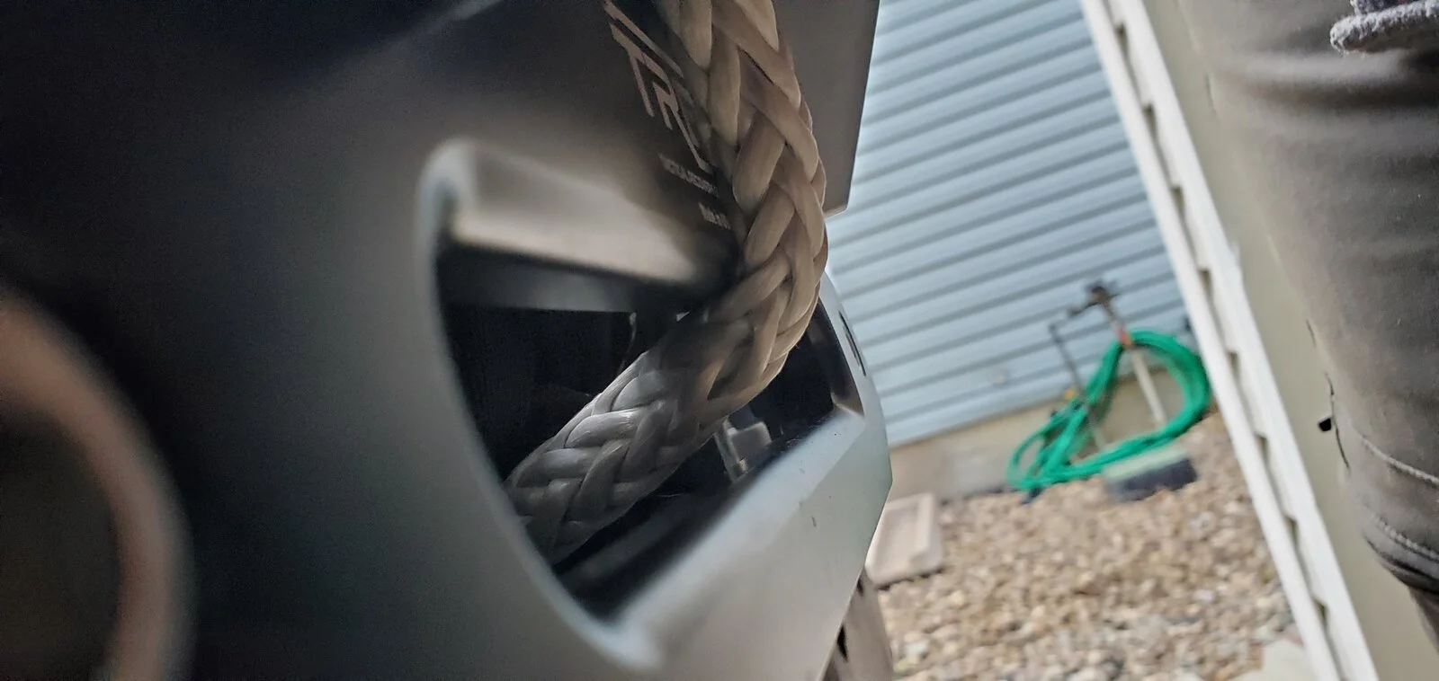

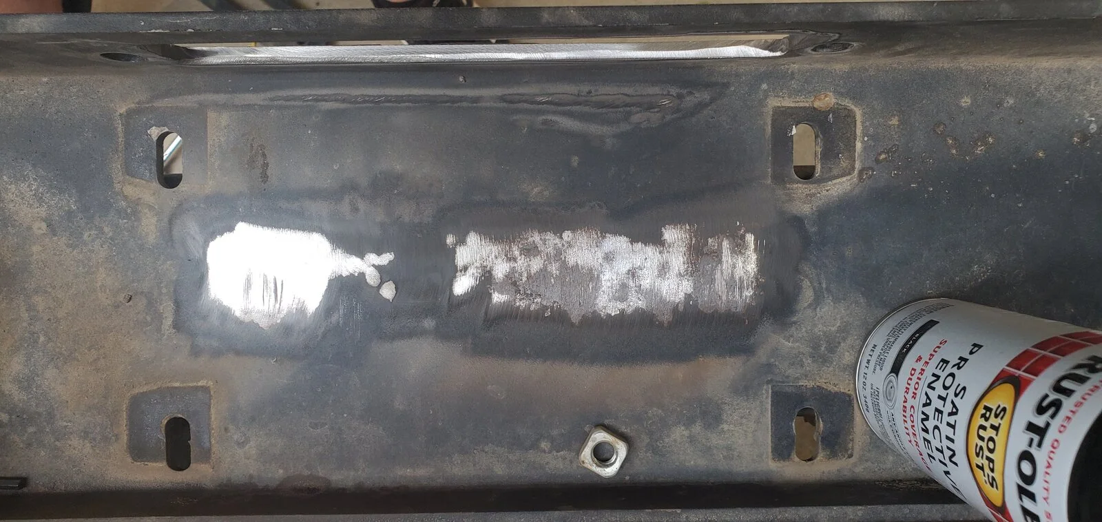

Checked the clearance of my winch mount and fairlead. It was flush with the new TRE fairlead. Some work with a flap disc made it bigger plus rounded the edge
Also cleaned up a little rust
And finally wound up the new synthetic line and safety Thimble! Checked clearances and it appears to all be riding on the fairlead. The black sleeve will be removed soon

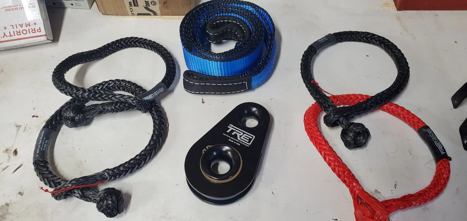

Working on my recovery gear. New 3"x8' tree strap, three additional soft shackles, and new snatch block
I’ve never seen a soft shackle in action. How do they work, as far as what keeps the knot end from popping out of the loop? What is that little strand of red thread for.

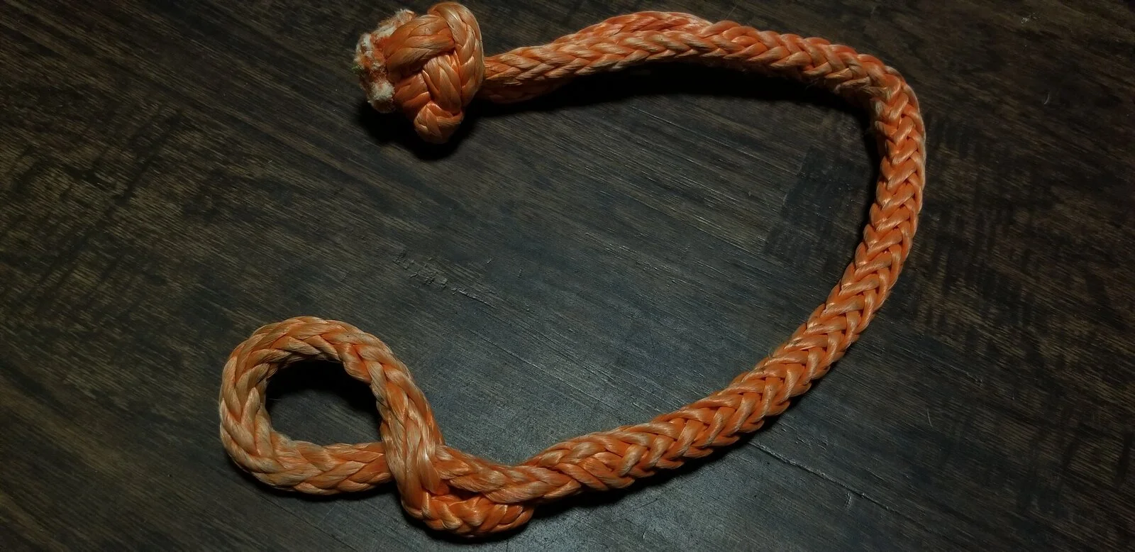

The tension tightens the loop around the knot, the red string is a nicer way to pull the loop loose again. One important thing is the load direction (similar to a d-ring) - on the soft shackle I think they’re supposed to be perpendicular to the knot (which isn’t hard since it forms to the direction it’s pulled).
The shackle stays closed the same way @tworley's coat stays closed. The big knot is just a toggle.
Trying to imagine this in my head. I may need to see if I can find a video.
Thanks.
Reactions: MountaineerTom
Just buy a soft shackle, it’s worth it
Soft everything is worth it. I remember winching with steel shackles, steel cable with a hook, a tree saver, and an ARB rope cover thing (which has questionable function). With a safety thimble and a soft tree saver or a soft shackle when connecting to another vehicle, all I need to do it pull the cable out, put on a singular connection and pull in. Everything is a lot lighter, simpler, and safer. Love it.

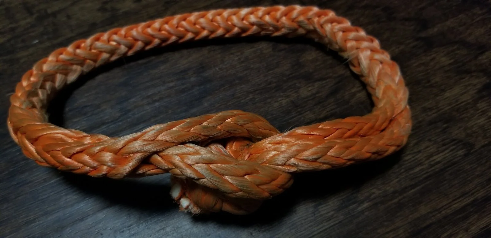

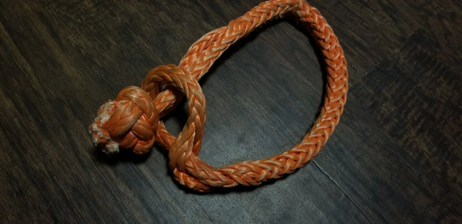

It isn't necessary for the noose to tighten. having used mine fairly often, i can say that it doesn;t get very tight even after a hard pull.
A picture better explains what I'm was trying to say. This I what mine look like when I use them. The loop basically locks underneath the knot.

#1 that is correct.

I keep the knot in the middle of the loop while pulling (just like the photo). Lots people seem so take a Dremel to their bumper to knock off any hard edges and dump the metal shackles.
