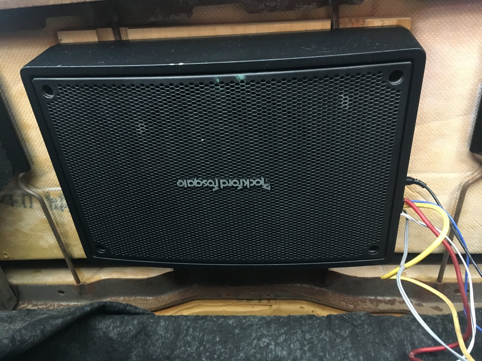

You may not be interested in this rear seat mount, but I like showing off and I’m almost as much of a picture whore as @bobthetj03.

So that's mounted under your rear seat? How does it sound? not a ton of room there.. but if I were to get any sort of sub that would be it. No room to sacrifice!

It sounds awesome. I've had bigger systems in the past, mainly in the 80's and 90's when I ran 8's (Orion's) and 10's (Kicker) in MDF homemade boxes with external amps and Alpine head units. For the TJ I didn't want to go that big (space is a major issue!), but I did want good, clean and full range sound. The self-powered subs were right up my alley and since I have to use my rear seat, removing it was not an option. Nor did I want to drill into my tub. So the underside of the rear seat was the only other option I could think of (It won't fit under the front seat). By doing it this way I didn't have to sacrifice any useable space. I've had it since Jan 2017 and every day I turn it on I think, this sounds awesome! Why doesn't everyone do this? The head unit, replacement speakers and sub all cost <$450. Well worth every penny.

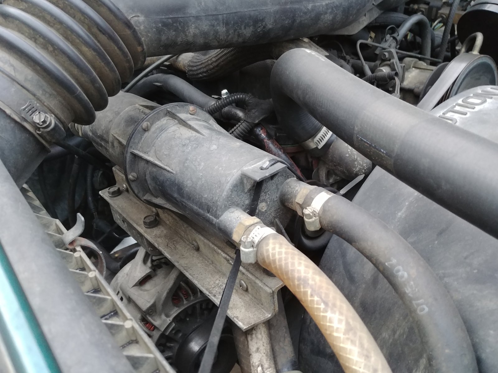

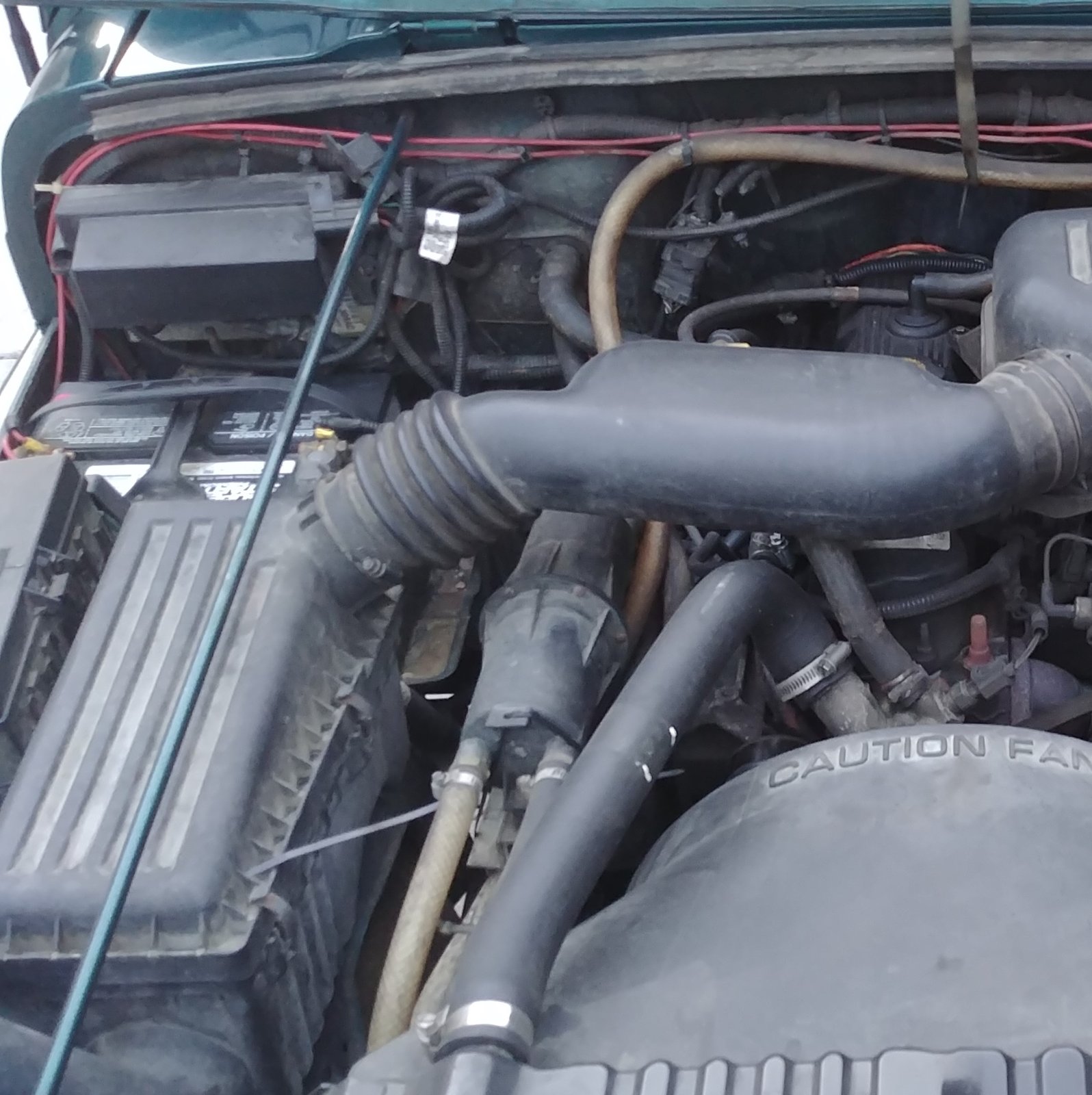

Finally took some pics of the onboard Jeep shower. You can see the heat exchanger mounted just to the right of the air filter box, right above the alternator. I don't have AC so I mounted it to the engine where that usually goes. The pump is in the back drivers side corner of the engine compartment on a small shelf, opposite the battery. I didn't take a picture of it, but it's your standard RV/marine fresh water pump.

Here's a shot of the heat exchanger from the front. The heater line and fresh water input are on the back, and you can see the outputs here.

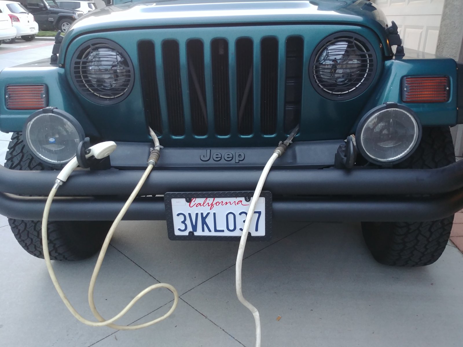

The intake and output hoses feed through the grill. I have quick disconnects on the hoses so they tuck behind the grill when not in use. It uses a basic camper shower head with an on/off switch to control the flow.
how hot does it get?
Almost too hot, really. Think of how hot the heater blows when it's on high and fully up to temperature. That's what is getting transferred to the water in the exchanger. It's been a while since I've used it (haven't gone camping in a few years) but as I remember you wouldn't want to stand under it for too long.
