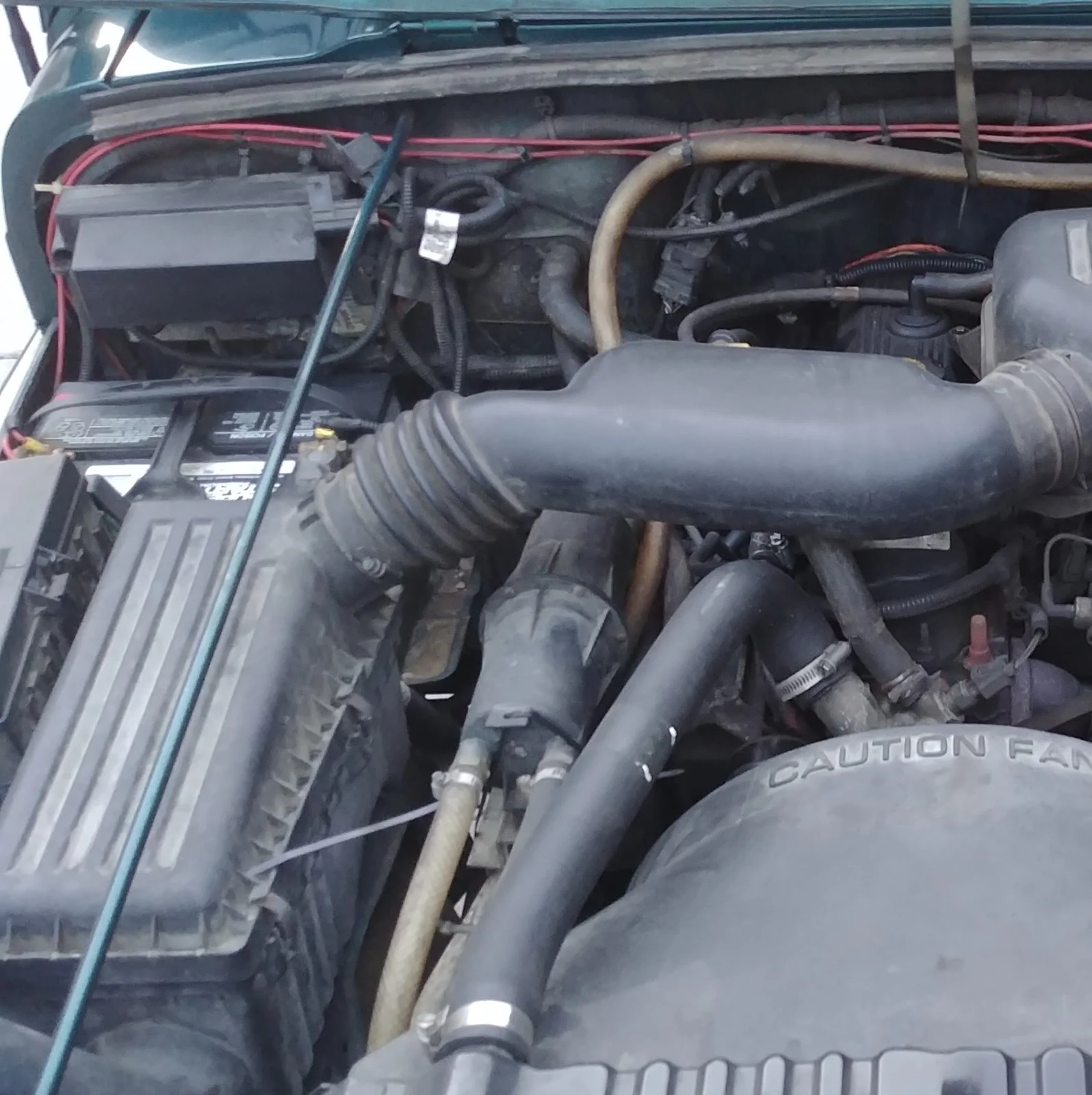

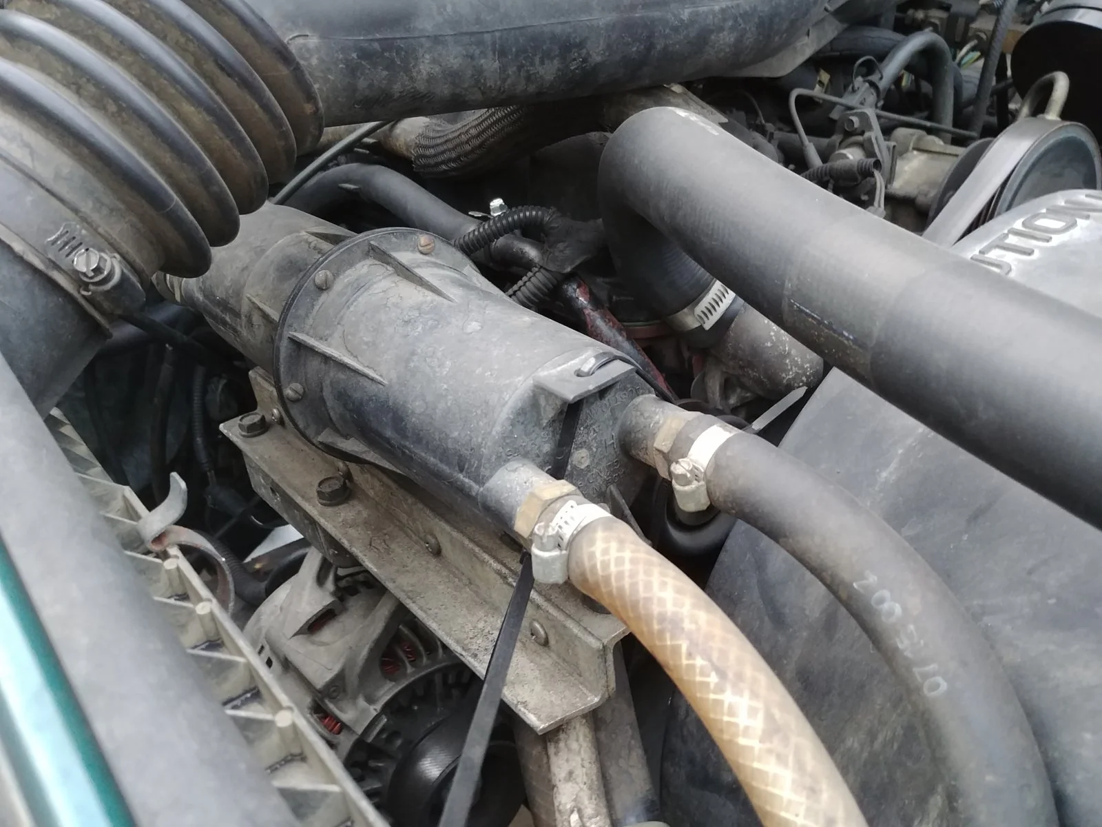

Finally took some pics of the onboard Jeep shower. You can see the heat exchanger mounted just to the right of the air filter box, right above the alternator. I don't have AC so I mounted it to the engine where that usually goes. The pump is in the back drivers side corner of the engine compartment on a small shelf, opposite the battery. I didn't take a picture of it, but it's your standard RV/marine fresh water pump.
Here's a shot of the heat exchanger from the front. The heater line and fresh water input are on the back, and you can see the outputs here.

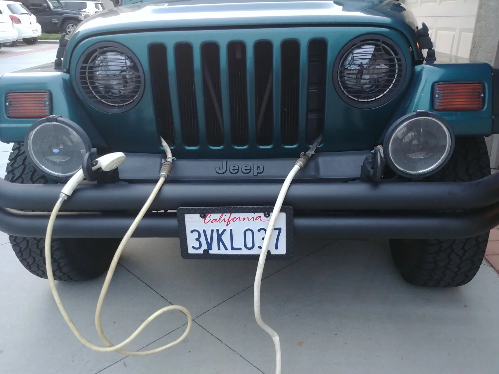

The intake and output hoses feed through the grill. I have quick disconnects on the hoses so they tuck behind the grill when not in use. It uses a basic camper shower head with an on/off switch to control the flow.
