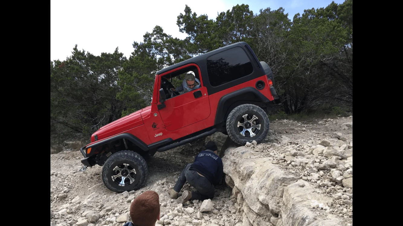

Was leaking a little oil, I think from the drain plug, due to the awful ledge, see pics in post #1^^^. The rubber washer was torn, so I replaced the plug and will see if it solves it. Leak was so slow I don’t have drips in the garage, gauge reads normal and dipstick says full.
If this doesn’t stop it, I’ll look into fixing the oil pan. Anyone ever removed the oil pan and beat out a section? I’m only concerned right where the drain plug is, it’s not 100% flat, so on one side it’s bent toward the plug, creating a small concave shape.
