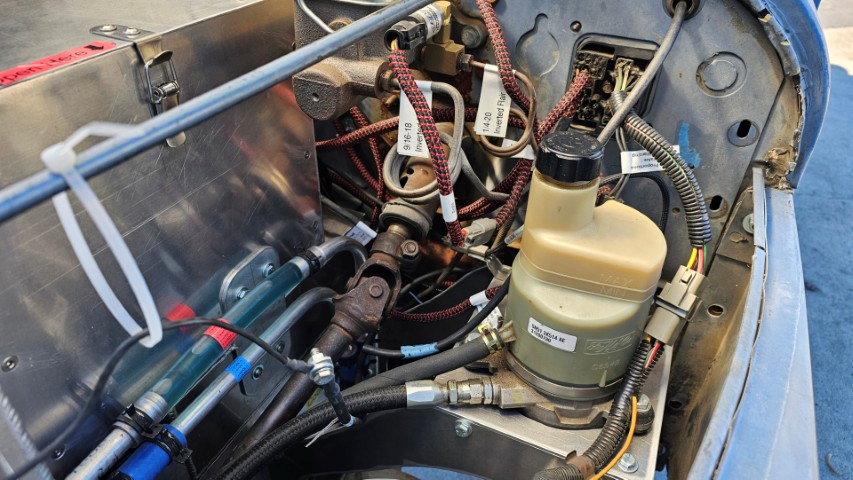

The Volvo P/S unit is available on ebay for around $300. It's almost plug and play. Did I mention it's made by Fo-Mo-Co, they've had a very long relationship apparently, who knew...
Anyway, yes, you need to braze the stock nuckly plumbing to two new connectors for the pump, add a 60amp fuse and a 1 wire Enable switch that can be attached to a relay to your key-ON switch. Honestly, it'll take you longer to rig up the mounting bracket and remove all the stock P/S stuff on the motor then it will to hook the 'new' P/S pump up.
The reason it's such a good swap candidate is it's a self contained unit - the pump and reservoir are in the same unit. You get an immediate ~12-18% hp added back to the ICE motor from the vane pump being removed.
Here's one that's on our demo CJ:
Yes, we love our label maker....
