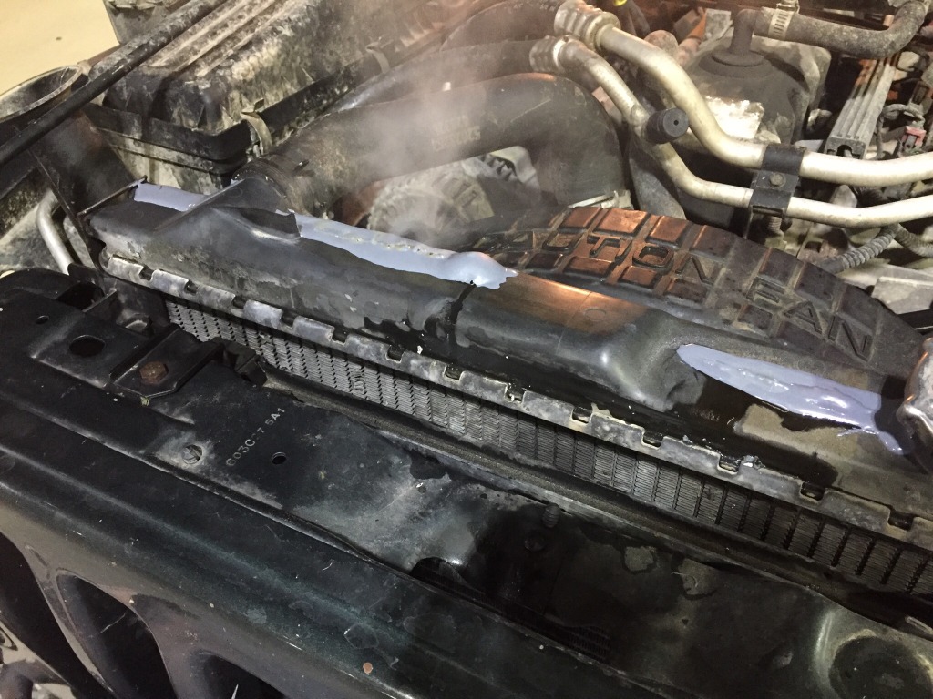

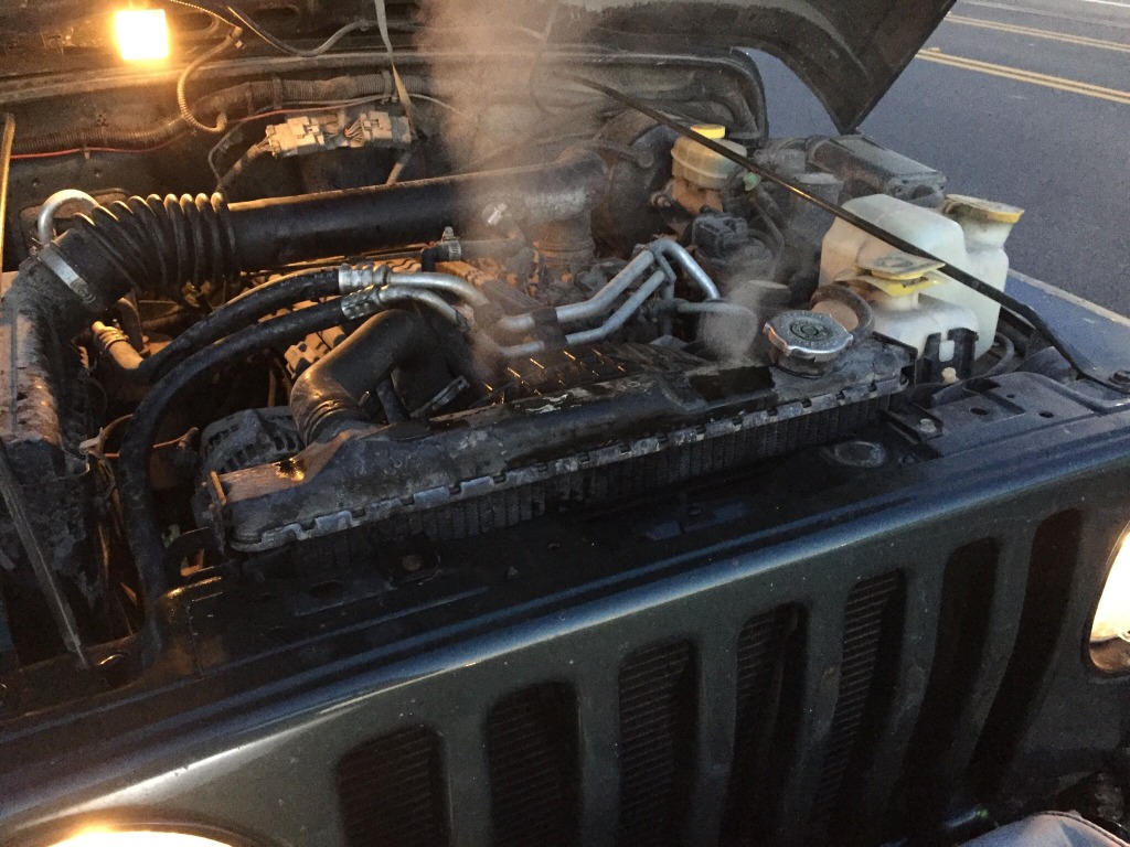

This happened tonight; absolutely hilarious in my opinion because two months ago I was worried about those cracks in the top of my radiator:

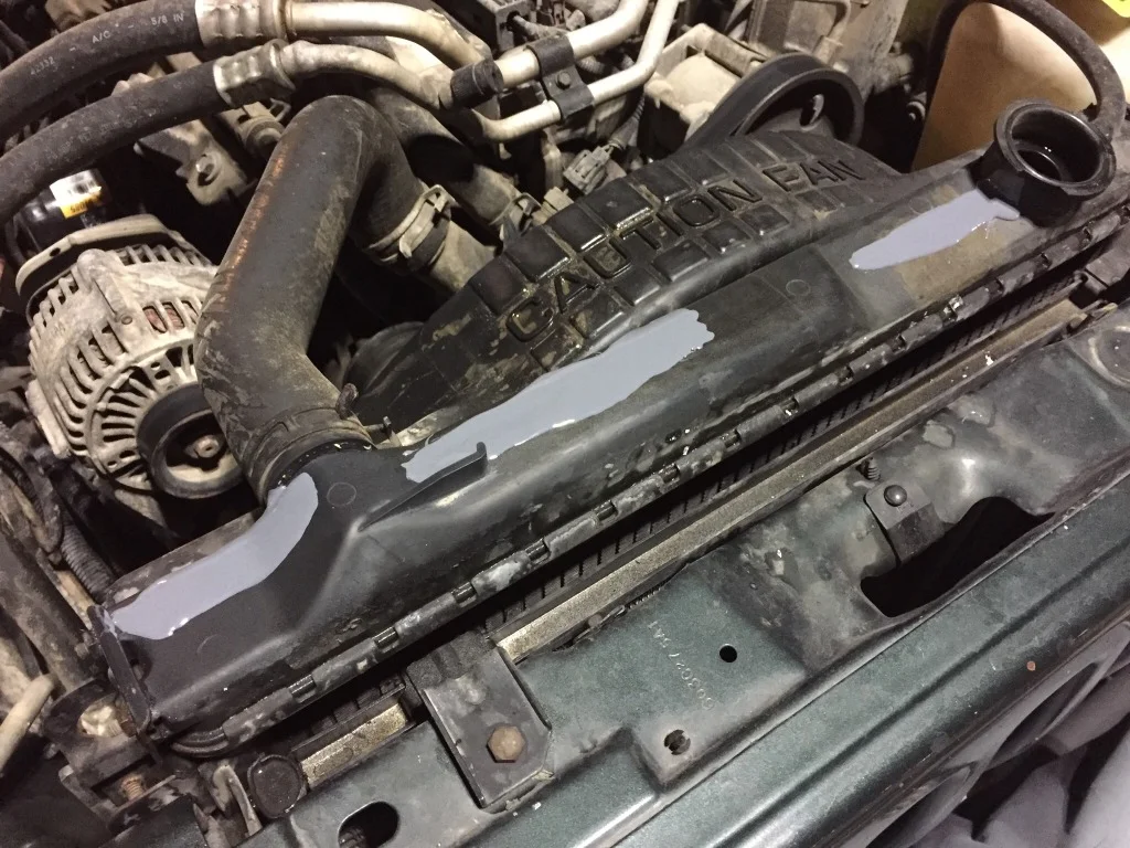

Loctite weld from Kroger:

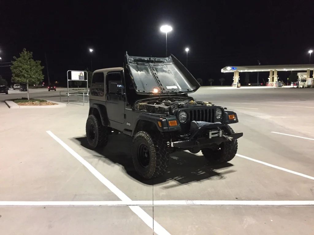

Kroger parking lot:
This happened tonight; absolutely hilarious in my opinion because two months ago I was worried about those cracks in the top of my radiator:View attachment 17023
Kroger parking lot:
At least it was in a well lit place...happened to me on a dark country road.(and we all know how bright the under bonnet lights are) lol
Well done on a great repair job too.
Oh man that's gotta suck! What did you do to fix it?
And thanks! His names escapes me, but I got the idea from another forum member!
I saw I would be needing a new radiator at some stage and had some cracks like you did.... So I bought a tube of Selleys Autofix –Knead it. It’s like a play-doe type of thing you mix in your hand with a hardener. It was a long wait in darkness while it cooled down enough to work on. Lol... It got me home and to work for about a week until I had to buy a new Radiator.
I always make sure I have my torch in the glove box now though :p

Well at least it worked for a week! :D yea man get one of these. Work great for those occasions.

Maybe I should have roughed up the plastic with some sandpaper first, or waited for hours instead of 30 minutes before I started to head home:
Maybe I should have roughed up the plastic with some sandpaper first, or waited for hours instead of 30 minutes before I started to head home:View attachment 17039
Haha, yep... You probably should have.
Time for a new radiator, that's for sure.
