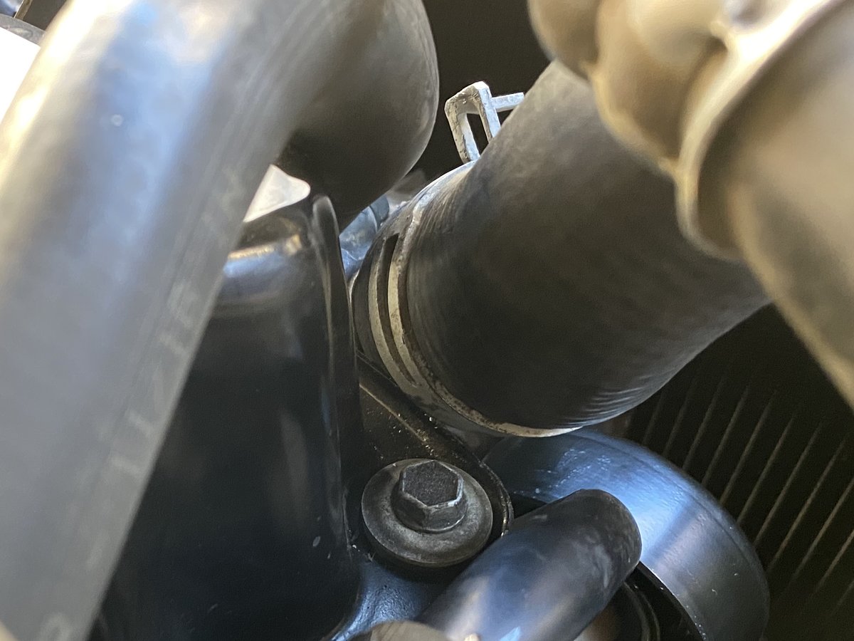

Drove it around this morning and everything looks good. Only one very small leak coming from where the upper radiator hose connects to the tstat housing.
This is a new hose, and I noticed it was about a half inch longer than the old hose. I had trouble with this clamp because the rear side was hitting the cylinder head cover.
I think I may have the clamp a little crooked.
But maybe these clamps just need some time to “sink in” with the new hose?
Let me know if anybody has any tips or tricks for dealing with this clamp hitting the cover with a new hose.
I can’t tell from the pic, but did you slide the hose all the way over that ridge on the front of the t-stat housing and clamp it below the ridge?
It’s my understanding that the hose only goes down to the first ridge with your clamp being placed between the ridge and the end of the t-stat housing.
Reactions: khakitj
Thanks. I’ll check it out when I’m back home, I’m out of town right now. The hose is over the ridge but I think the clamp is straddling the ridge and that’s part of the issue.
I might just put the original hose back on to see how it was fit. It’s actually in decent shape still so I might just leave it on.

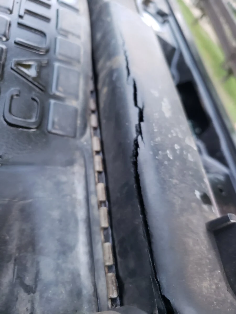

My radiator just cracked last night and I purchased a warranty on my 99 jeep wrangler sport last year when I bought it. Should I have it replaced with my warranty or do the work myself? I enjoy working on my jeep but I seem to be having trouble finding a mopar radiator. I used the links provided but it says the radiator won't fit my jeep. Thanks guys! I attached a photo of my radiator too.
I found mine on Rockauto and it was about $50 cheaper than Amazon.
