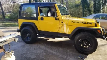

Big difference in the looks of that front end! I like itPut on some Trucklite knock-off's I got from a forum member on and installed some tube fenders I found on CL:
Thanks dude. I feel like it looks even better from more of a distance.Big difference in the looks of that front end! I like it
Looks great!Thanks dude. I feel like it looks even better from more of a distance.

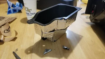

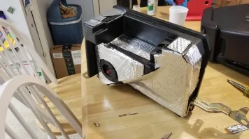

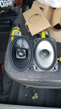

Today I finished up what I ran out of daylight on yesterday. The factory subwoofer box between the seats has been previously upgraded to the Kicker 6.5 & the Kicker 200.1 Amp. On certain bass frequencies, the tray that holds junk in the center console would rattle. My solution, cover it in sound deadening material. I also put some on the inside of the center console on the passenger side (away from the direction of the sub speaker.) The result is a much tighter base, with less rattling noises.
View attachment 135596View attachment 135598View attachment 135597
