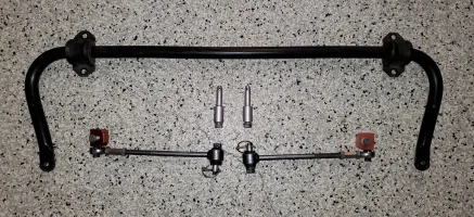

Factory Front Anti-Sway Bar with Disconnects
When I purchased my LJ it was already lifted with “metric 35” tires and utilized the factory front anti-sway bar with a set of Rubicon Express “Gen 2” quick disconnects to allow more articulation off road. The ride was solid on the highway with minimal body roll, and the disconnects worked like any other brand quick disconnect to allow more articulation offroad at the expense of body roll control. The worst feature of these is trying to reconnect for the drive home on the highway which often involves searching for a flat piece of ground and lying under the jeep in the muck with a pry bar and mallet to get the pieces aligned. The balancing positive feature is that quick disconnects are cheap.
In my case the negatives of reconnecting outweighed the positive of being a cheap way to improve articulation so after my second or third trip in my new to me LJ I resolved to get rid of the disconnects and upgrade from the factory anti-sway bar to the Currie/Rockjock Antirock Off-Road Sway Bar, P/N CE-9900, which was regularly hyped on the various Internet jeep forums as the next best thing since sliced bread.

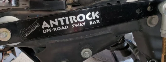

Although the bars are now forged and the newest version has 3 adjustment holes on each side rather than 5, the Currie Antirock and Rockjock Antirock are functionally identical and share the same part number for the TJ. The name change primarily reflects corporate reorganization by the Currie family.
The Currie Antirock is a front anti-sway bar specifically designed for offroad driving. It works in conjunction with the rear anti-sway bar keeping both front and rear bars connected to evenly distribute forces between the front and rear axles aiding traction by keeping the weight on the tires. While much softer than the factory front anti-sway bar, the Antirock still helps control body sway and lean when off road making side slopes and off-camber situations less treacherous to negotiate.
There is one school of thought that advocates running the Antirock in the stiffest position that does not limit the desired articulation. [ @jjvw is from this school.] This practice results in a compromise position that still fully articulates while reducing body roll on the street as much as possible considering the limitations of the design. In my case, setting the arms at the recommended 10* angle from horizonal and putting end links in the middle position provided “okay” highway manners and full compression offroad without interference between the arms and the inner fenders. Moving the end links rearward to the 4th or 5th position would have resulted in undesirable although still manageable body roll on the street and potential interference between the arms and the inner fenders off road. The latter could have been remedied with shorter end links making the bars more horizontal on level ground, but there was really no benefit from doing because I already had all the articulation my tires and fenders would allow at the middle position.
There is another school of thought that the end links should always be set in the rearmost position allowing maximum articulation and that the resulting highway manners will still be “good enough.” [ @Jerry Bransford is apparently from this school.] The descriptor most often used is that the highway ride is “fine” or that the writer “regularly drives on twisty roads” with no issues. Such rationalizations may work for a rig that is seldom driven on the street or only to the trailhead and home, but it is less than optimum for a jeep that is driven long distances or is used as a daily driver. It is respectfully submitted that “good enough” is not synonymous with “good,” and “fine” is not the same as “the best it can be.” The Antirock is excellent at what it is intended to be, an “Off-Road Swaybar, but it is not so good at being an on-road anti-sway bar.

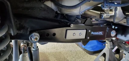

SwayLOC Dual Rate Anti Swaybar System
SwayLOC.jpgSwayLOC Installed Driver Side wide view.jpgLatching Arm.jpgSwayLOC passenger side.jpg
A cursory Internet search will reveal that Blaine Johnson (aka @mrblaine) was involved in the initial design of the SwayLOC and that the product was first brought to market in or around 2005. Further reading suggests that the business relationship between Mr. Johnson and the licensee of the design didn’t work out as planned and that Off Road Only had customer service issues related to ongoing changes/improvements in the product during the first few years after release. However, that same search will reveal that despite those issues, and despite the business relationship that hasn’t worked out as planned, Blaine Johnson still believes in the design and regularly purchases and uses the ORO SwayLOC in his jeep builds. In fact, it was Blaine Johnson who commented that my first reaction after installing a SwayLOC would be to wonder why I had waited so long to buy one and it was Blaine who was instrumental in a SwayLOC arriving at my doorstep.
From the SwayLOC installation instructions:
“SwayLOC is a dual rate anti-sway bar system that allows the operator an easy method of changing from on-road rate to off-road rate. The on-road rate is similar to the OEM anti-sway bar but allows a more compliant ride on highway. The SwayLOC will absorb some of the jarring that may be transmitted to the vehicle thru the OEM Anti-sway bar. The off road rate is unique in that the SwayLOC will allow full range of articulation on most vehicles, but will continue to provide resistance and will usually deliver a more balanced feel of the vehicle. This balanced feel is especially apparent when used with a rear antisway bar.”
My initial impression of the SwayLOC:
Handling on the road is even better than with the factory front anti-sway bar, handling and articulation off road is exactly the same as with an Antirock Off-Road Swaybar, and switching between the two is quick and effortless. In short, “Why the hell did I wait so long to buy one?!??” It is the best of both worlds for only $200-250 more than just an Antirock. Thanks, @mrblaine.
The changeover to the Swayloc gave me the opportunity to experiment with the end link position and compare the difference is body roll in each position. As noted above, for a TJ/LJ regularly driven on the street the Antirock can and should be adjusted to the stiffest setting that still allows the desired articulation which in turn results in the best compromise position for both on highway and offroad use. However, with the SwayLOC’s outer torsion tube connected it is not necessary to find a compromise position and one can run in the loosest offroad setting and simply flip a lever for highway use. Blaine suggested using the rearmost hole for the end links rather than the middle position I had used with the Antirock. I can report with certainty that having used the arms in the middle and end positions on the street with outer tube disconnected the difference in body roll between the two end link positions is substantial. I hated the feel on the road with the Antirock end links in the rearmost position, especially during cross winds on the Interstate at 70+ mph. but found body roll to be tolerable in mid position. It was the same with the SwayLOC, not unexpected because inner torsion bar is the same 0.75” diameter and the arm positions are within ½” of each other between Antirock and SwayLOC. The difference is that the SwayLOC does not require any compromises for operation both on pavement and offroad and is not just subjectively “fine” on the highway, it is objectively excellent with the outer torsion tube connected. Cross winds, buffeting and body roll are no longer issues of any degree.
