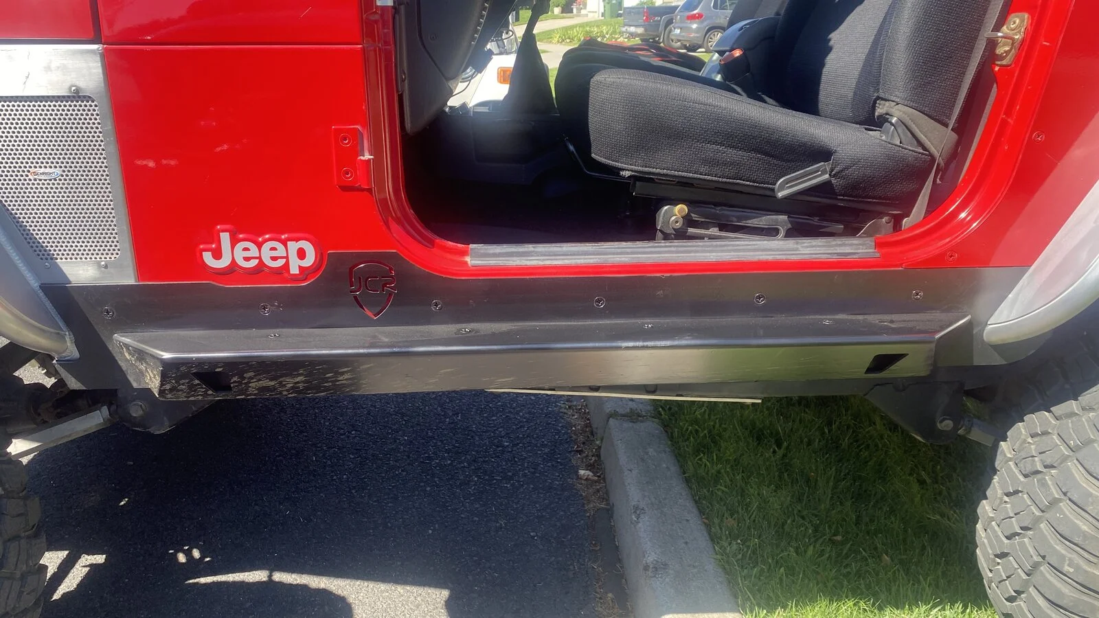

I finished countersinking the bolts on the slider backing and slider step and painting. I wanted the bolts to match the slider like the bolts match the corner armor, so I painted them satin black and dipped them in 2K clear. I also had to paint the countersink holes. I 2K cleared them too. Looks clean, inconspicuous, and will hopefully hold up better against rust than the button heads that kept damaging the paint.

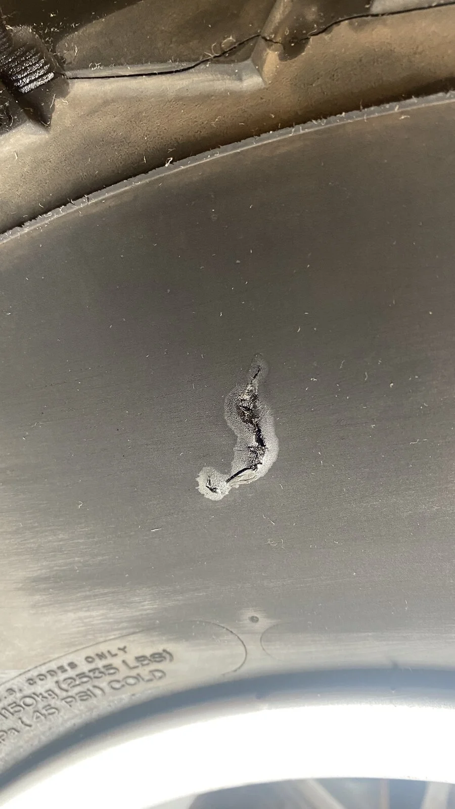

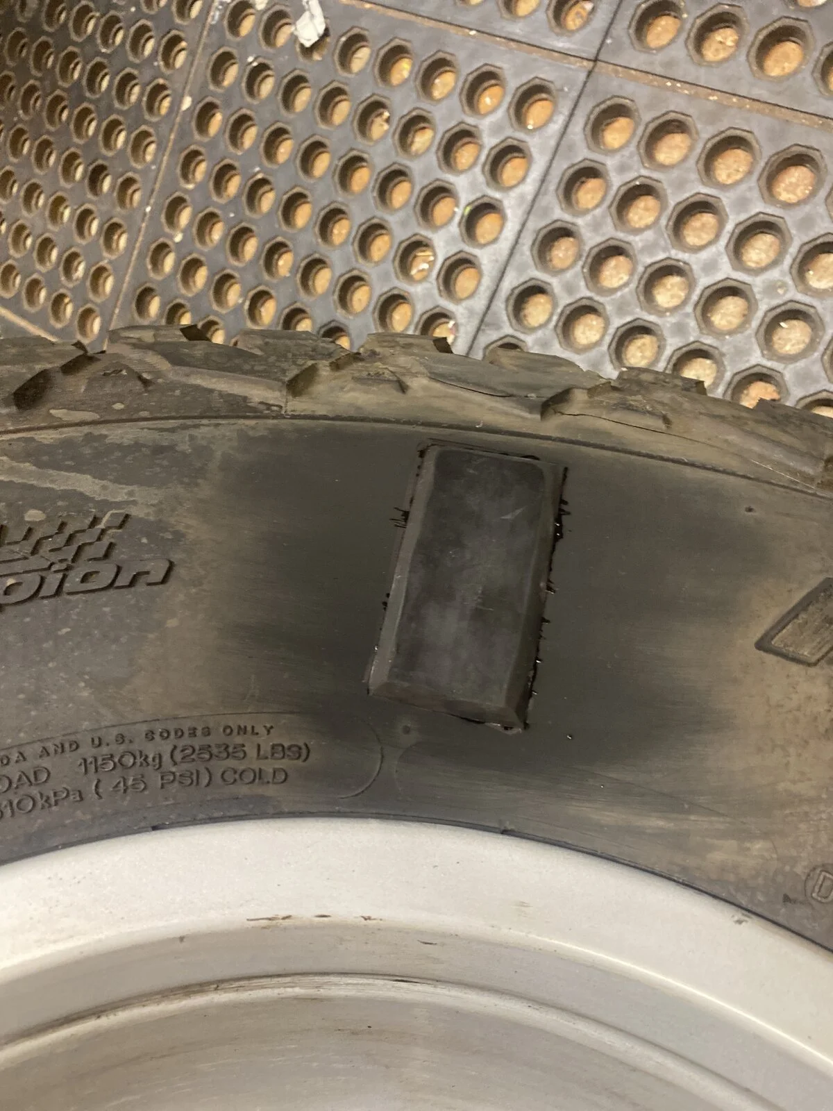

This one KM3 has had so many problems. It had a small sidewall tear that I patched just for precaution before Moab. Patch was coming off so I added some more glue today.

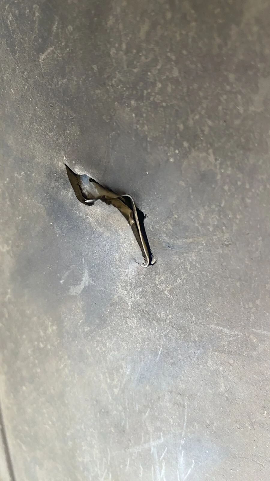

Then I had them balanced a couple weeks ago and they pointed out this inner sidewall compromise.

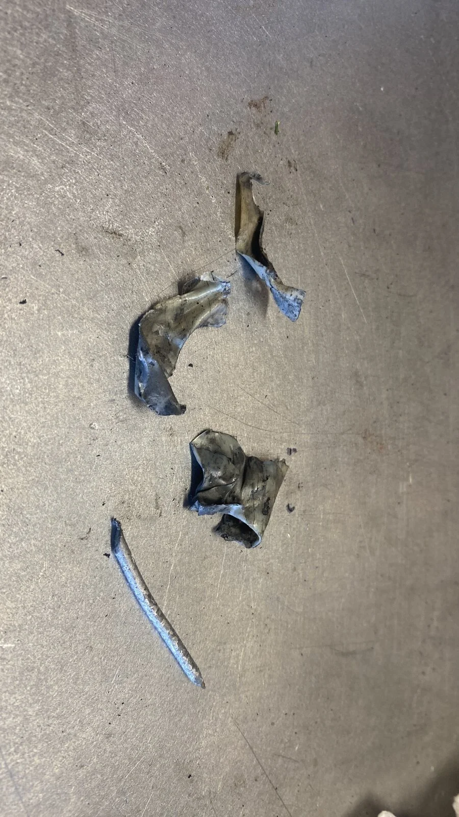

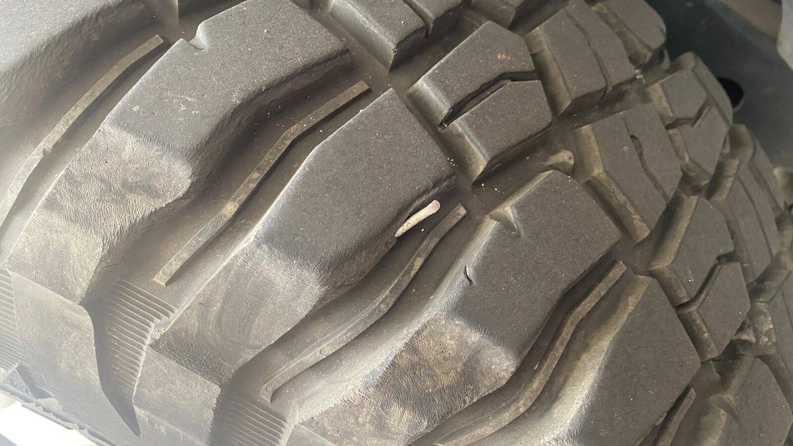

We didn’t pull it out for fear it would leak air. Then this morning I saw this nail.
I pulled the nail out and it had not gone all the way through, so that was good news. Then I pulled the material out of the inner sidewall. It’s some kind of plastic, but malleable. Strange.
Followed the directions on my GlueTread to patch the inner sidewall. Clean, glue edges, clean, sand, clean, then glue the patch on.
I could have used the accelerator, but I’ll just wait an hour since I’m in no hurry. Then I’ll air it back up and keep going.
