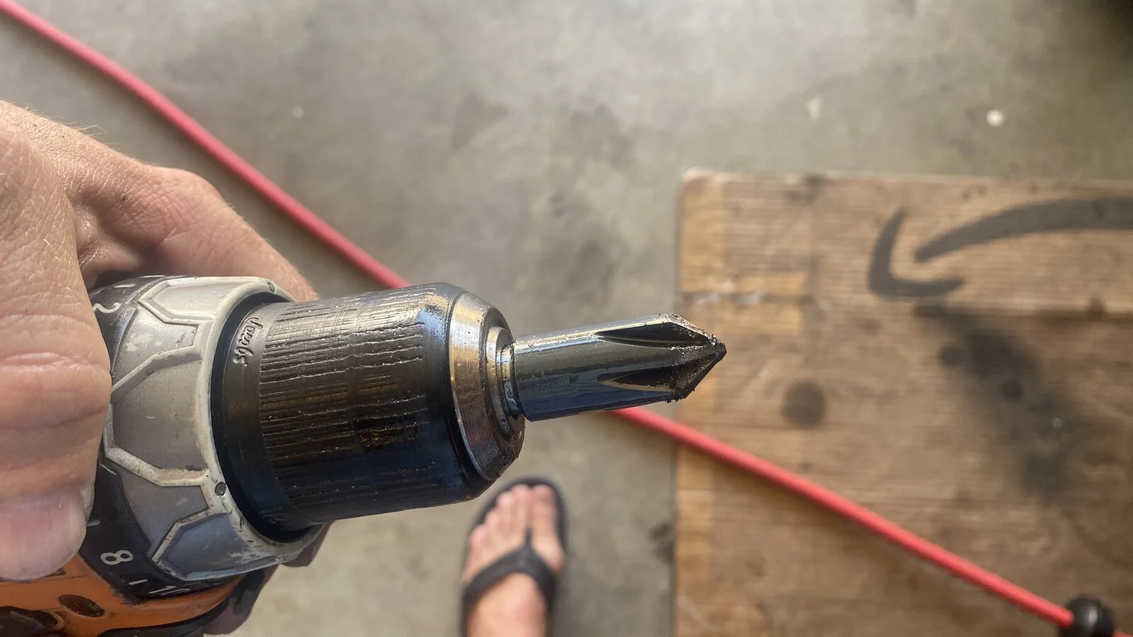

Fortunately for me, I am the first to use the bits. So the krew can suck it after I am done :p
I’m using M42’s now, which are 8% Cobalt. Much better than crappy titanium or whatever bits, but I’ve still replaced two bits already. The later crew will have the disadvantage with the bits, but perhaps the advantage of a prior installation. They should be really nice and functional.

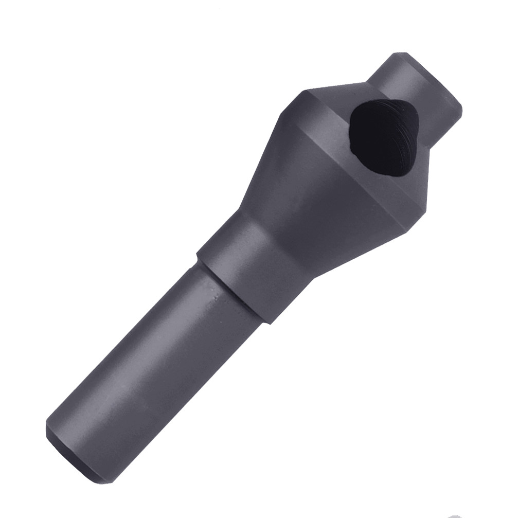

This is the countersink the krew is using. It has about 40 holes behind it plus what Matt will eventually put in some day. 🤫
Drill America 3/8" X 3/8" 82 Degree Piloted Countersink, WEL Series https://www.amazon.com/dp/B00FXOI4GK/?tag=wranglerorg-20
Thanks. I'm now looking at some 5/8" designs by Drill America. I've always used the zero flute designs. The 6 flute designs remove more material more quickly and work better with harder materials.
The 6 fluters I have used leave a lot of chatter. The ones above have been smooth and easy to control in both steel and aluminum.
Reactions: rasband
I have experienced the same smoothness with 0 flute countersinks. I've only used 6 flute designs on wood. I was reading this though on the Drill America marketing. States they are "also called chatterless."
More research and they also say this, which is what I've been following. The through hole on a 0 flute allows the chips to move into the space and avoid clogging.

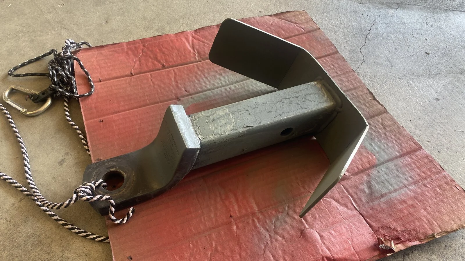

Re-purposed this hitch I’ll never use to fab up a paddle board anchor for the river. I take it to show the wife and she just looks at me like it sucks and is like, I’m not carrying that heavy thing on the paddle board (she’s been asking for an anchor). I explain that it’s only about 5 lbs and probably needs to be 10-12lbs.
What is it with women? I can’t get the lack of appreciation when you do something a wee bit creative. In this case it even looks like an anchor. 🤷‍♂️
In her defense that does look awful to carry around on a paddle board😅 A kayak where one could stow it in the back I could see.
I get that. And I told her I’d carry it on my PB. Later she commented that it was really cool. So there is that. I think with her there can be 100 good qualities, but if one thing is sketchy it comes out negative.
She just wants the ability to stay in one place rather than float 3 hours to the out on a river. I hope it’s solved. We’ve been running g rivers for 18 years, so tying up, standing on a rock, et al are options, but the best one is an anchor.

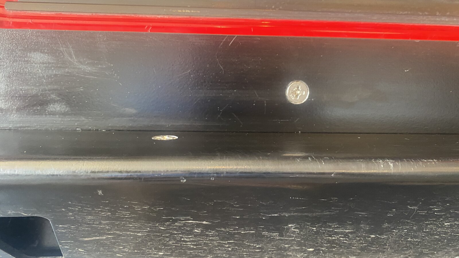

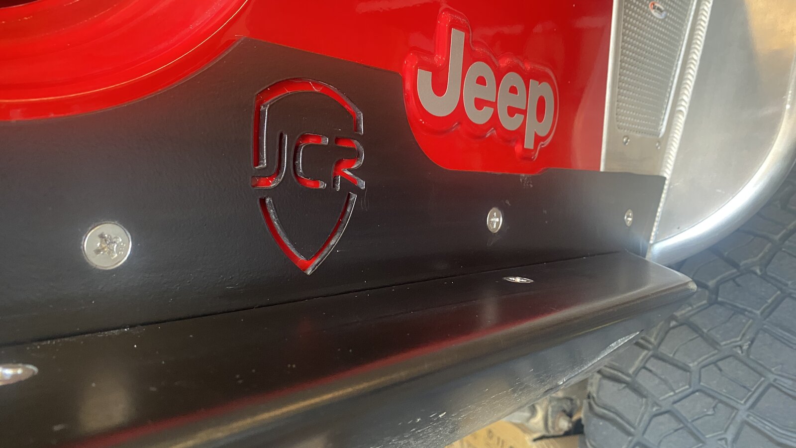

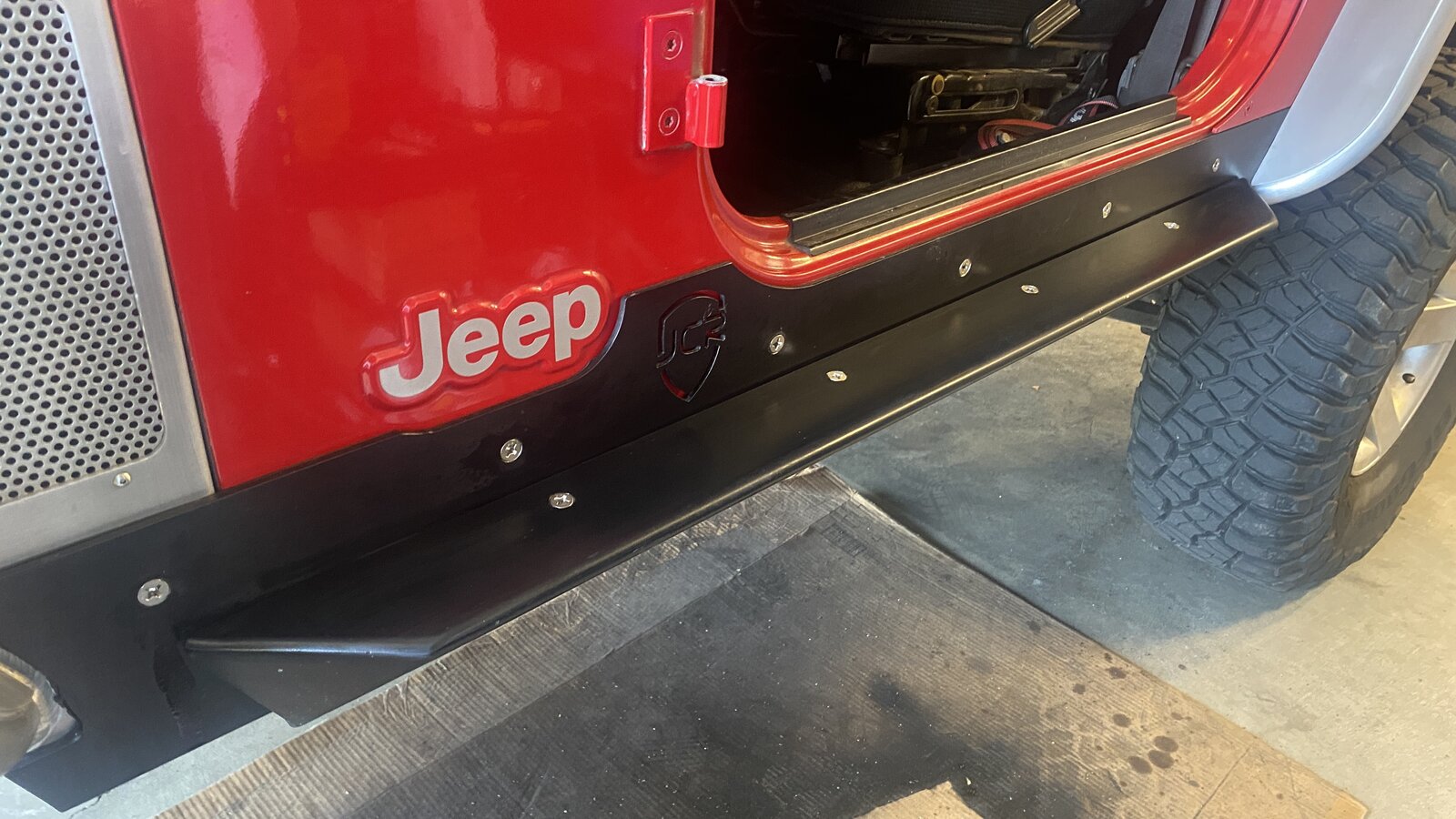

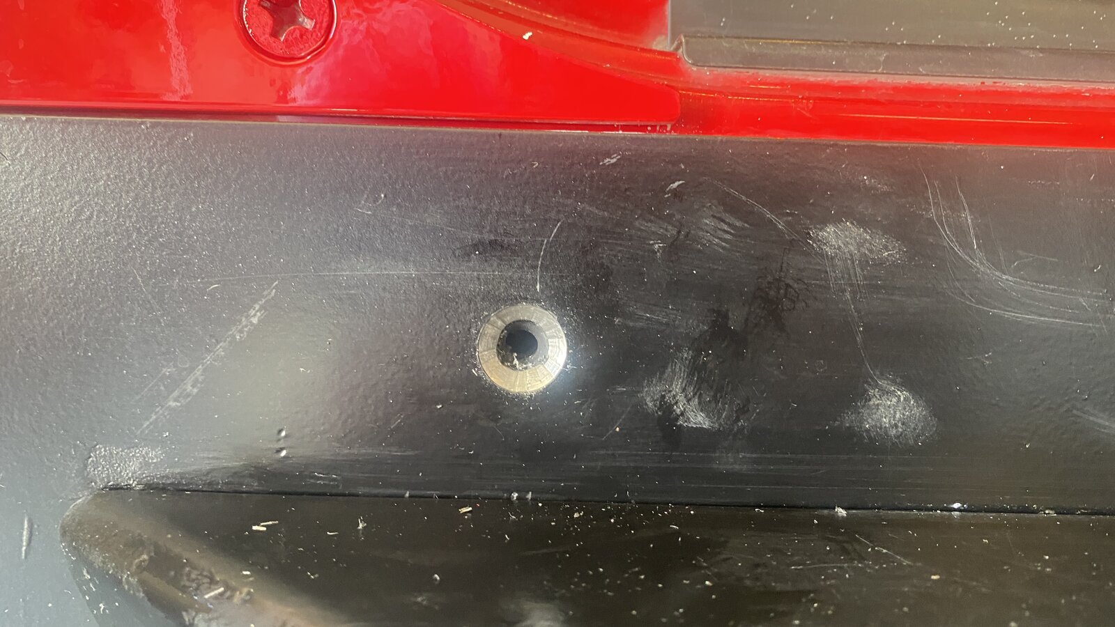

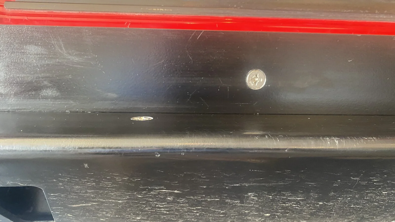

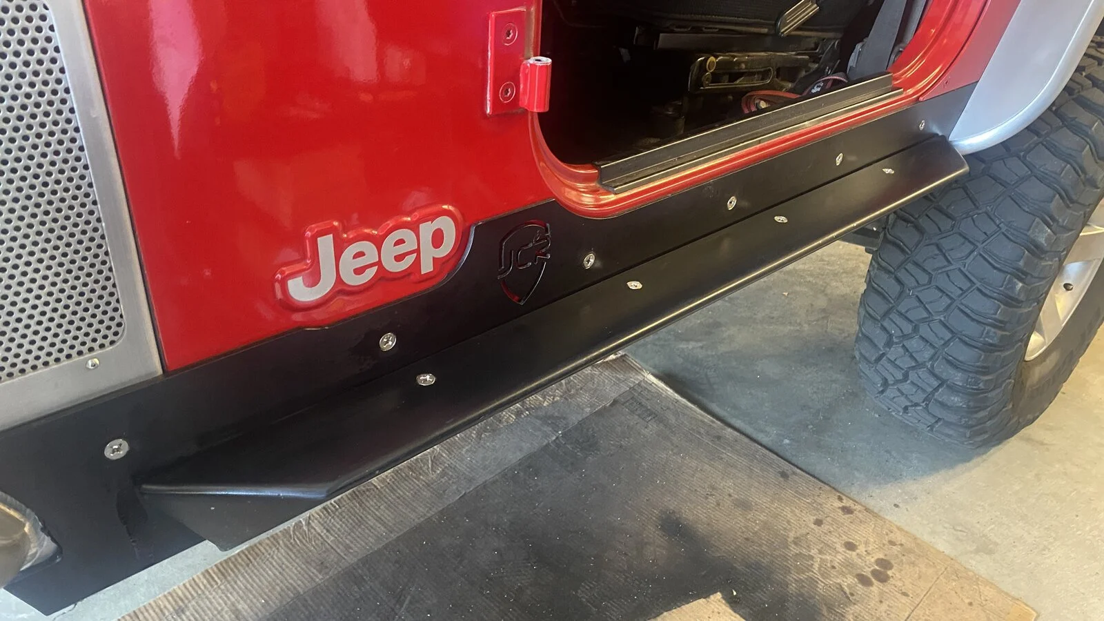

I’m countersinking the body and slider bolts on the JCR sliders bc I hate those Allen button heads. The 0 flute was taking forever. I had also gone through two of them and I was using drill bit oil. I got to researching fluted bits and decided to try a 6-flute bit from Drill America. These cut through metal faster and are called “chatterless.” After using it I would go with one of these 100 out of 100 times for steel. That’s 100% of the time for the mathematically challenged. 🙂 It would only chatter if you went really, really slow. If you just went slow it was normal and done in literally 25 seconds per hole. 5/8” head 82* conical.
That’s all the modifications to the JCR’s I can think of. I don’t think they can be made any better. They are what they are and they’re just ok, though I’ve never had any tub damage or issues with them other than wallowing out part of the tub floor due to the original thru-bolts. Fixed that with a floor plug.
