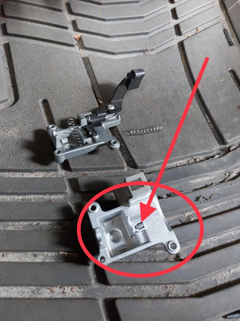

Just to clarify, there are two shift cables that come off of the shifter. One for the transmission, and one that goes to the key cylinder so the Jeep can’t be shifted without the key and foot on brake/key can’t be removed without being in park. IIRC correctly, a first gen Jeep Liberty interlock cable is the same as the TJ.
Blaine mentioned it on your other thread, but there’s a little ball and detent that gets swapped out under the cylinder as well for said cable. That can also come from a Liberty. That’s where I got mine. I think I sent some extra pieces to Blaine and Mike and they worked.

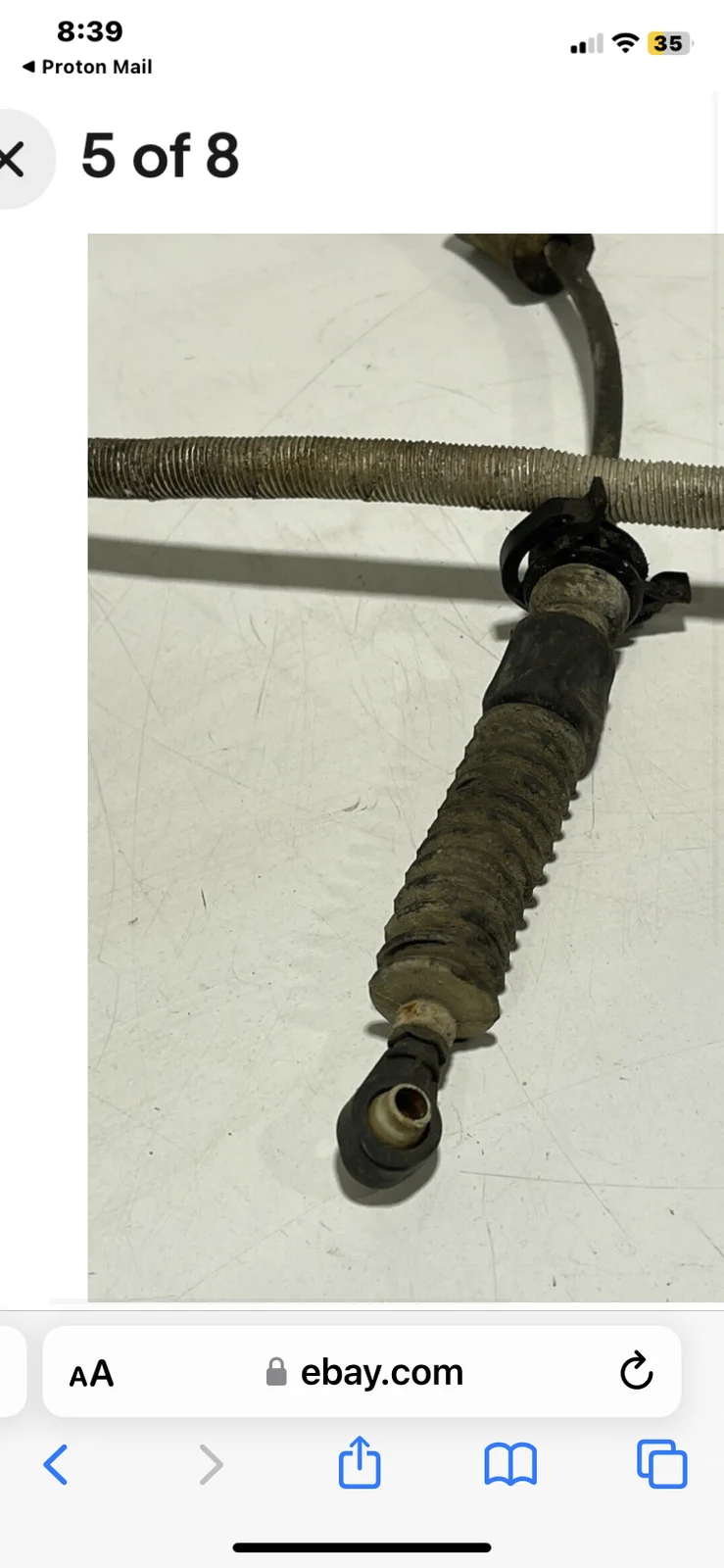

Geez. I see that. I took pics just in case I might lose my build thread. 🙂 I suspected that would be a hard part to find. I see you’re going through the same swap. Or are you done already?
@Mike_H and @Jamison C, this is the shifter cable I know about.
I’ll have to go back and read Blaine’s comments to see what the other one is.
It’s not done yet. Blaine is going to be taking over once I get a few more things. Fortunately the guy I got the transmission from has everything else too except for a few things because it was a part out.

If you can find a part out, it’s a great way to go. I think I’m only getting four parts, but they’re important: tranny, torque converter, flex plate, and harness. The rest are just pieces. My biggest lack is not having mrblaine. My biggest help is having an 04 and 05 42rle in the driveway. Hope all goes well with yours. I’m excited to see how different my rig is both on and off-road. Thank you for the pic. Now I just have to find those parts.
