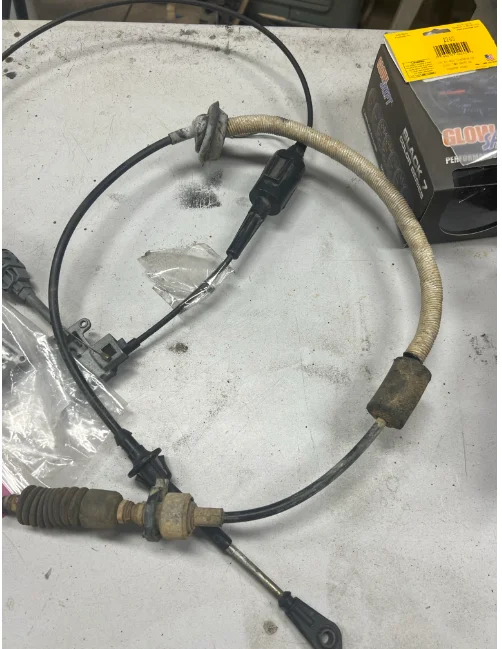

Geez. I see that. I took pics just in case I might lose my build thread. 🙂 I suspected that would be a hard part to find. I see you’re going through the same swap. Or are you done already?
@Mike_H and @Jamison C, this is the shifter cable I know about.
I’ll have to go back and read Blaine’s comments to see what the other one is.
Best pic I have, but it sucks. Shift cable in the foreground, interlock cable behind
Let me check my parts stash. @Jamison C sent me one of those little cast ignition interlocks, and I got a couple from Daveys when I bought the rest of my stuff. I probably have a spare. If I can get my hands on it, I'll send it out to you.

If you can find a part out, it’s a great way to go. I think I’m only getting four parts, but they’re important: tranny, torque converter, flex plate, and harness. The rest are just pieces. My biggest lack is not having mrblaine. My biggest help is having an 04 and 05 42rle in the driveway. Hope all goes well with yours. I’m excited to see how different my rig is both on and off-road. Thank you for the pic. Now I just have to find those parts.
