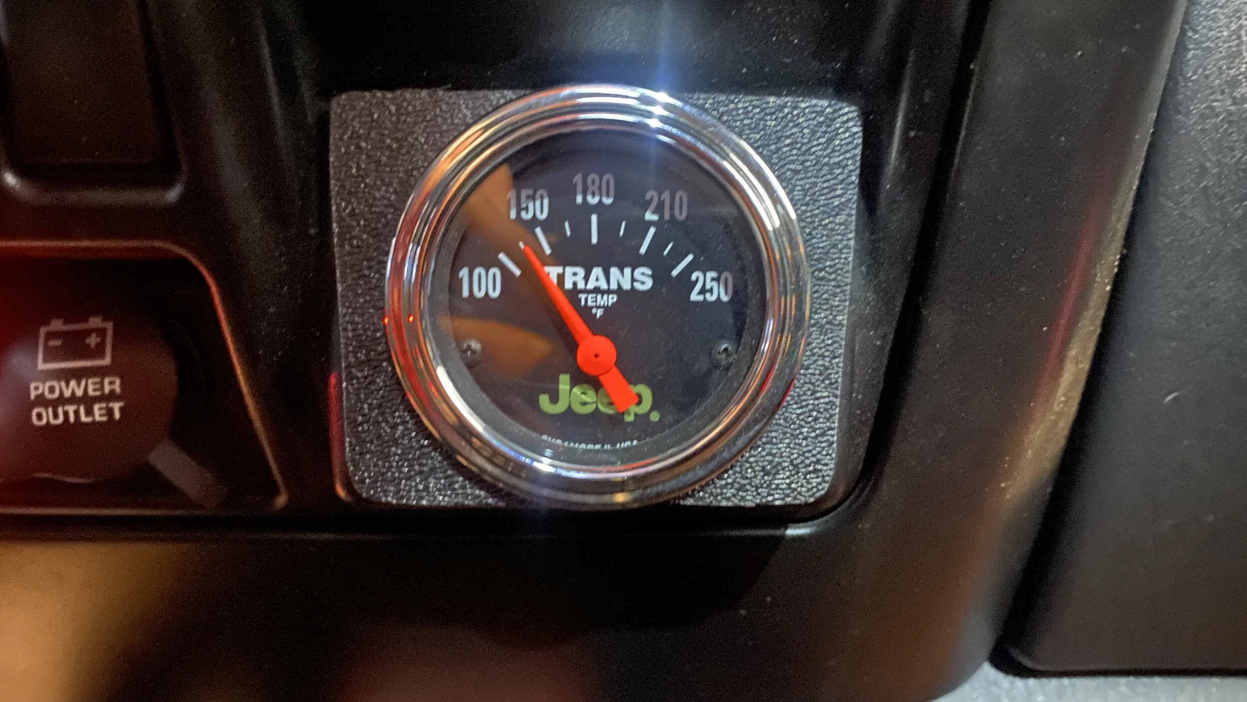

I needed to set up the switched power to the AutoMeter Transmission Gauge. It requires 3A. I wasn’t sure where to go. Fuse 6 had a 20A and filled by the seat heaters. Fuse 14 is a 10A and filled by the rear locker. Fuse 18 is a 20A but inaccessible because the Fuse 14?is right next door and blocking it. The good news is @tworley mentioned in a thread for seat heaters that they draw 5-6amps, so being on a 20A fuse I could tap into it and still be well within. Went for a drive and it moved up to 125*F at 47*F outside temp. Checked the transmission fluid level and it looked good!

I needed to set up the switched power to the AutoMeter Transmission Gauge. It requires 3A. I wasn’t sure where to go. Fuse 6 had a 20A and filled by the seat heaters. Fuse 14 is a 10A and filled by the rear locker. Fuse 18 is a 20A but inaccessible because the Fuse 14?is right next door and blocking it. The good news is @tworley mentioned in a thread for seat heaters that they draw 5-6amps, so being on a 20A fuse I could tap into it and still be well within. Went for a drive and it moved up to 125*F at 47*F outside temp. I’ll keep an eye on omit over the coming months. I want it not to exceed 209*F. Checked the transmission fluid level and it looked good!

I vaguely remember talking about this, but I thought it was closer to 10 amps. For some reason 7 sounds right...
