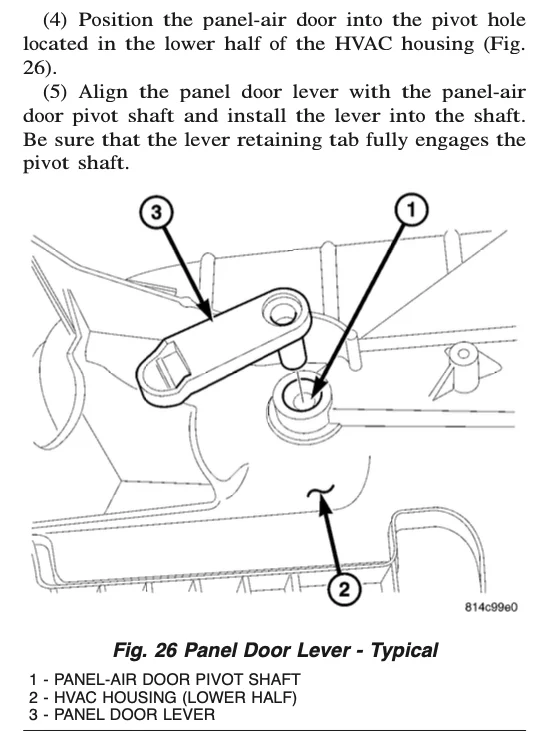

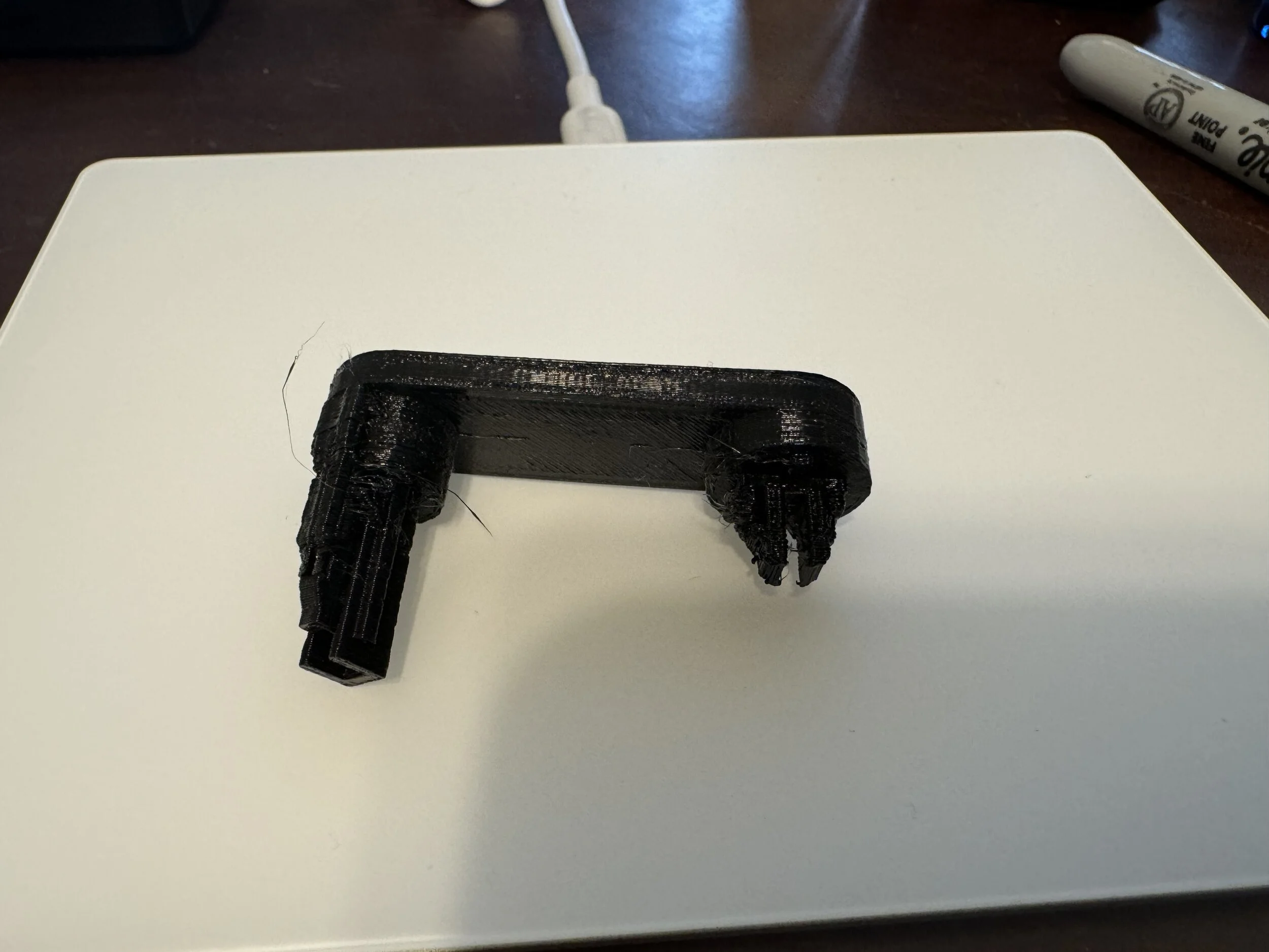

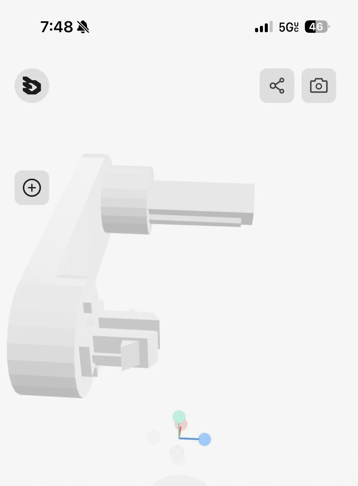

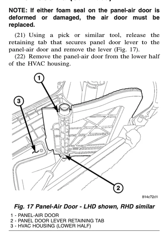

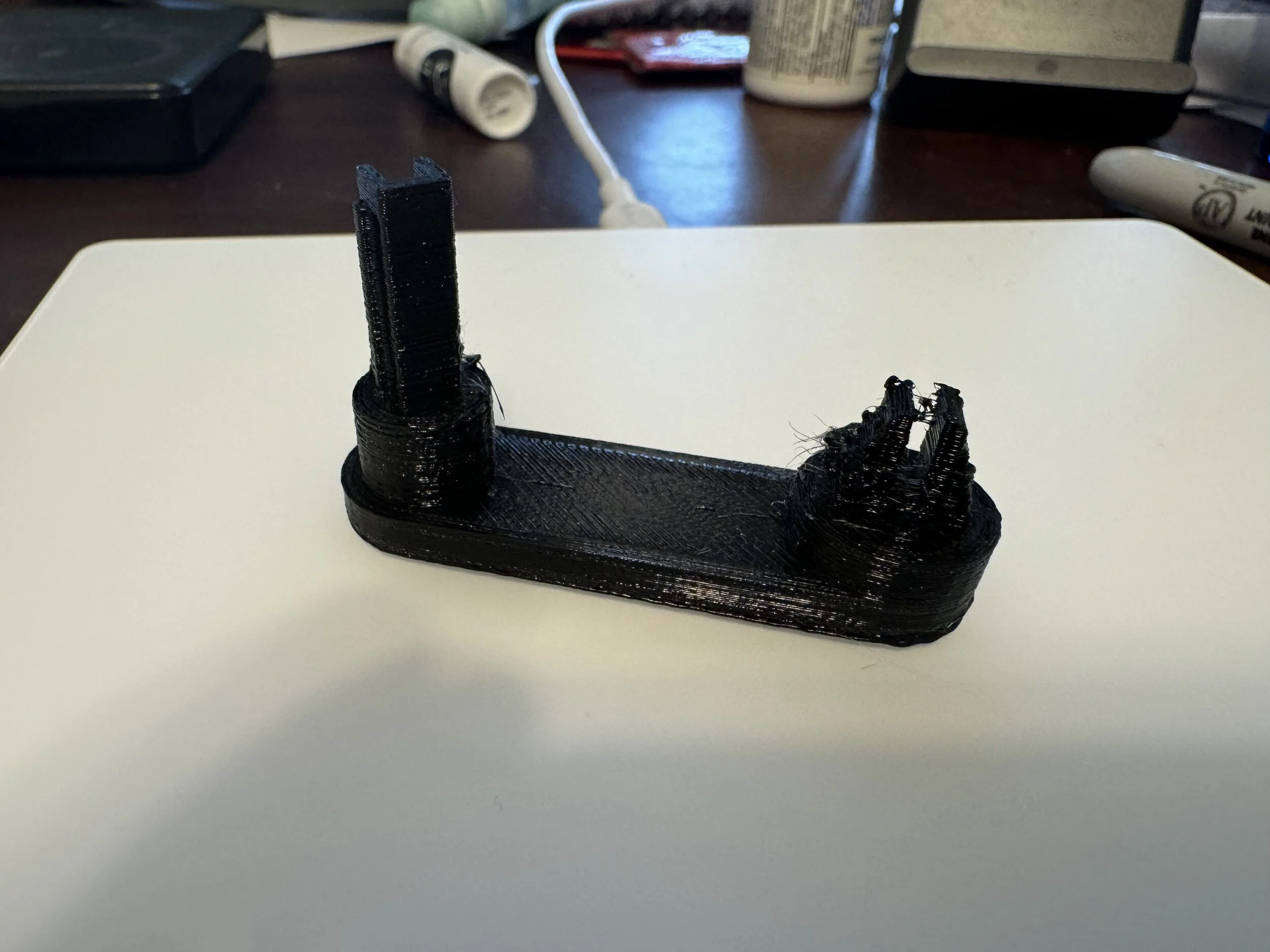

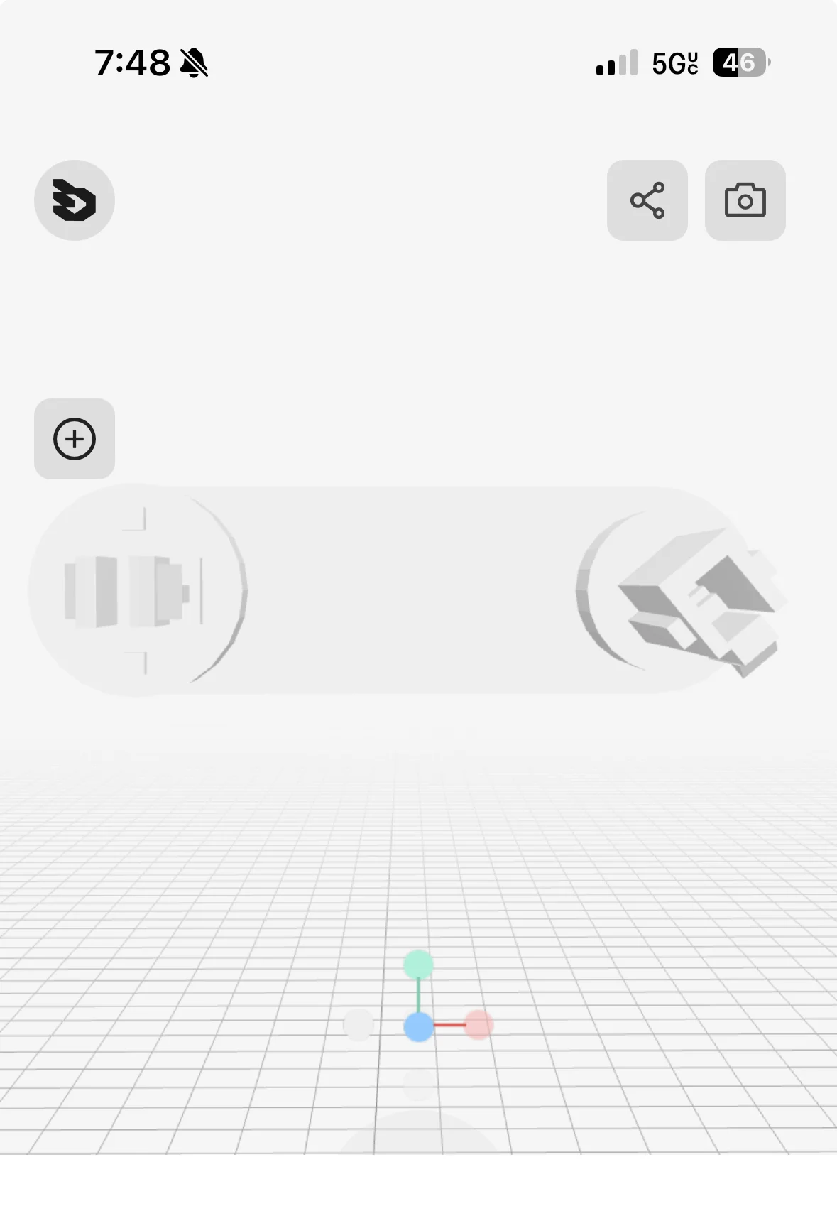

Yes, both lines were very hot. I think I need to look at the HEVAC diagrams and sort out what would be affected by the blend door that I broke (and fixed). NO air is coming out the four main vents, only out the defrost and floor vents, so something is wrong.
