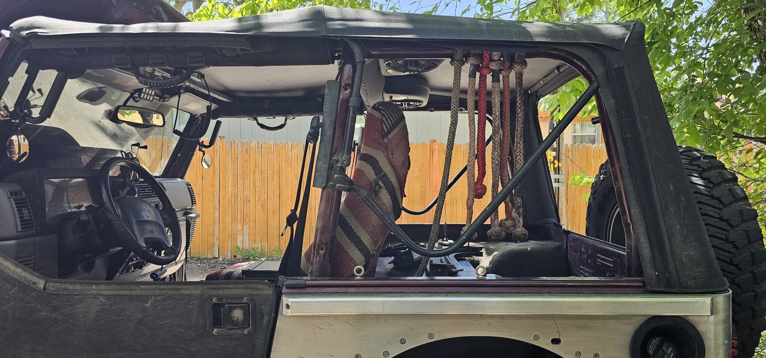

Without door surrounds, the soft uppers will flop and flutter around more than they will with the surrounds. And the horizontal portion of the surround is what the soft top attaches to.
The vertical section of the surrounds can be separated and removed to give the top something to secure to.

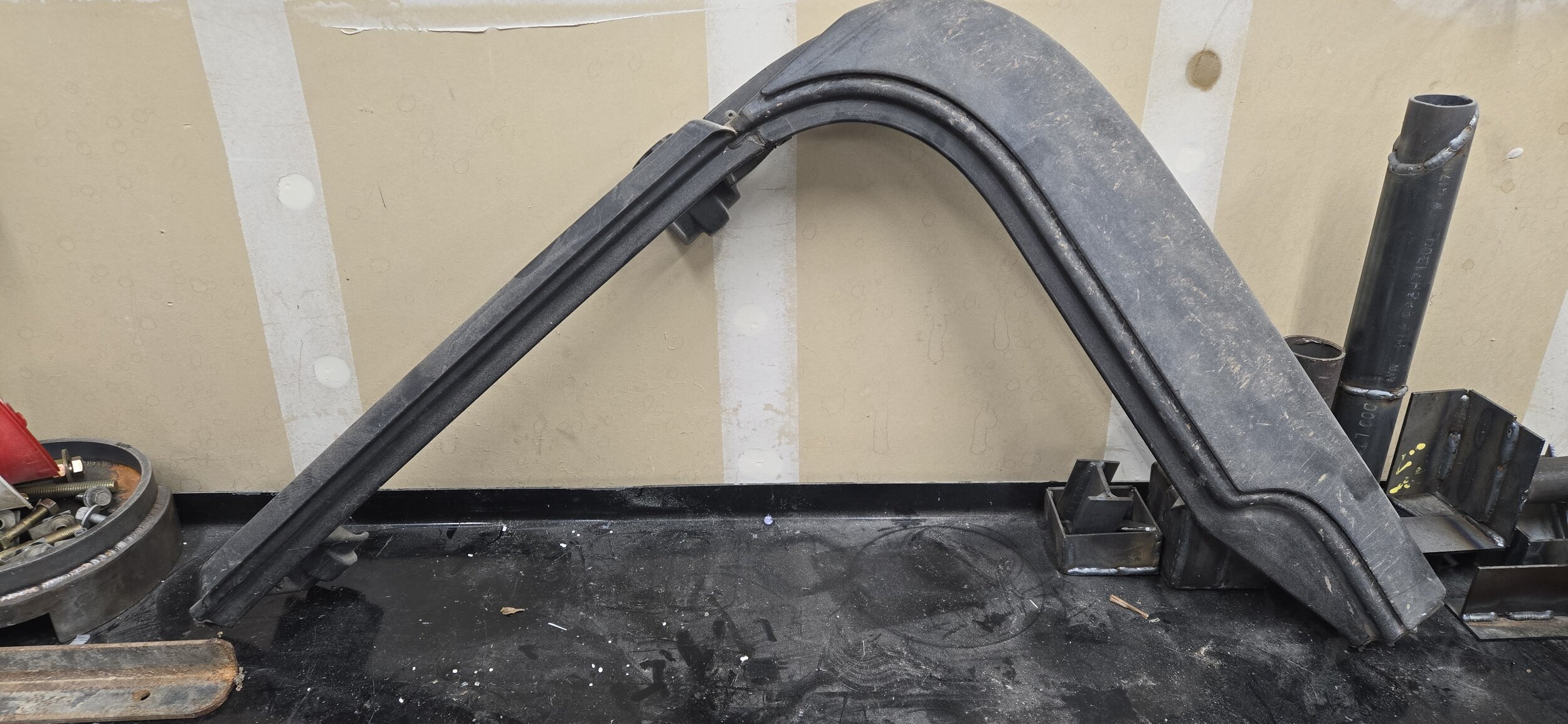

I've got one if you're interested. Driver side. Missing one knob though.

If the FB deal falls through, my offer still stands. You can have it for the price of shipping. This one has been sitting in the garage for years.

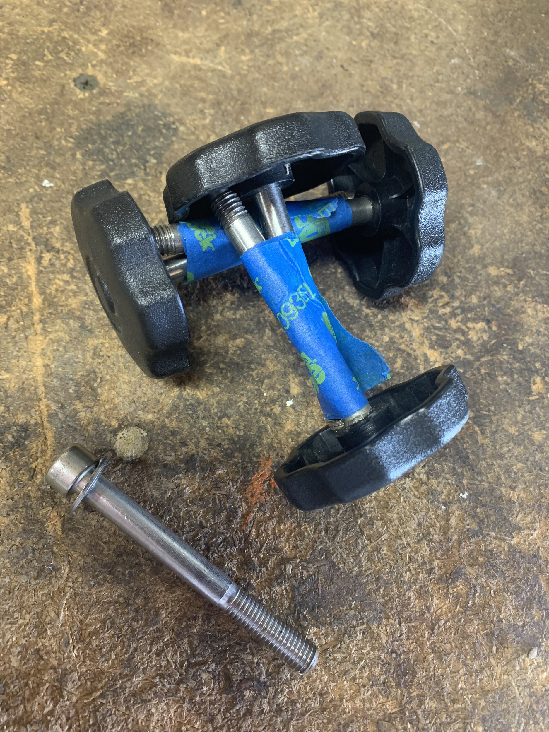

If you’re not going to be taking them on and off often you can just use some 8mm1.25 75mm bolts (harder to steal).
If you really want the knobs pm me your address and I’ll send you my spare set.
That's a good idea with the 8mm 1.25 pitch 75mm bolts. I think I'll start with that and go from there. Thank you so much for both the offer and the idea. 💡
