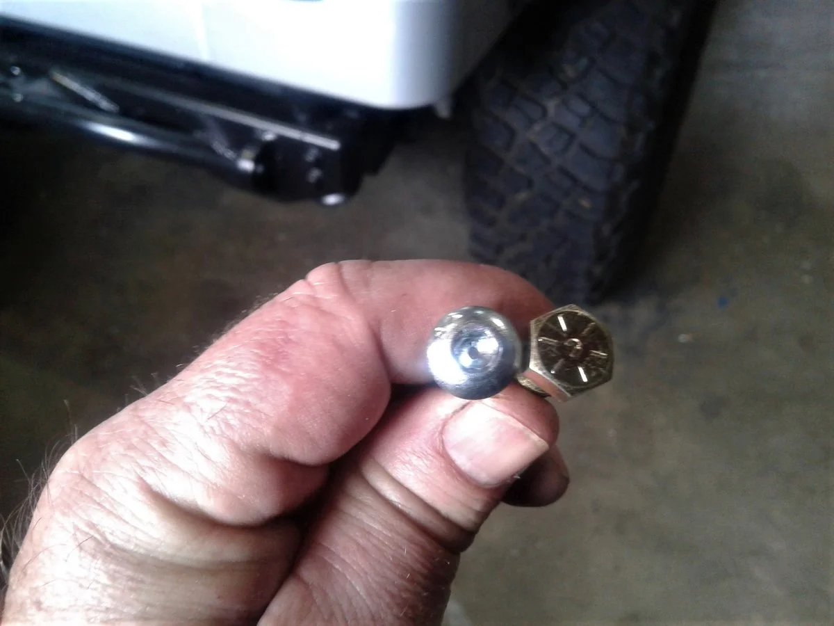

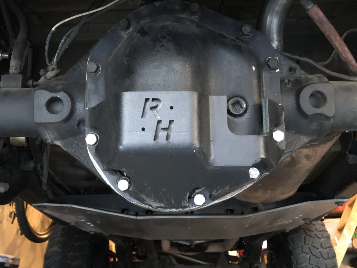

I had some fluid dripping out of the Dana 44. Decided it was time to change the fluid anyway, so I got a new LubeLocker. I think the problem is the stupid diff bolts that RockHard 4x4 hard hat comes with. They are longer to accommodate, but use an Allen head. Ridiculous, so I got some longer bolts with a hex head and am all good to go. With the pinion tilted so far up it doesn’t take as much gear fluid. I guess that’s ok since no one complains. Gears look good at 12,000 miles

I had some fluid dripping out of the Dana 44. Decided it was time to change the fluid anyway, so I got a new LubeLocker. I think the problem is the stupid diff bolts that RockHard 4x4 hard hat comes with. They are longer to accommodate, but use an Allen head. Ridiculous, so I got some longer bolts with a hex head and am all good to go. With the pinion tilted so far up it doesn’t take as much gear fluid. I guess that’s ok since no one complains. Gears look good at 12,000 miles View attachment 173026
I have the exact same cover and had the same problem. Cover seeped with the Allen heads even with correct tq. I gave one an extra oomph and the head stripped. Swapped em with hex heads, tq'd em up and it sealed up tight.
Yep, those are the culprits right there! Arghh...

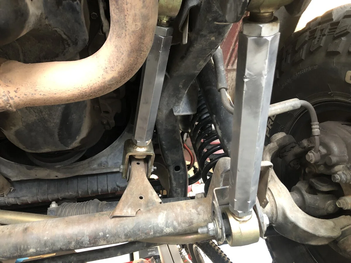

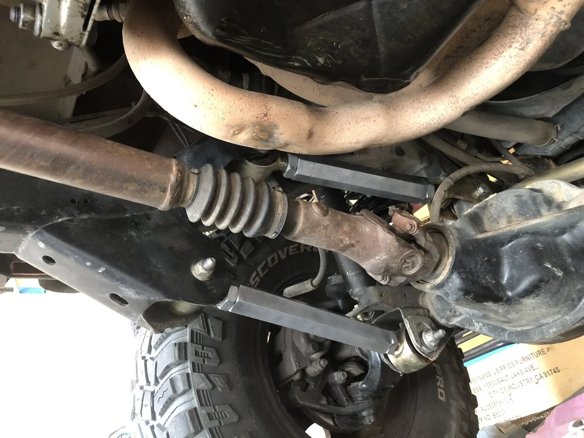

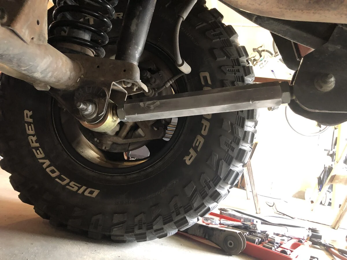

Pics of new arms from @Alex01 coming soon... Thanks, I love them. I really love double adjustables.

View attachment 174079View attachment 174080View attachment 174081
I love those arms. I'm a huge fan of the hexagonal design. Not only can you get a wrench on them, but I would count them off as I turned while doing endless pinion angle tests. I'm glad they found a good home where they will continue to get (ab)used. 😛
Before I installed them I lightly went over the few gashes with an angle grinder. Glad they come tested and true! Hit the OHV today. Everything seems 👍🏼
I like those hex arms too! (despite all the MC hate)
