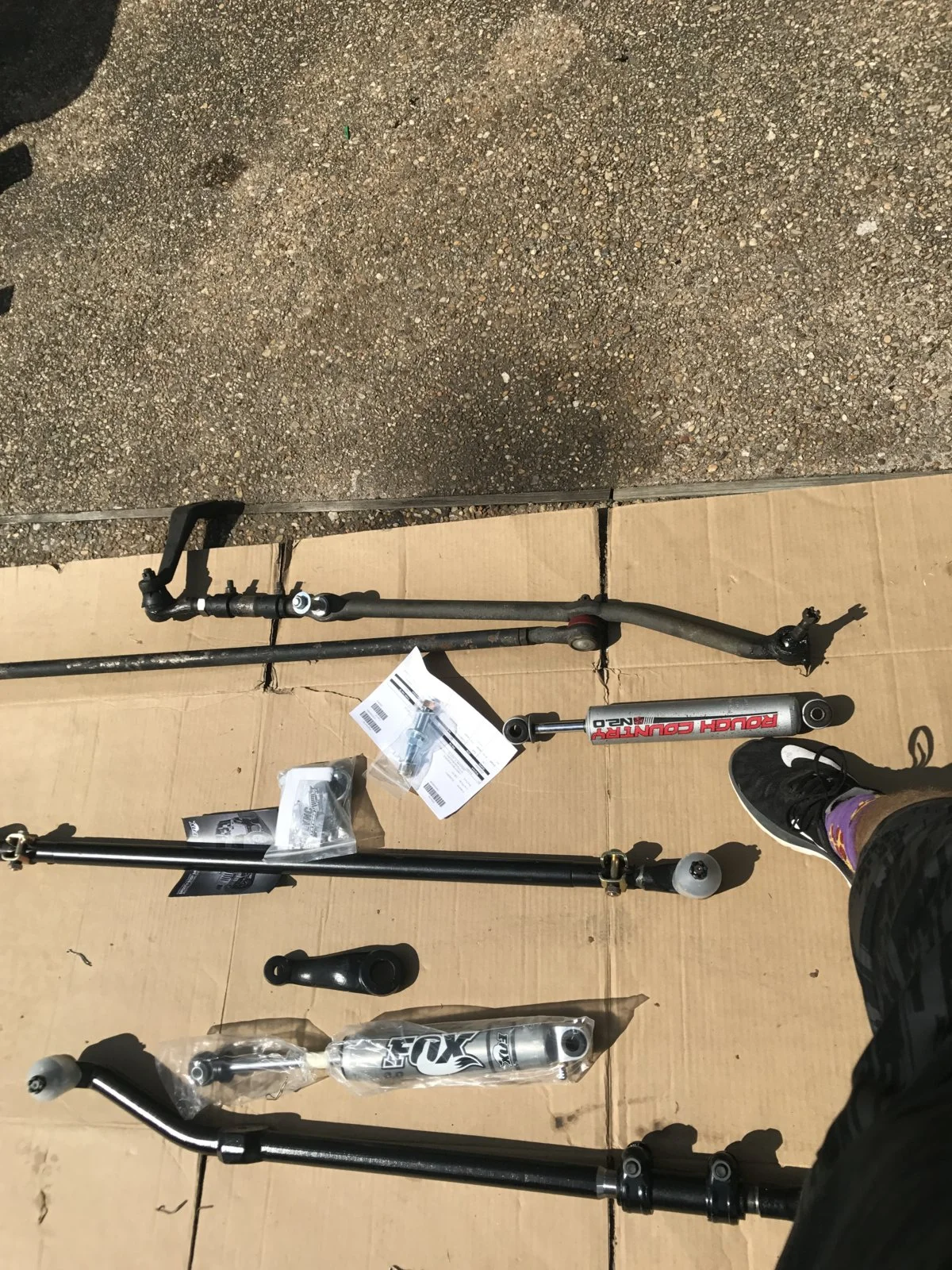

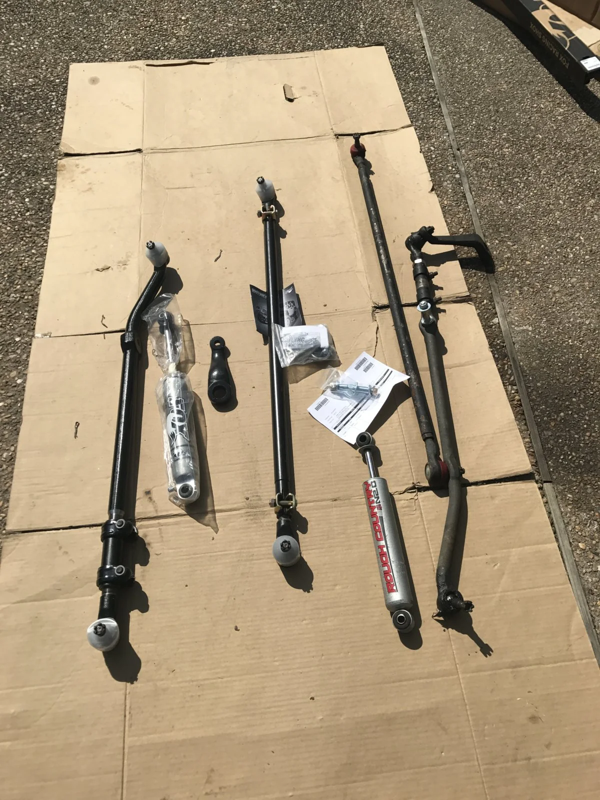

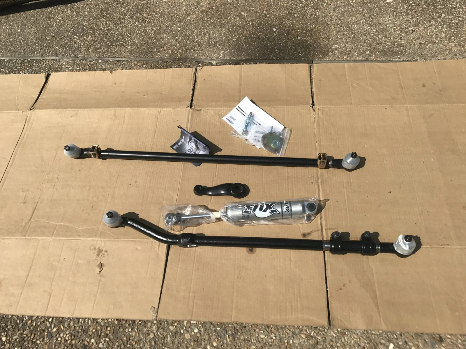

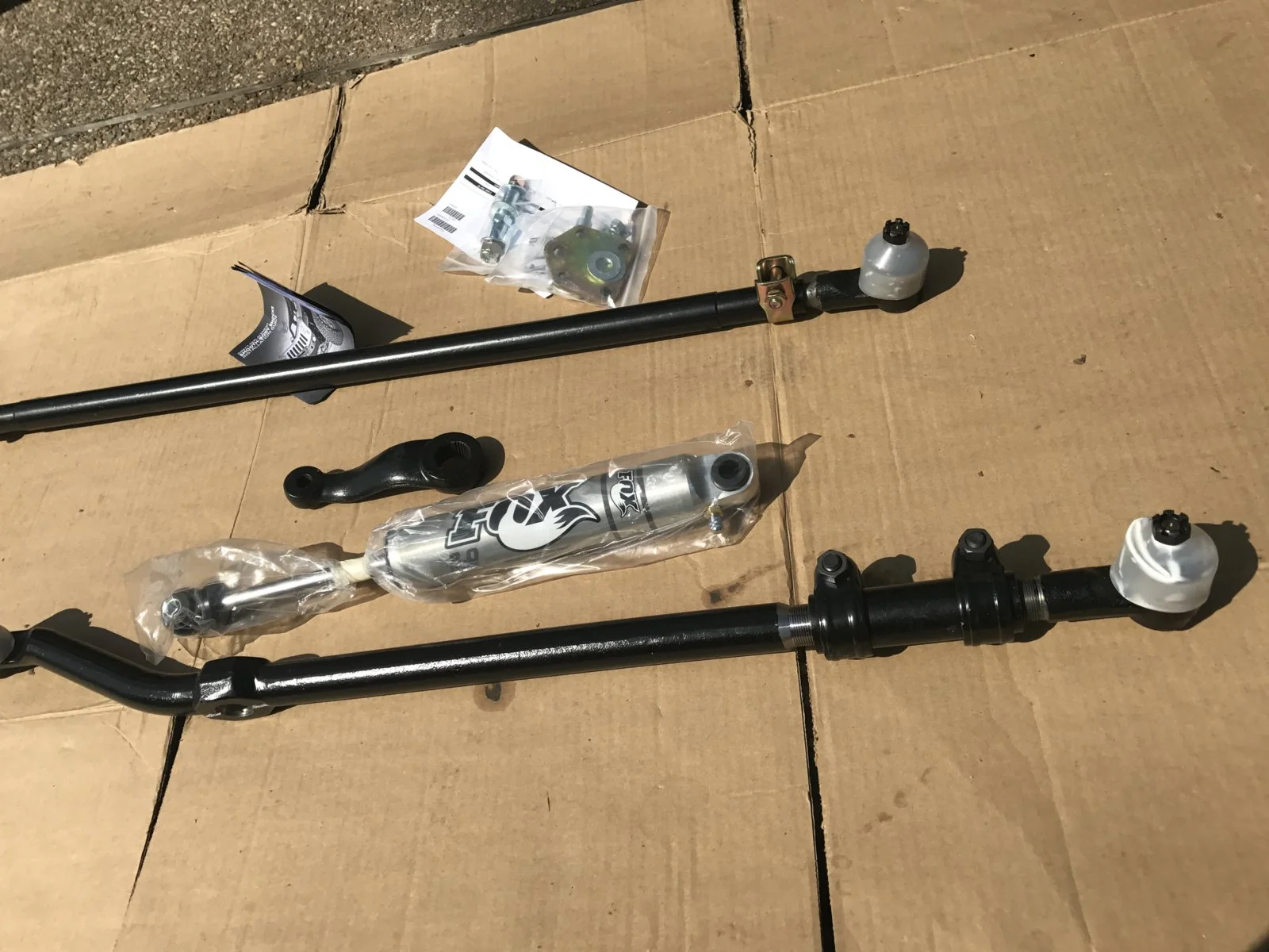

I got the old steering system off. Here is a little comparison between the two.

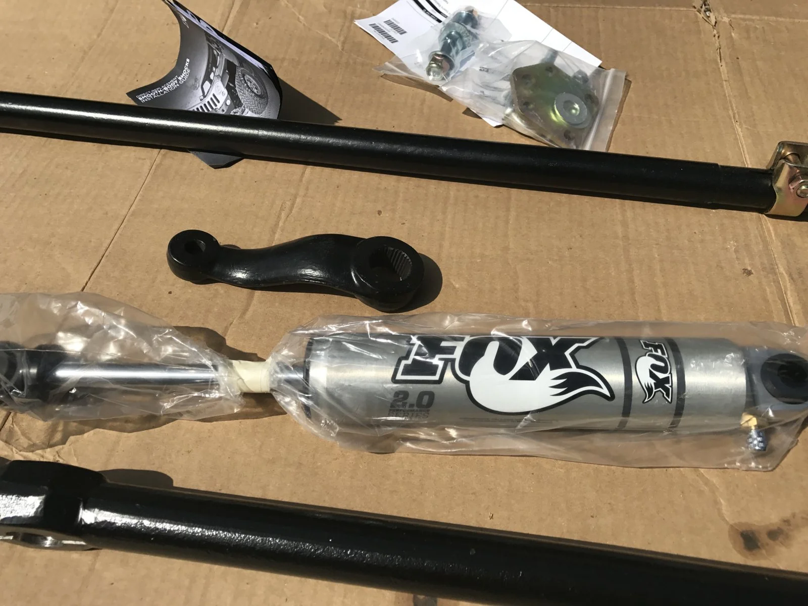

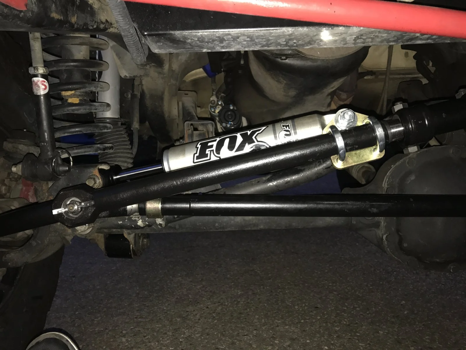

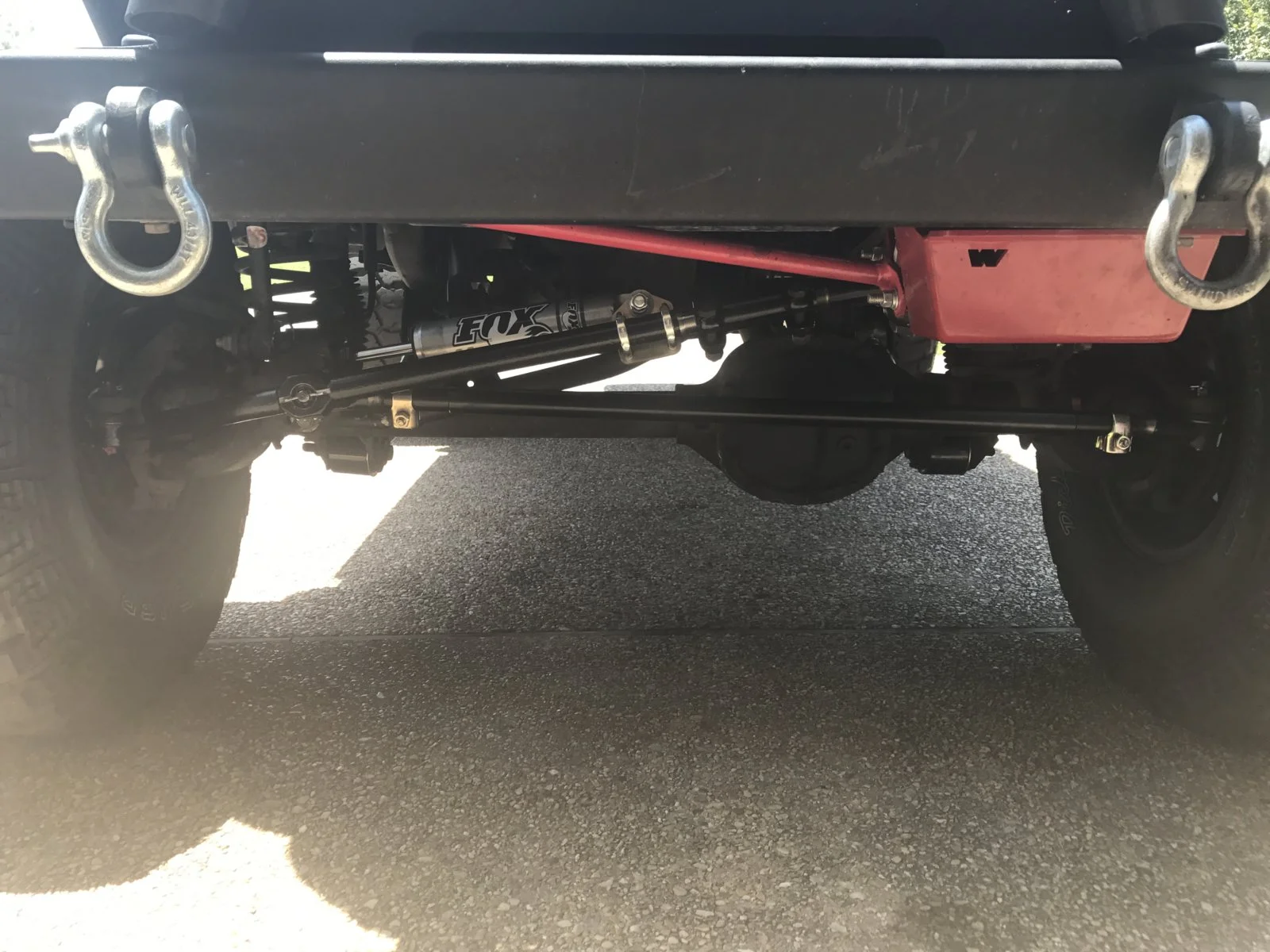

Then installed new the curry currectlync, pitman arm, and Fox SS.
The installation was really easy and was a straight bolt on took about two hours in total to remove the old, install the new, grease, and torque. After this I alighted it then took it to a shop to have it all checked. This was well worth the time, and money spent. It was a fun install, and I have zero problems with bump steer. I would recommend this product to anyone who is thinking about it. It looks great, and is well worth the price.

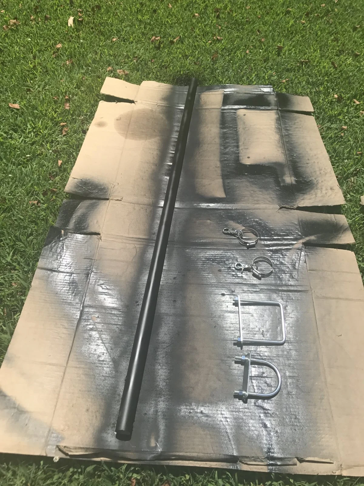

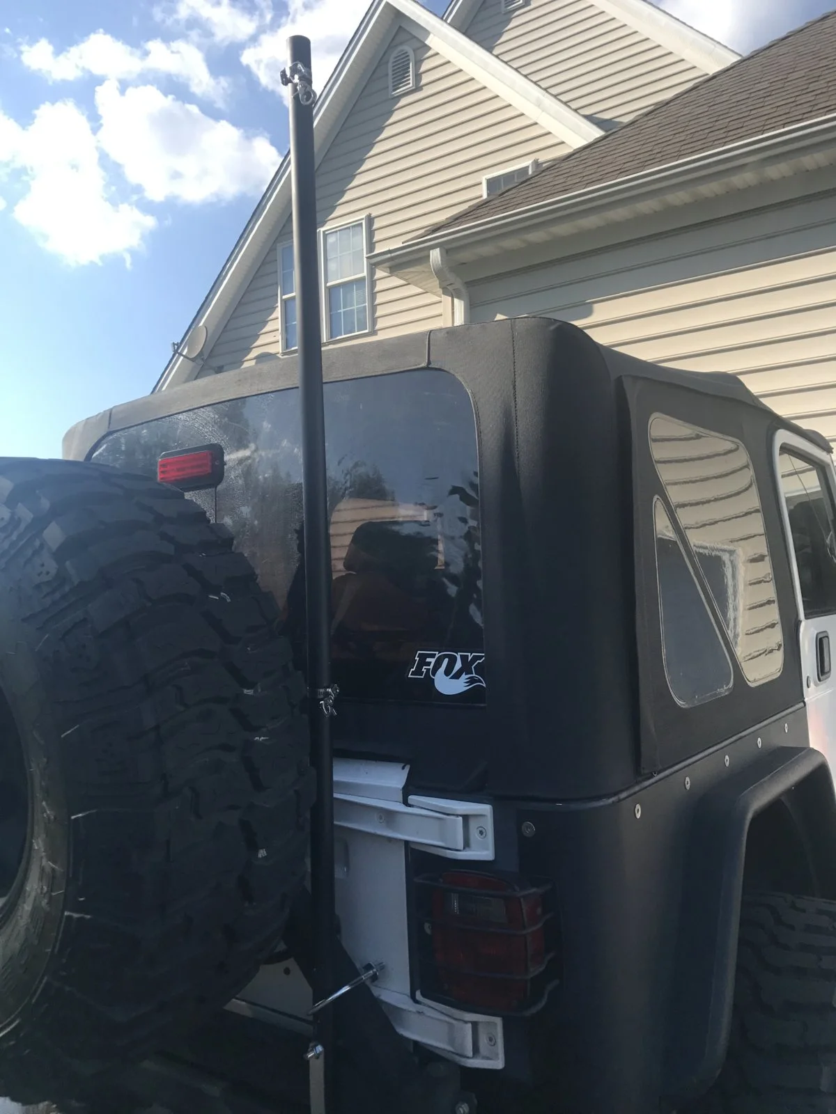

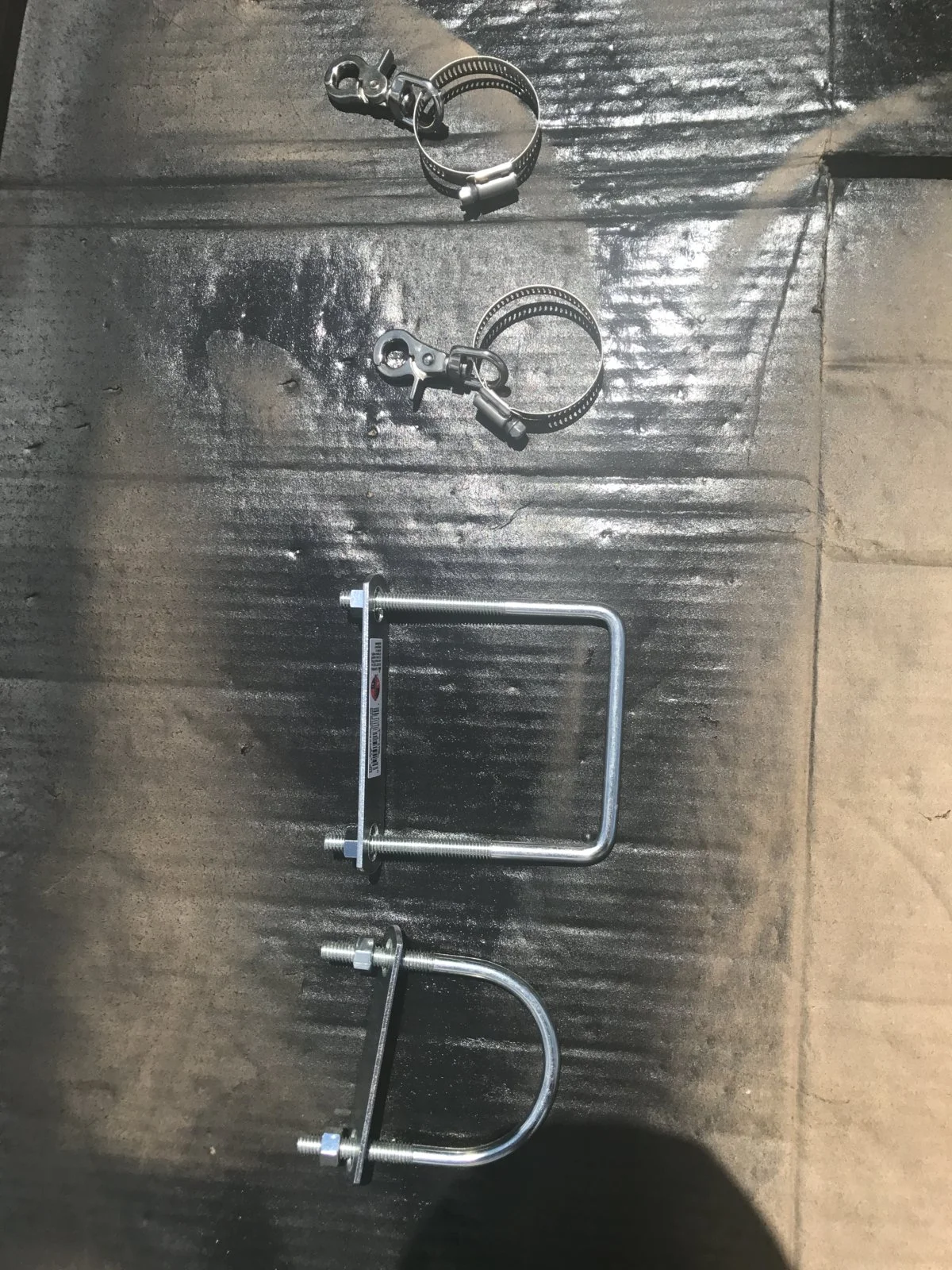

Latest update made a flag pole for really cheap and it works extremely well. I had it on the highway going 65 with no problems at all. I took a 5 ft pvc pipe with 1.5 in width ($9) then painted it black, and drilled two holes in it the length of the square bracket (4.99 for bracket). Then I mounted on the square bracket, and the pvc pipe to the bottom of the tire carrier. Next I mounted the u-bracket (2.50) on to the angled part of the tire carrier. Once bolted on, and tightened I ran hose clamps (2 for 2.75) through two clips (2.49 a clip), and clamped those to the pvc pipe 3ft apart for the flag. The flag came in today so I was able to test the setup and no problems at all. Cost me about 23$ To do. All of the parts were found at lowes.
