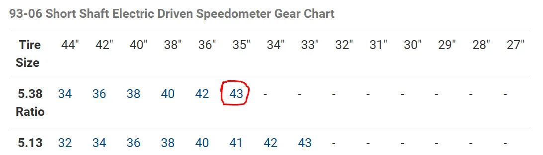

Just curious, if your speedo was off why not just replace the speedo gear in the transfer case. I was off by 20mph and the tranny was shifting way off and I used the appropriate gear and everything is back to normal.
That doesn’t work on Rubicon NP241OR transfer cases. It only works on non-Rubicon models.
Rubicons don’t have speedo gears like the NV231 transfer case does.
Or, if you have a non-Rubicon and added a super short SYE, no more gears. You need something like the SpeedoHealer.

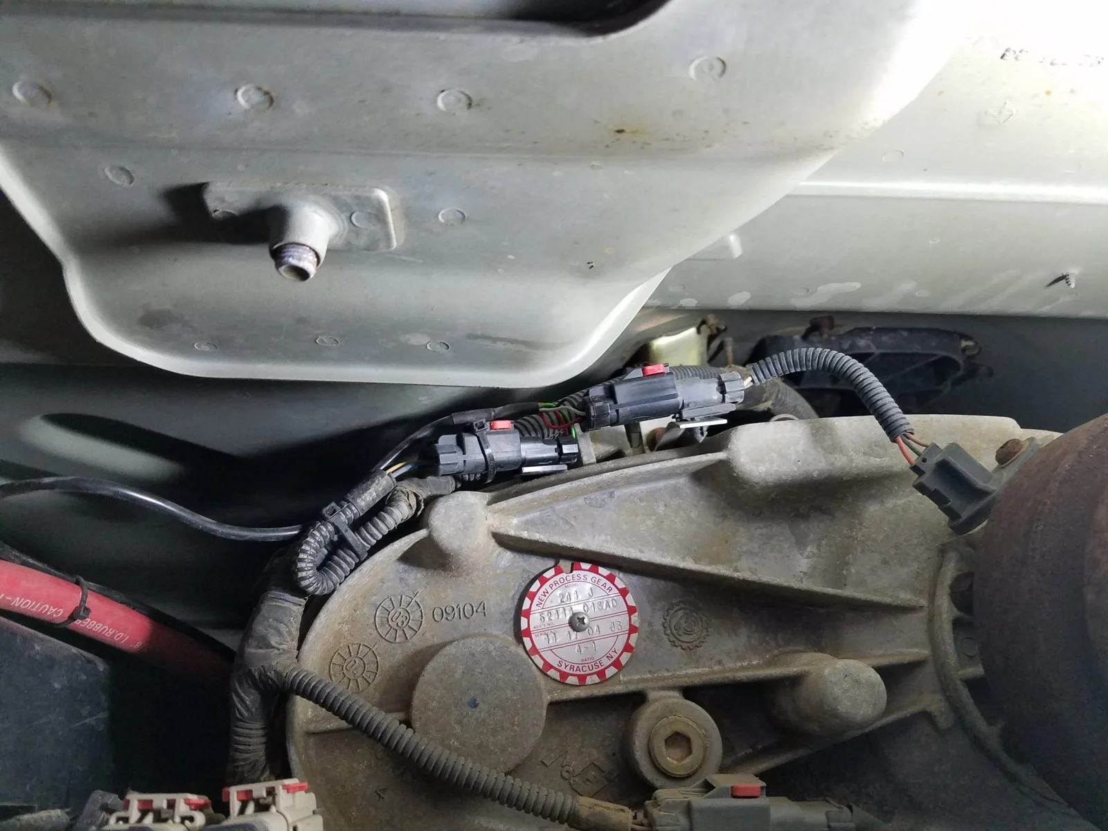

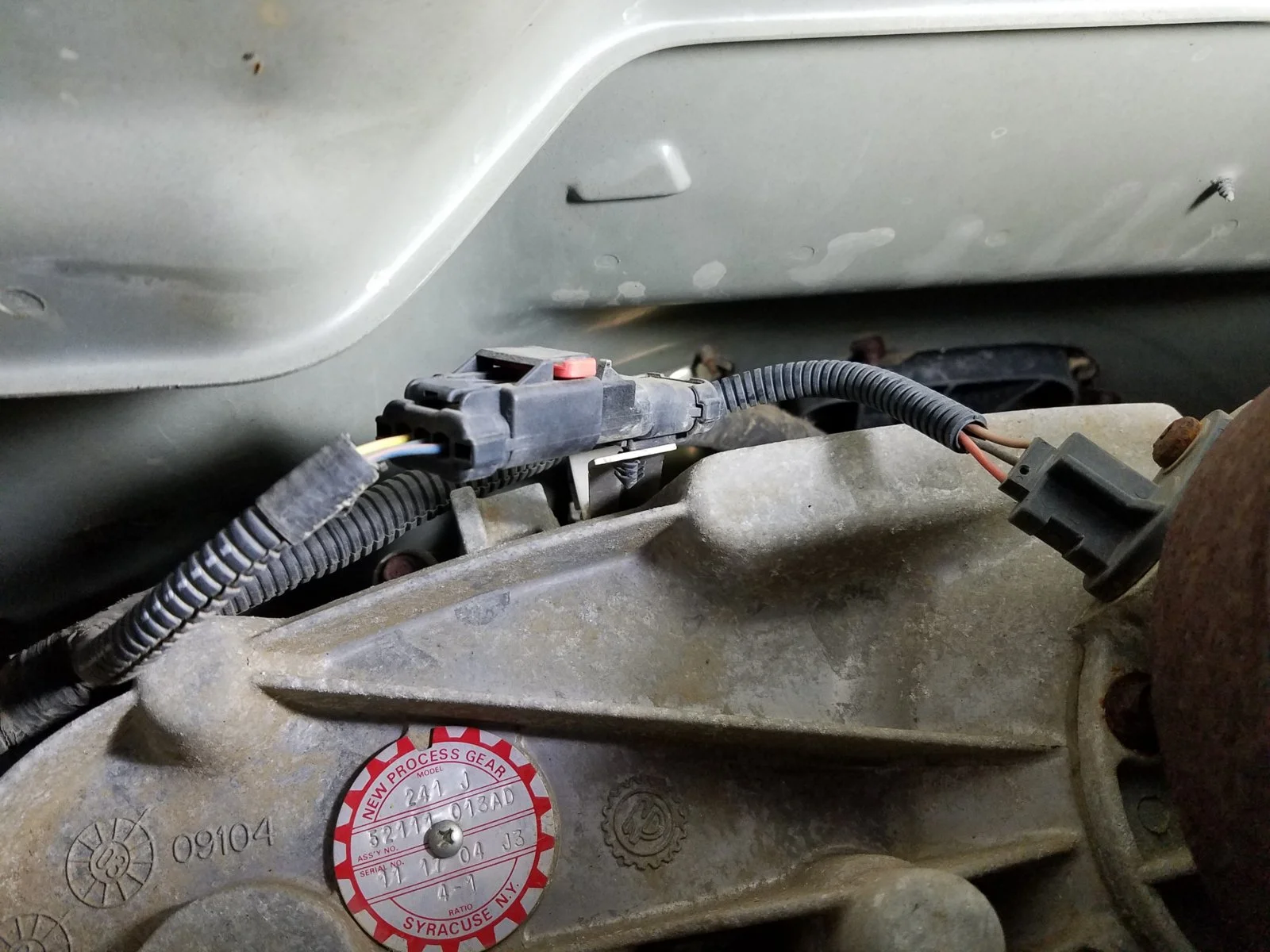

Ordered a SpeedoHealer from eBay and got it a couple weeks later. Took ten minutes to install and program, and now my speedo is spot-on. I've tried other programming solutions but none of them seemed to correct the speed as they claimed. Super easy install - just unplug the speedo at the back of the transfer case, plug in the supplied matching plugs, route the wire up under the hood, and plug in the SpeedoHealer. Easy to program too.
Here's a before and after for plugging it in to the transfer case:

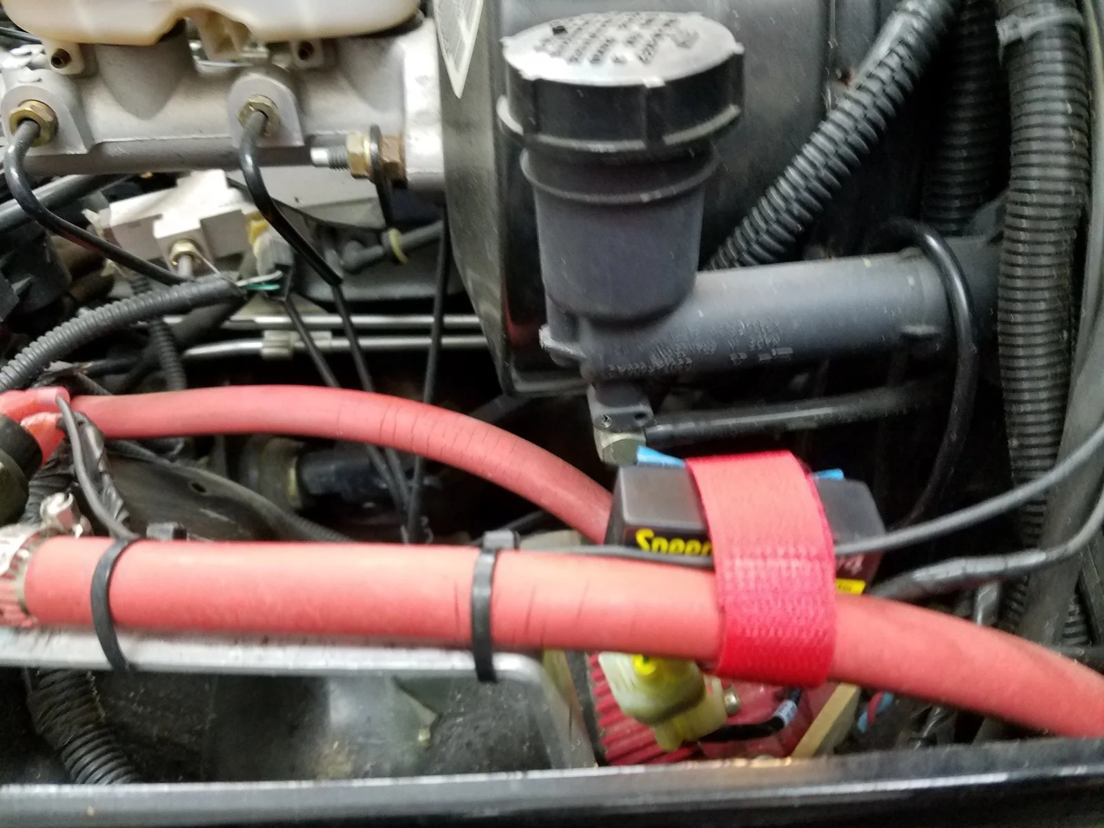

I velcro'd the unit to a hose under the hood, in case I want to move it or get at the programming buttons.
