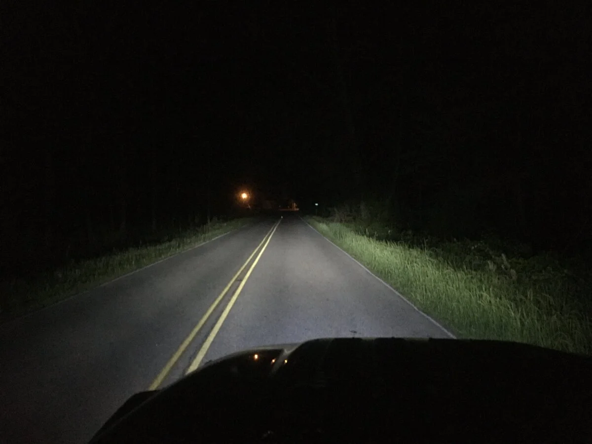

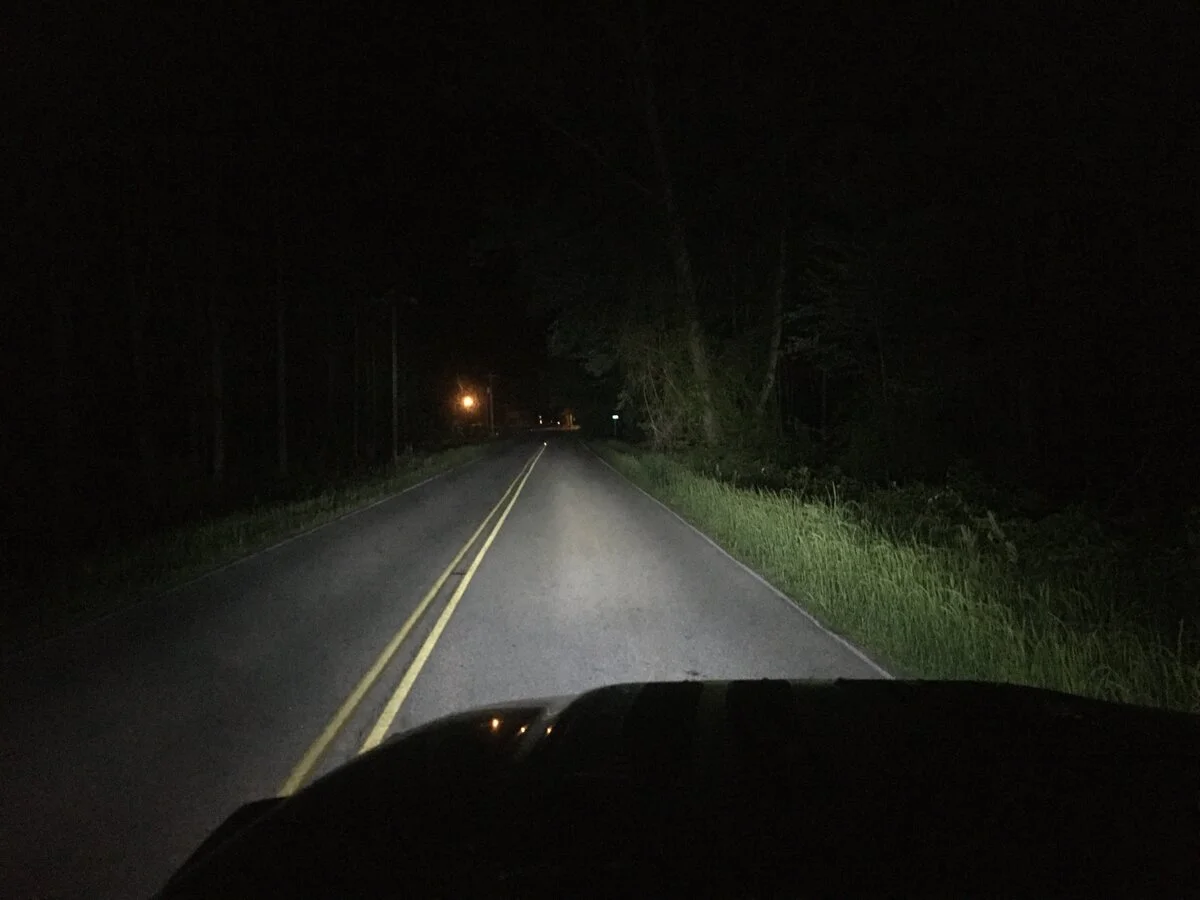

I've had the Hella E-codes in mine for a couple years now. I was running the Phillips Extra Vision bulbs until recently. @Rubicon John turned me onto these LED bulbs. BEAMTECH H4 LED Headlight Bulb For $40 bucks, I'm happy with them and have a stock look. Light pattern seems the same to me as the Phillips bulbs. Only been flashed a couple times in the month or so I've been using them.
More info: https://wranglertjforum.com/threads...p-wrangler-unlimited.14995/page-2#post-558615
Low beams
High beams
