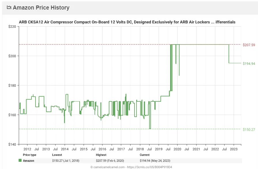

Teach me to be all crybaby about them being expensive when they were 149.00 delivered.
And yet we continue to that hear that this kind stuff is "transitory".

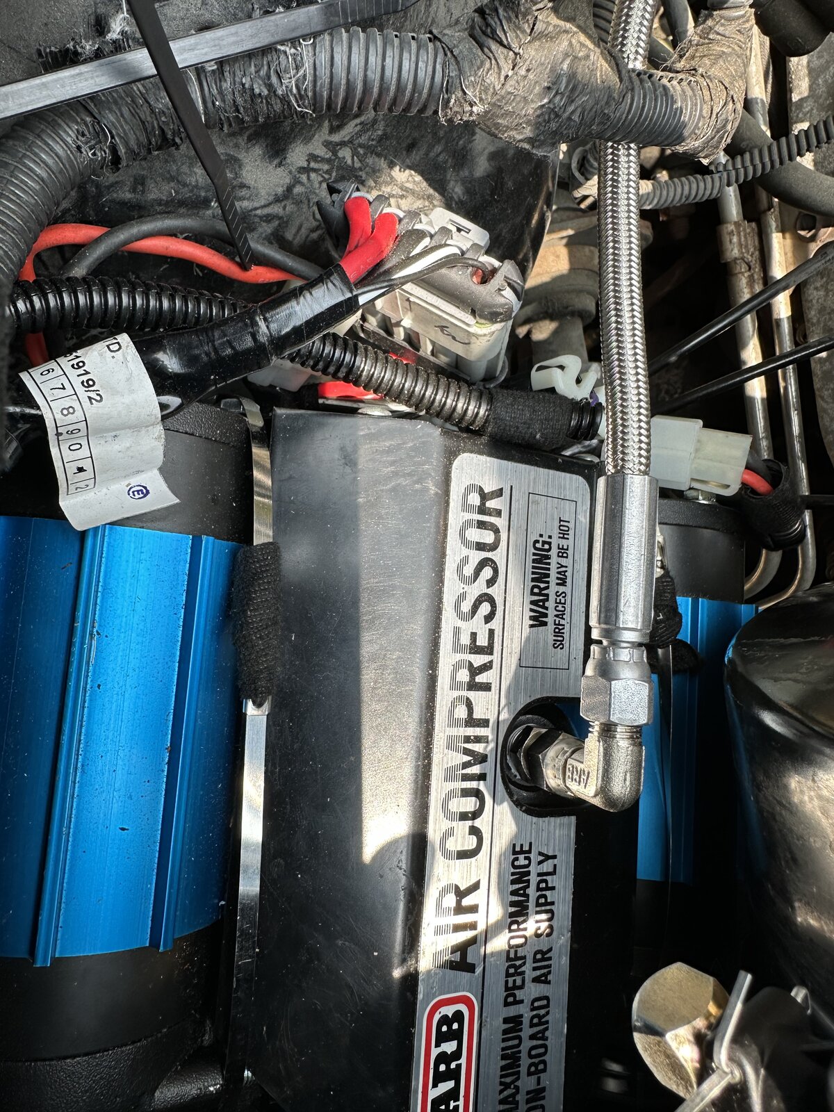

I eventually got it installed. I haven’t installed the lockers yet, so I don’t have the manifold—and have not decided where to put it.
I took seriously the suggestion that being left without a way to air up would be bad, if for some reason the compressor broke activating the lockers. (I’m not clear on how that might happen, or why it’s more likely, but I believe it’s a risk.)
Still, I don’t wheel alone, and someone else can always provide air. In the worst case, my little rechargeable compressor will (with breaks) eventually get my tires aired up enough to get me home.
I really appreciate everyone’s advice and suggestions!
Here’s a thread where I explained how I installed it. There were some unexpected issues with the tight space.
