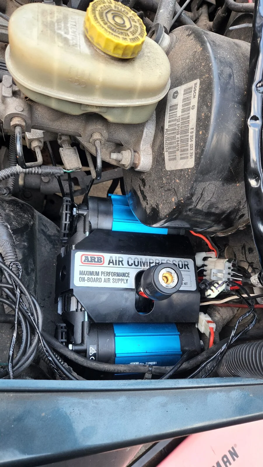

I have a CKMA12 mounted under hood by a bracket to the left of the brake booster (easier access than the tray). After using it one time to fill up one of my 33X12 tires and seeing how hot it and the air hose got I decided to never use it for tire duty again. It also was slow.

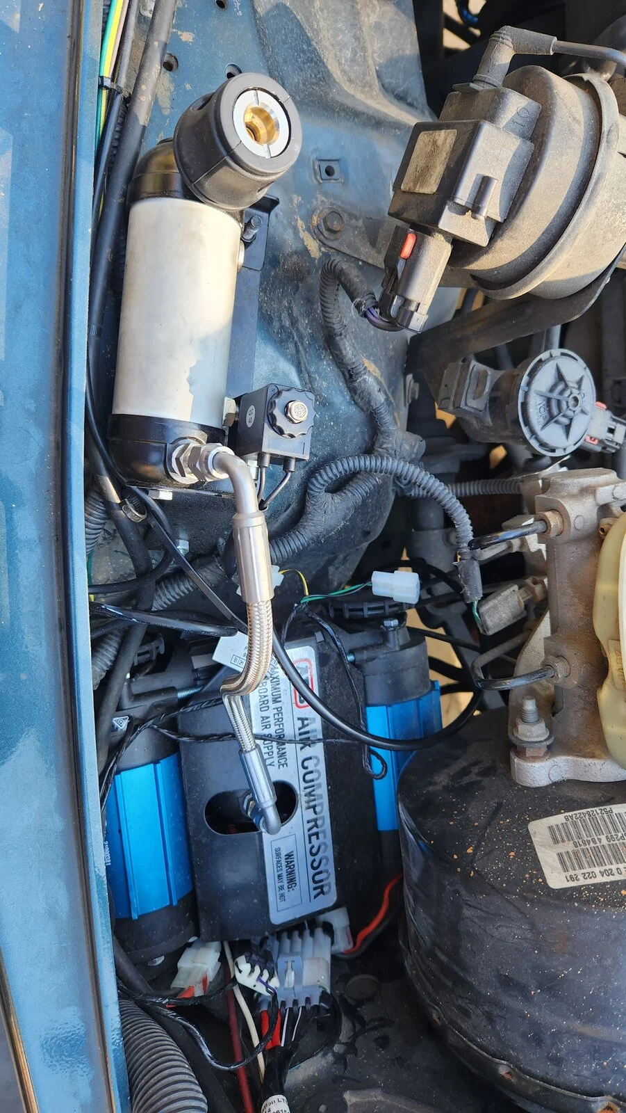

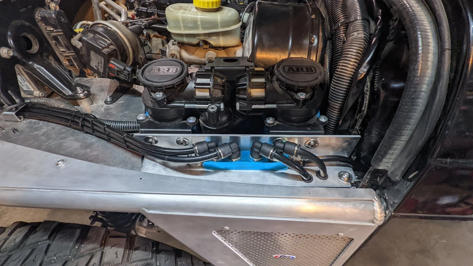

Went with the dual as it was rated to fill up the pressure i need for my RV tires. 90-100psi. Single can't swing it. Mounted to ABS area, I removed the plate for the mount.
I did the same. Removed the “ABS” tray and mounted my ARB Twin directly to the bracket…

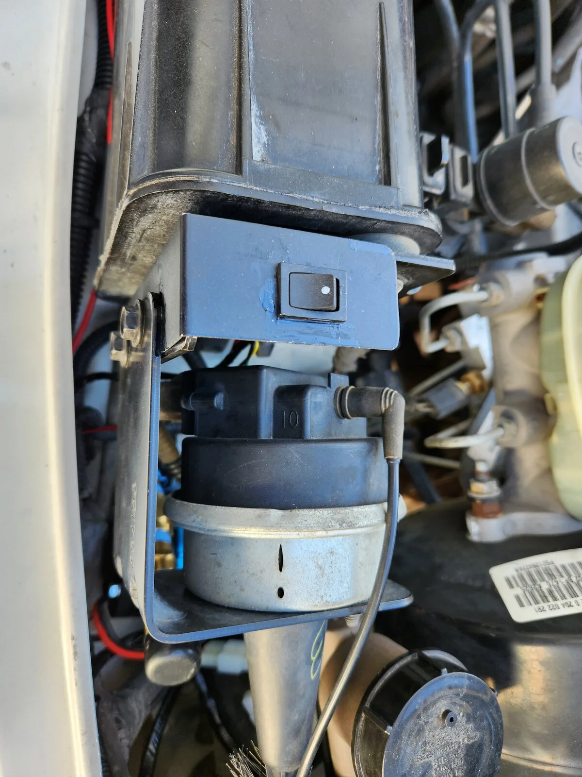

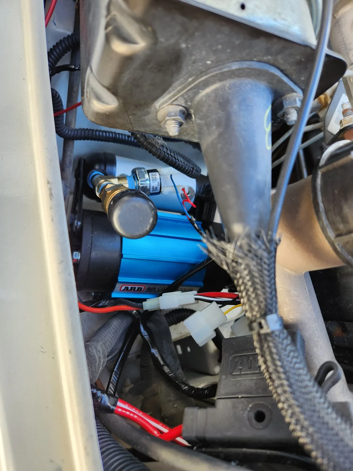

I have my little ARB locker pump mounted right on top of the driver’s side inner fender. Basically between my horns and my wiper fluid tank…

I have both, small for lockers and large for tires. When I was getting my lockers done, everyone said I was crazy to send the extra cash when I already had the dual installed. Not long after getting the new lockers the switch for my dual died on me out in JV. I was able to use my wife's compressor to air back up and had my lockers the working entire time.

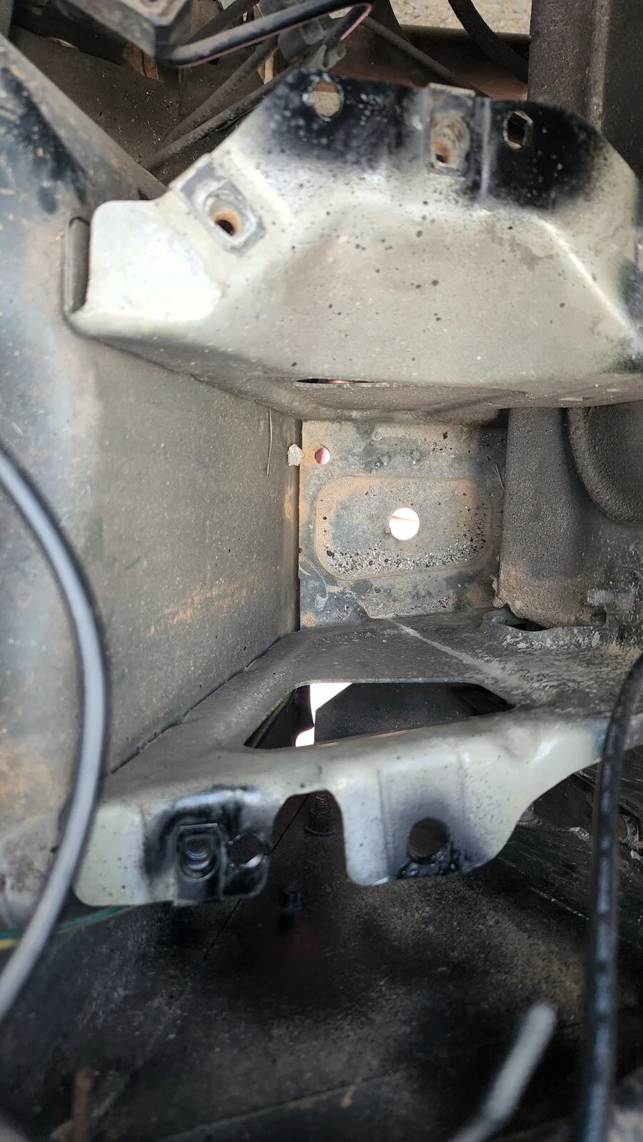

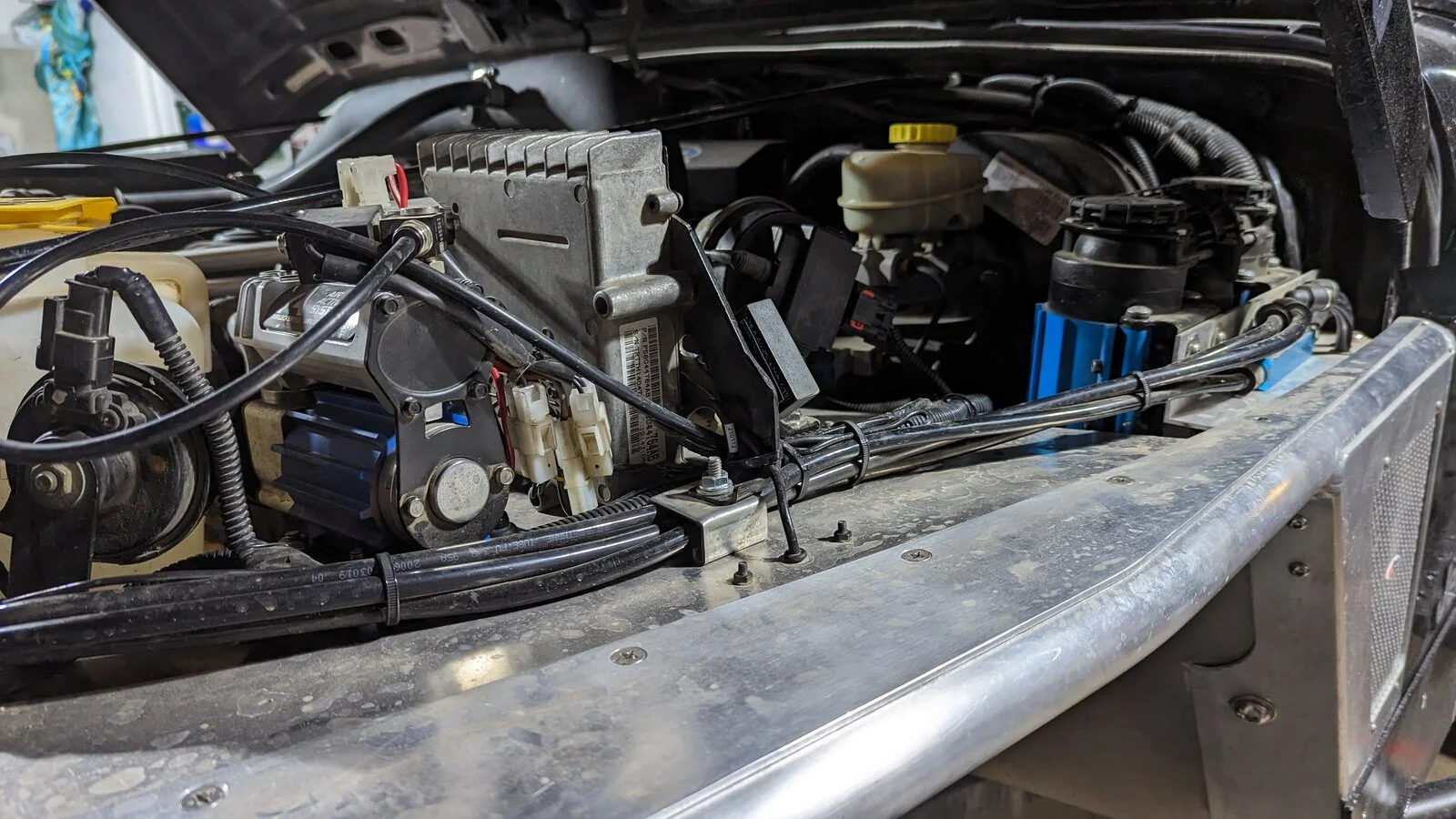

Twin fits in the spot you asked about. I used a 2 hole angle bracket attached to the fire wall, attached a piece of angle to that and ran it across and secured it to the fender.
Do (did) you have the break-fluid spout there? I don’t see it, but there seems to be a compressor where it would be.

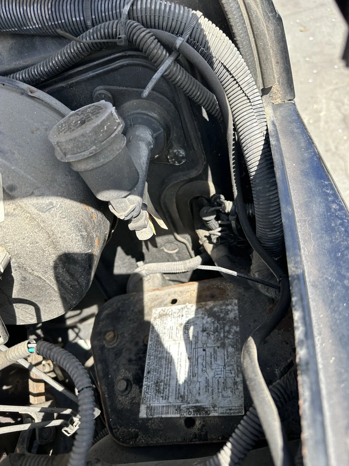

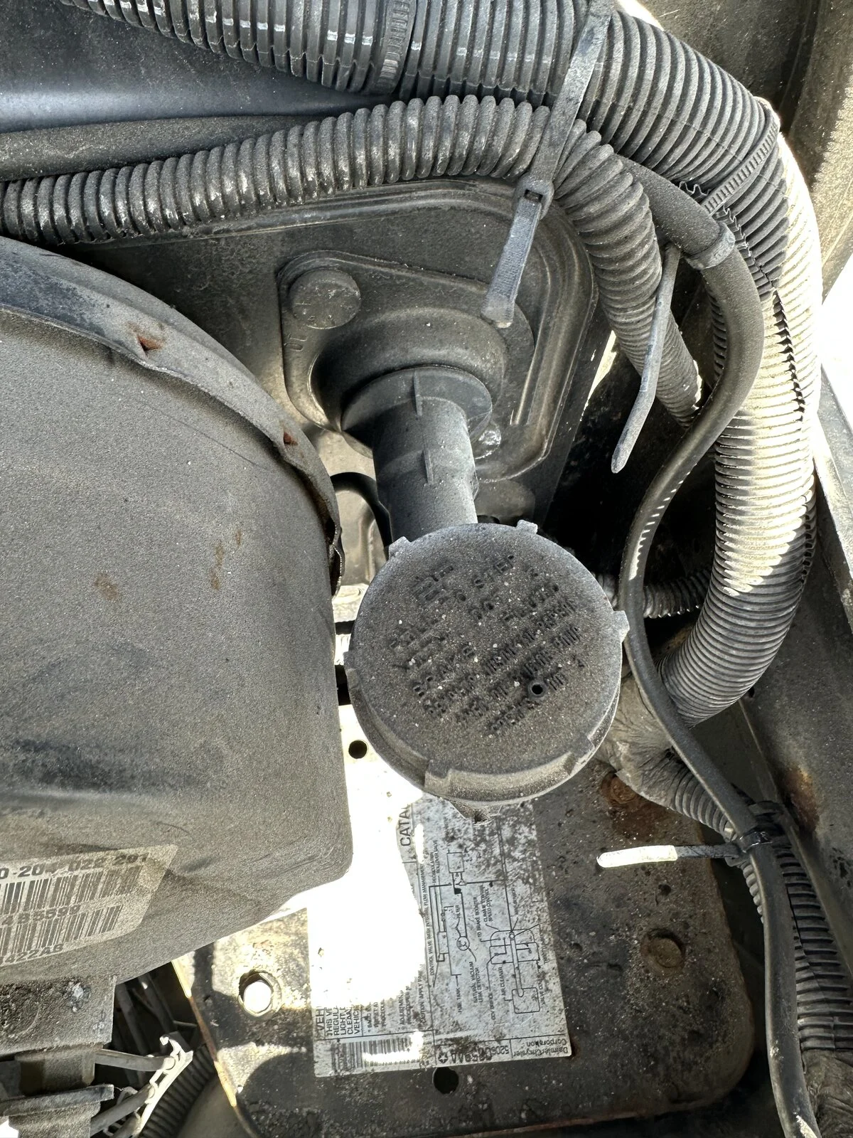

I have the manual transmission as well and now I am wondering if the single ARB will fit there.

The single seems small enough to fit a bunch of places, including on that platform, on the wheel well...

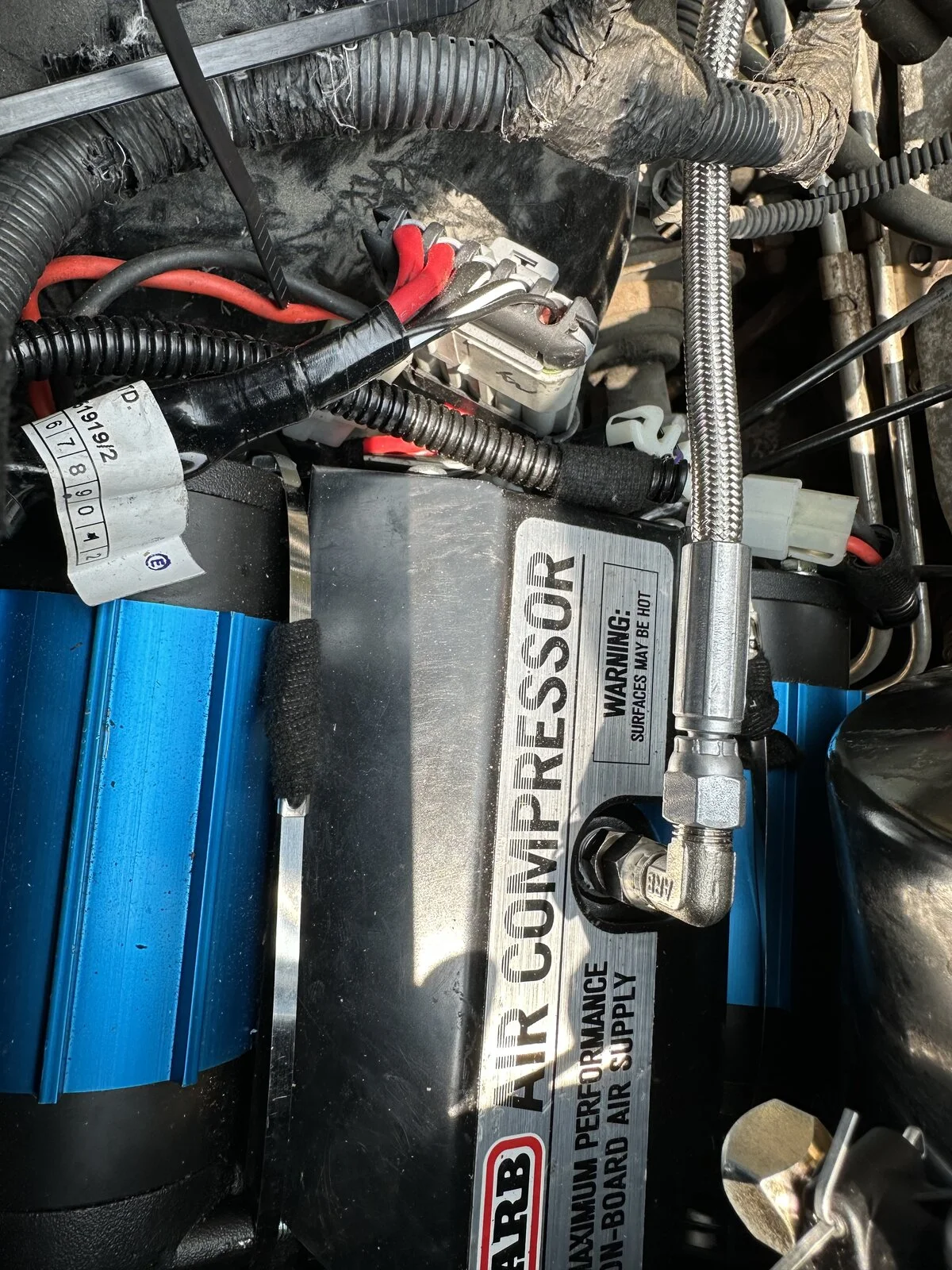

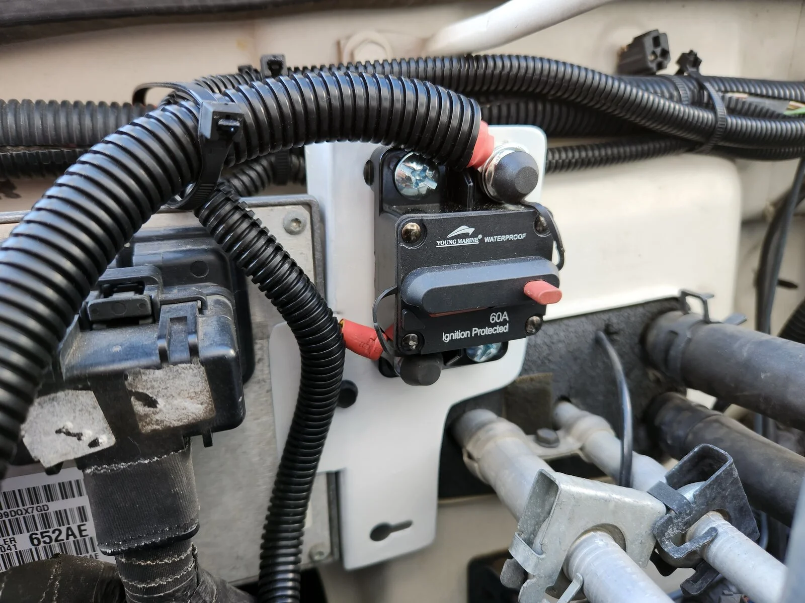

Finished my ARB single today. I ran a heavy cable to a 60 amp circuit breaker that i had to fab a bracket for, I will use that for the boat winch connector on the back as well as the compressor which also has the 40 amp inline fuse, plus the circuit breaker will protect the wire from a short circuit as that 40 amp fuse ARB provides in the harness is a good long ways from the battery. I also mounted a small rocker switch under the hood on another custom made bracket. After I was finished I let one of my 31" tires down to 14 PSI, fired the ARB and timed it. After one minute the tire was up to 24 PSI and after 2 minutes it was at 34 PSI so 10 lbs per minute is better than I had hoped for and I am very pleased. I also punched out some large faucet washers for mounting and the noise level is not nearly as loud as I expected, very happy with this compressor and it will suit my needs perfectly.

I eventually got it installed. I haven’t installed the lockers yet, so I don’t have the manifold—and have not decided where to put it.
