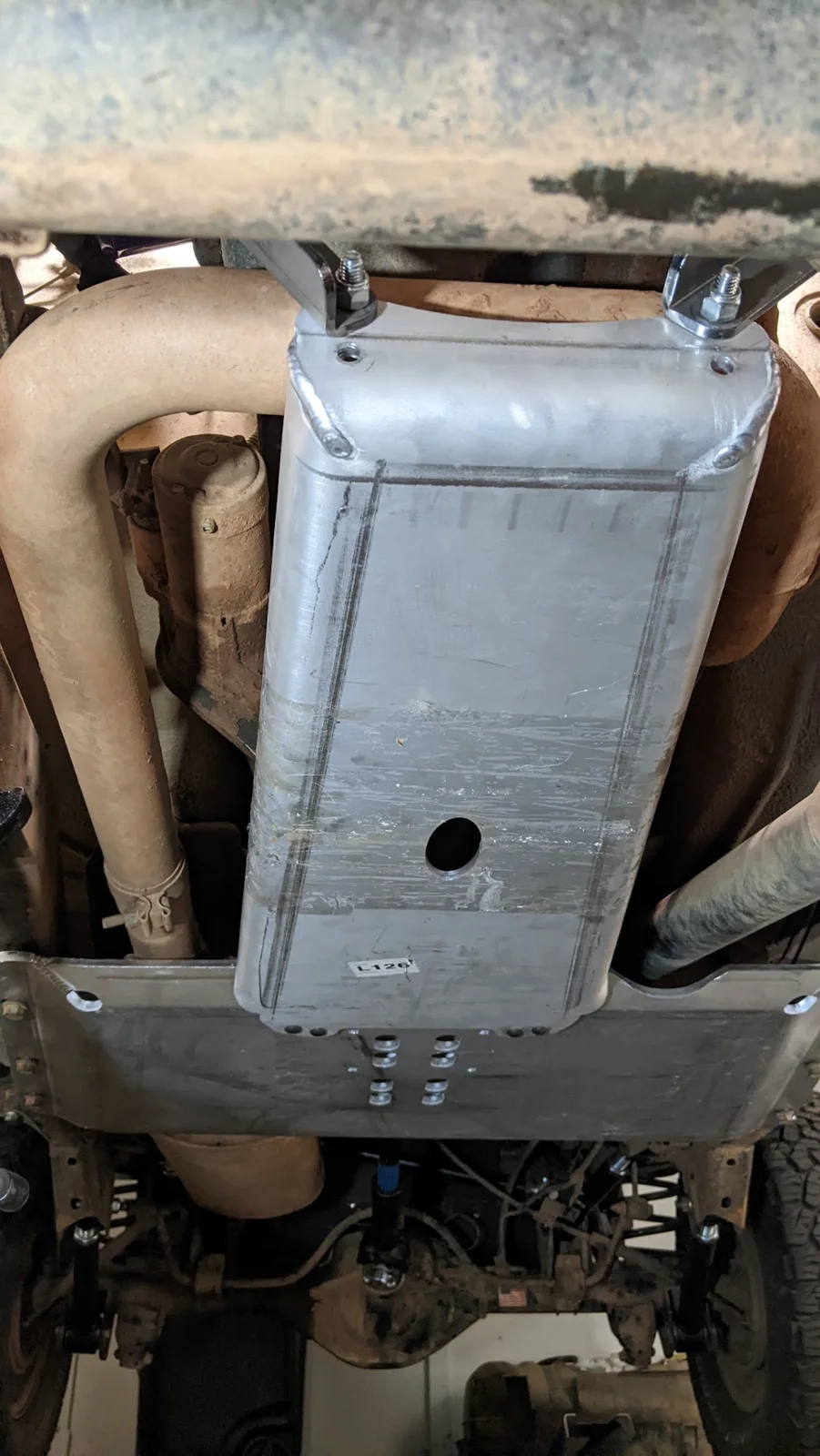

Got the engine skid in today. Getting exhaust interference with it on the higher clearance holes to the struts so I might want to figure that out eventually.
I see some people paint theirs... I can't even be bothered to remove the packing tape residue lol. It's just a skid plate anyways and won't rust.

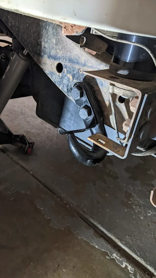

Not much done today, got rear tow hooks installed on both sides.
