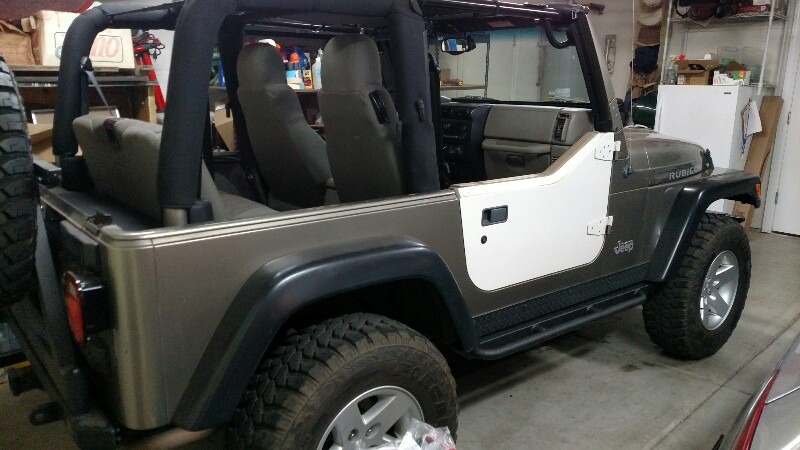

Haven't started yet. Weather has been bad and had some family emergencies. Hoping to start next week.
Well, I have officially nixed the idea of having these painted at the paint shop. The guy I would have them painted by gave me a quote of $450 labor, and I have to supply the paint. If I cannot do this myself, they go up for sale. I look forward to seeing your results.
The hinges I painted came out ok color-wise, just not as smooth as the rest of the Jeep. Not being well-versed in auto painting, I think it's a matter of wet sanding to achieve the correct sheen, but I'm not sure on that.
Reactions: CodaMan
...The hinges I painted came out ok color-wise, just not as smooth as the rest of the Jeep. Not being well-versed in auto painting, I think it's a matter of wet sanding to achieve the correct sheen, but I'm not sure on that.
Did you buff them out?
I never did, no. They are mounted on the Jeep, and there's not a lot of surface area to get a buffer on, unless the buffer was pretty small. I'm open to ideas.

I too have been hanging out on the YouTube paint videos. I don't think this will be a big deal to get close. Like I said, the hinges I painted came out just right, color-wise, just not as shiny as the rest of the paint around the windshield area. You have to look pretty close to tell.
A larger item like a half door, on the other hand, should be easier to sand/buff after the paint application, in order to get the right finish. If they are not perfect, who really cares? They are summer doors, and on and off at that. As long as the color matches, great. I could also paint them a semi-gloss black, similar to the bumpers and mirrors, but I think that might look somewhat goofy.

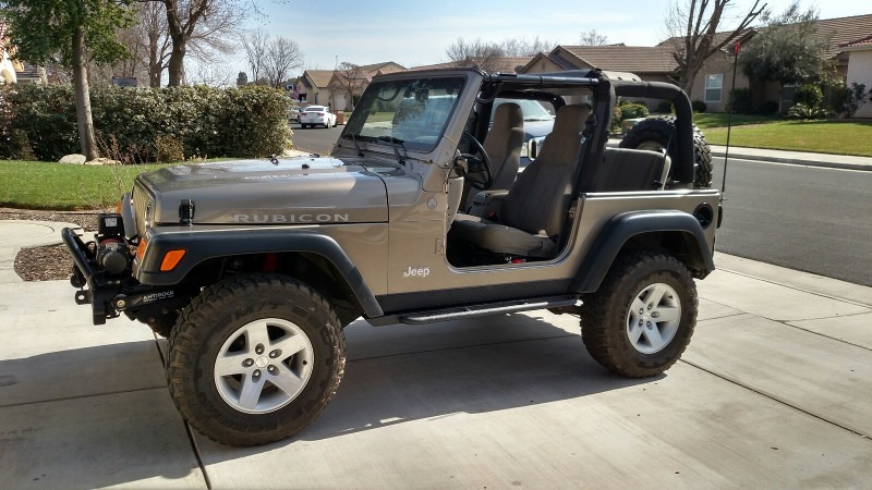

I get a lot of members asking for details on my lift, so I thought it appropriate to provide the information on it here, along with some gratuitous photos of course ;)
Parts I used in my lift (approx. $550 for everything listed):
1) Pro Comp 2" Springs (Front) — EXP55297
2) Pro Comp 2" Springs (Rear) — EXP55298
3) Rancho RS5000X Shocks (2 Front) — RS55239
4) Rancho RS5000X Shocks (2 Rear) — RS55241
5) OME Rear Track Bar Reloaction Bracket — ARB FKWTJ02
6) Daystar.75" Spacers — KJ09108BK (note: only used above front springs for leveling)
7) Rock Krawler Bump Stop Extensions (Front and Rear) --RKSRK05611 (note: Comes with 6 1" extensions. Glue or bolt 1 to each spring bucket at the bottom of the front springs; I used this RTV Adhesive and it worked great. Then bolt 1 above each bump stop cup on rear springs)
Here are top on/top off photos to get a perspective of it with 265/75R16 tires (basically 32's):
May I ask, did you consider 3" springs? and how did you settle on 2"?
I'm considering buying my lift in parts like you did but still learning here
I did, but since I don't ever plan on regearing to run 35s I could go with a 2" lift and add a 1" body lift if I want 33s. Plus, once you go 3" you have to add adjustable track bars and probably some adjustable control arms to fix pinion angles which will double the cost of the lift. So it was a "what do I do with the Jeep and what mods are required to do those things"

With this lift, did you keep the stock control arms and front track bar? I've got different springs than you, otherwise, I'll be doing about the same lift to my Rubicon. It seems like I can find guys here that have left these stock and others that went adjustable control arms and track bars with the 2" lift.
I kept the control arms and front track bar stock and everything has been just right.
