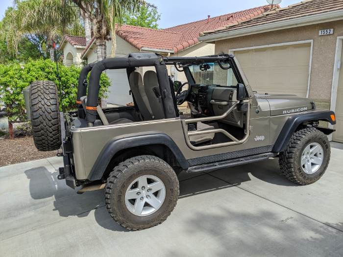

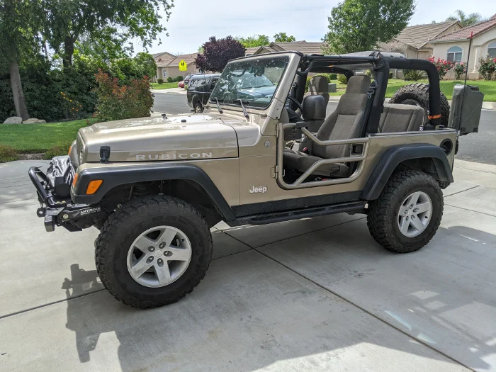

I get a lot of members asking for details on my lift, so I thought it appropriate to provide the information on it here, along with some gratuitous photos of course ;)
Parts I used in my lift (approx. $550 for everything listed):
1) Pro Comp 2" Springs (Front) — EXP55297
2) Pro Comp 2" Springs (Rear) — EXP55298
3) Rancho RS5000X Shocks (2 Front) — RS55239
4) Rancho RS5000X Shocks (2 Rear) — RS55241
5) OME Rear Track Bar Reloaction Bracket — ARB FKWTJ02
6) Daystar.75" Spacers — KJ09108BK (note: only used above front springs for leveling)
7) Rock Krawler Bump Stop Extensions (Front and Rear) --RKSRK05611 (note: Comes with 6 1" extensions. Glue or bolt 1 to each spring bucket at the bottom of the front springs; I used this RTV Adhesive and it worked great. Then bolt 1 above each bump stop cup on rear springs)
Here are top on/top off photos to get a perspective of it with 265/75R16 tires (basically 32's):

I noticed that you keep referring to your Jeep as having a 2.5" lift, but your part numbers list 2" coils. Did the Pro-Comp 2" springs give you 2.5"? Or am I missing something?

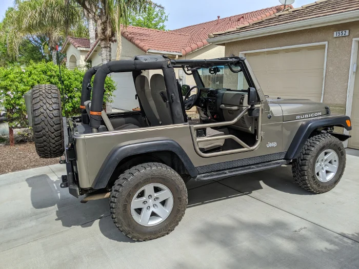

Parts I used in my lift (approx. $600 for everything listed):
Lift looks great. Did you have to adjust the transfer case linkage or bracket?
Parts I used in my roughly 2.5" lift (approx. $600 for everything listed):
Rancho shocks tend to run long. Depending on your bump stop setup you can run either the 0-1" shocks or the 2-3" shocks.
1) Rancho RS5000X Shocks 0-1" (2 Front) — RS55128
2) Rancho RS5000X Shocks 0-1" (2 Rear) — RS55240
3) Rancho RS5000X Shocks 2-3" (2 Front) — RS55239
4) Rancho RS5000X Shocks 2-3" (2 Rear) — RS55241
5) Pro Comp 2" Springs (Front) — EXP55297
6) Pro Comp 2" Springs (Rear) — EXP55298
7) OME Rear Track Bar Reloaction Bracket — ARB FKWTJ02
8) Rokmen 1/2" body lift
9) Daystar.75" Spacers — KJ09108BK (note: only used above front springs for leveling)
10) Rock Krawler Bump Stop Extensions (Front and Rear) --RKSRK05611 (note: Comes with 6 1" extensions. Glue or bolt 1 to each spring bucket at the bottom of the front springs; I used this RTV Adhesive and it worked great. Then bolt 1 above each bump stop cup on rear springs)

You do not need the body lift. I installed it for a future tummy tuck.

I would suggest going with the 0-2" shock choice. You'll need at minimum 1.5" of added bump stop to keep the 55239/55241 shocks from bottoming out at full stuff.

How far off center is your front axle? Are you experiencing any rubbing when flexed? When I was at 2.5" of lift, my front axle was off center by 5/8" I ran it that way for a few years until my stock TB took a shit, then upgraded to a JKS bar. My tire inner sidewall would rub a little during offroad flexing.
Are you running the 55239's up front?
Did you do a SYE?? Just curious....
My current Jeep is a Rubicon so it wasn't needed, but I've done this same lift on 2 different jeeps of mine. The first one was a Sahara and it didn't need an SYE, nor did it need the TC lowered at all. An SYE won't be needed for this lift setup.
