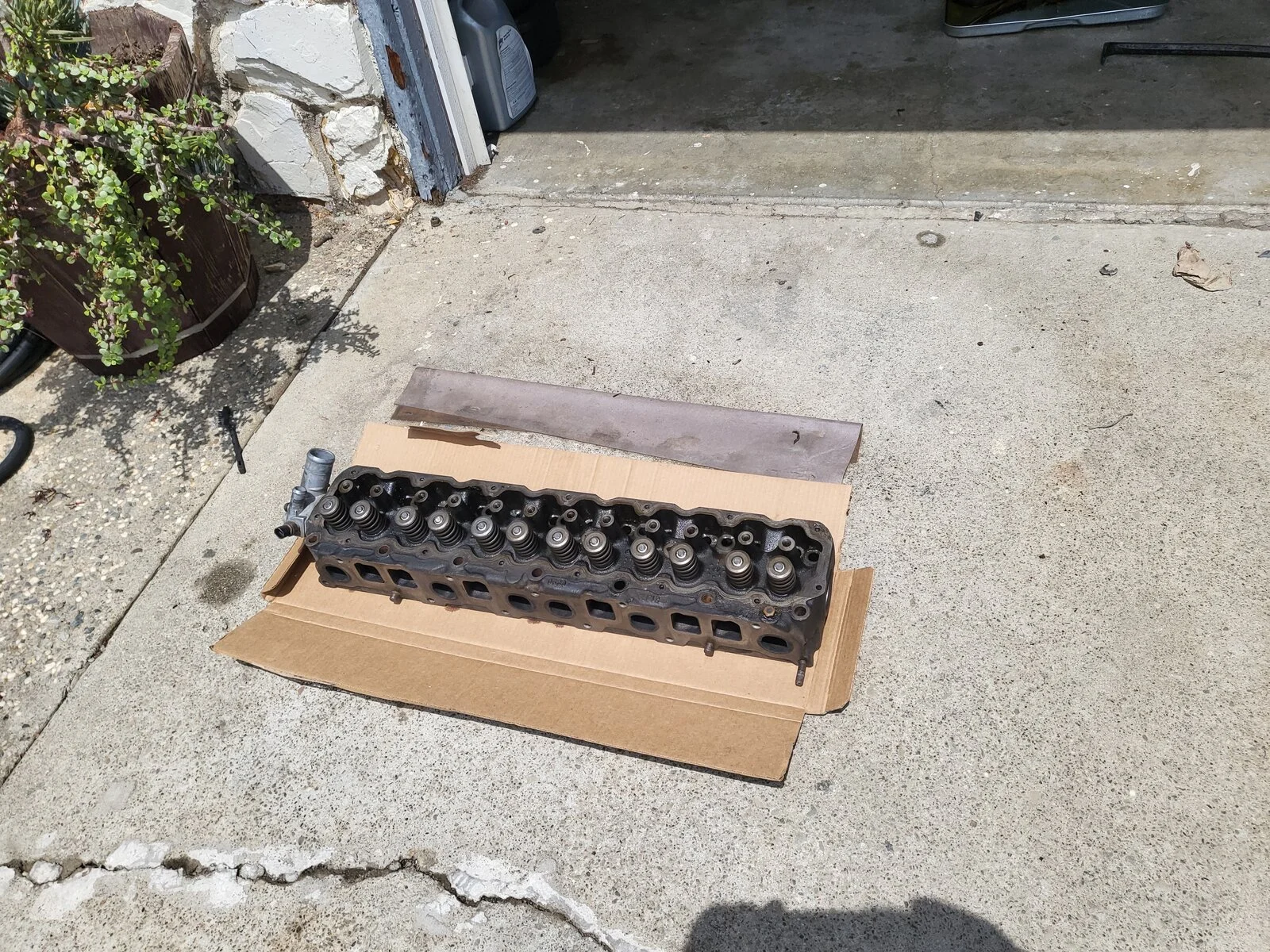

Well God works in mysterious ways. I just got a call from work saying I was exposed to COVID and need to stay home until Wednesday. And I found a junkyard head for $175 I can swap in. Hopefully I will be able to get everything installed by Wednesday and not lose any time getting ready for the trip.

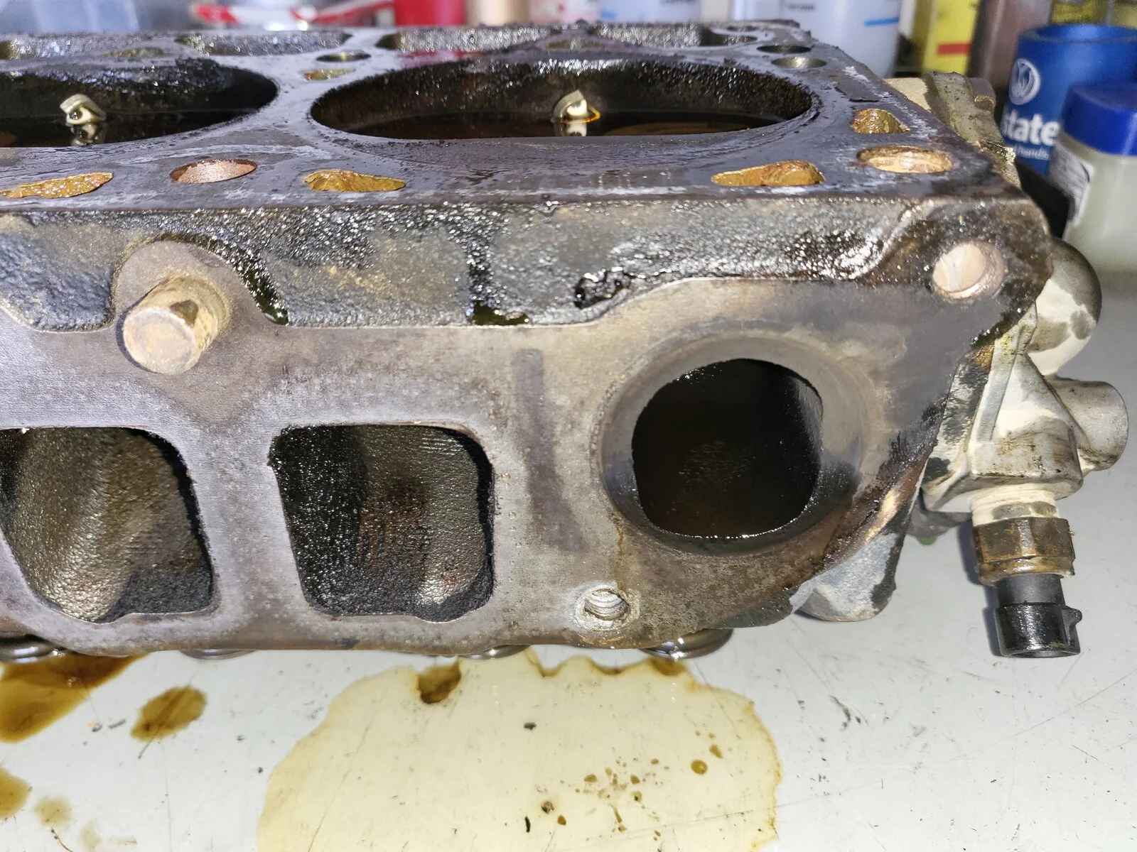

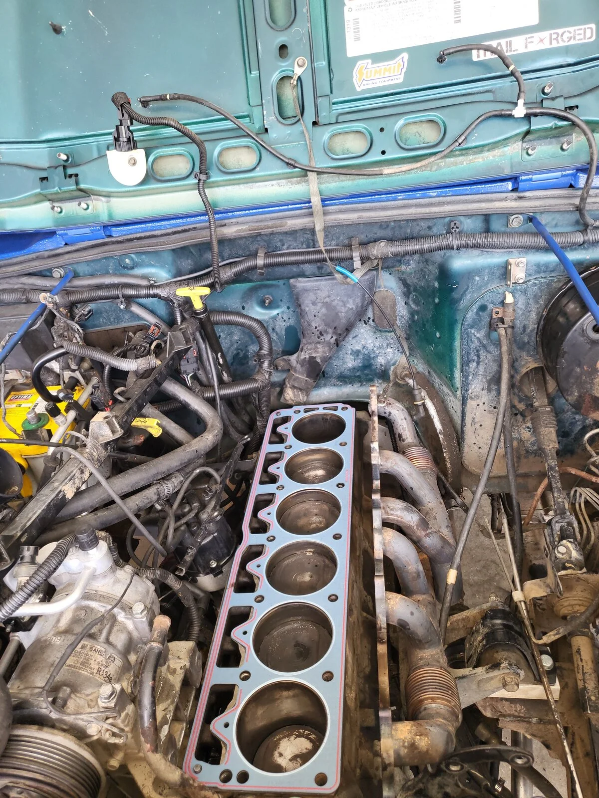

Well I am about to pull the head off. I picked up a head gasket kit and it comes with valve seals so my first goal is to inspect the head and see if I can just give her a quick rebuild. I have a granite inspection surface and some good straight edges to check for flatness. Hopefully I can just lap the valve seats and get away with a quick rebuild.

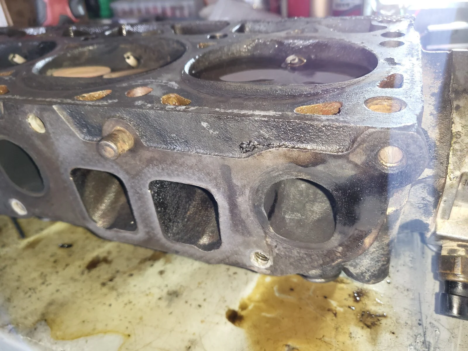

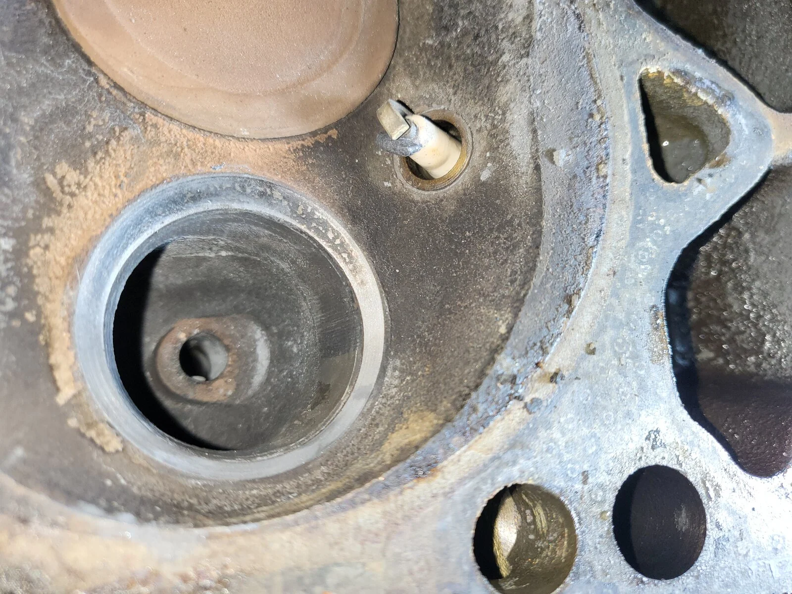

Well I found the problem. The exhaust vavle isn't sealing properly.
(you can see the far right port is wet inside from the brake fluid seeping past the valve) Looks like it was a MFG error. The exhaust valve seat was cut slightly off and there was a ridge on the lower part of the valve seat preventing a proper seal. (You can kind of see it on the left side of the seat) I have no idea how this thing didn't have issues sooner.
I ended up taking a dremel to the lip and then relapping the valve. Looks like we are getting a good seal now!!
I will go ahead and lap the rest of the valves and
I should have her all buttoned up tomorrow and will be back in business!!
