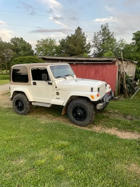

Let me start out by saying you guys know way more about the TJ than I could hope to ever know. Many of you seem very capable when modifying or repairing your Jeeps. I am just starting to learn.
I bought a decent 2001 Sahara with an automatic and the 4.0. I just want it for exploring the gravel and back roads of Arkansas. It will spend a lot of time on pavement, and very little on an interstate. I am not trying to build an off road or rock climber. I simply always wanted a Jeep. I wish I would have bought a brand new one back in the day and kept it in good working order. Could of, would of, should of. A new one today does not appeal to me.
I wanted to ask if you might take some time and help me prioritize my attack plan. I will not be doing most of the work. I will do what I can. I have a good mechanic lined up. I don't want to break the bank, but I'd like to see the old gal back in shape.
Here is what she looks like. I got her May 26, 2022. She shows 152,803 miles.

Looks like a good baseline to start on, and not terribly molested. I'd say first off, determine what lift, if any, it has.
Take some pics of the springs, especially the top/bottom perches that the spring ride in. Then measure the springs at ride height on level ground. Lets see pics of shocks and steering components. The wheels/tires will need to go for something a bit more period correct and sized for the lift you have.
General maintenance is key. Get all the fluids changed, tuned up and cooling system flush/refresh.

The paper work that came with the Jeep show a 2" lift with BFG LT275 7017 tires.
Okay so that’s about a 32.2” x 11” on 17” wheels. I’d find out if that’s a 2” body lift or suspension lift.
Those tires are starting to look pretty stuffed in there, I’d either drop tire size a bit or lift it a bit more.
2.5-3” lift is recommended for 32’s.
