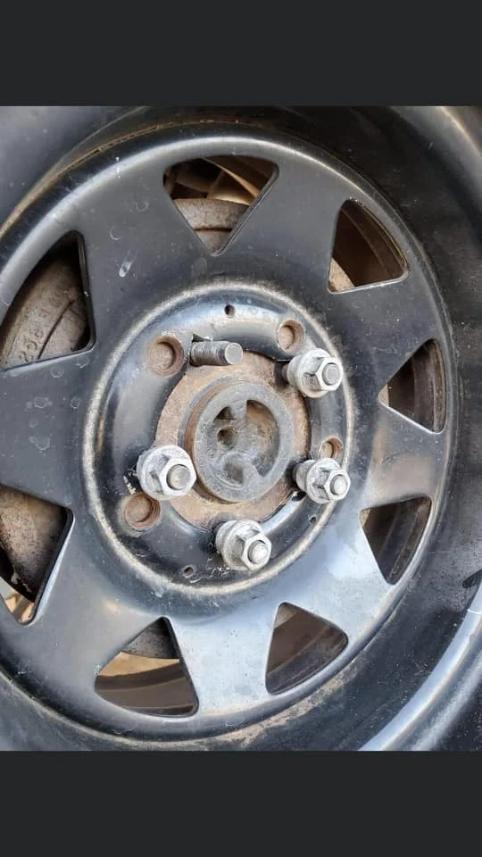

To add fuel to the debate...or...What could go wrong?
  • Wow
Reactions: Zorba and Matt131
