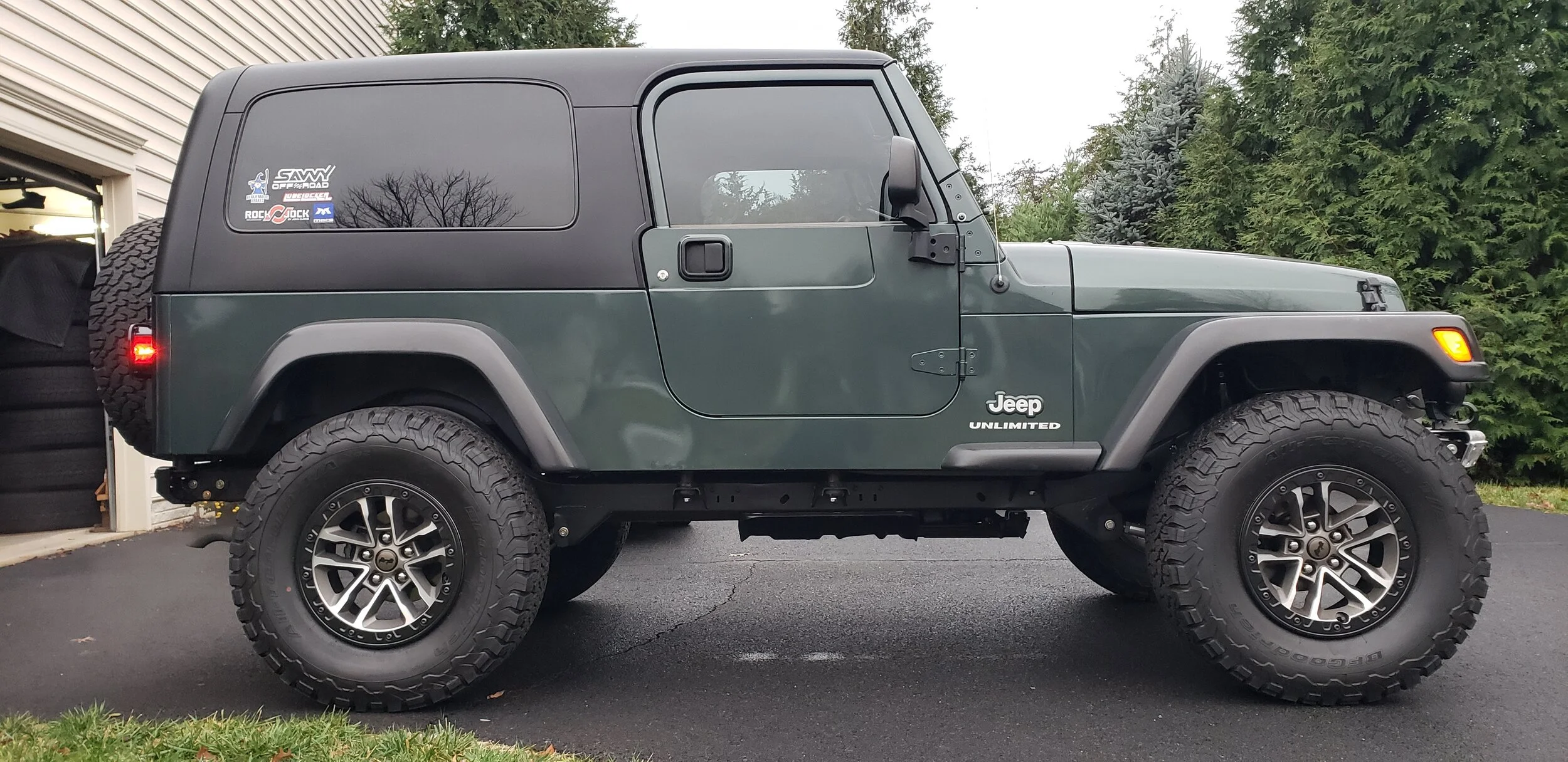

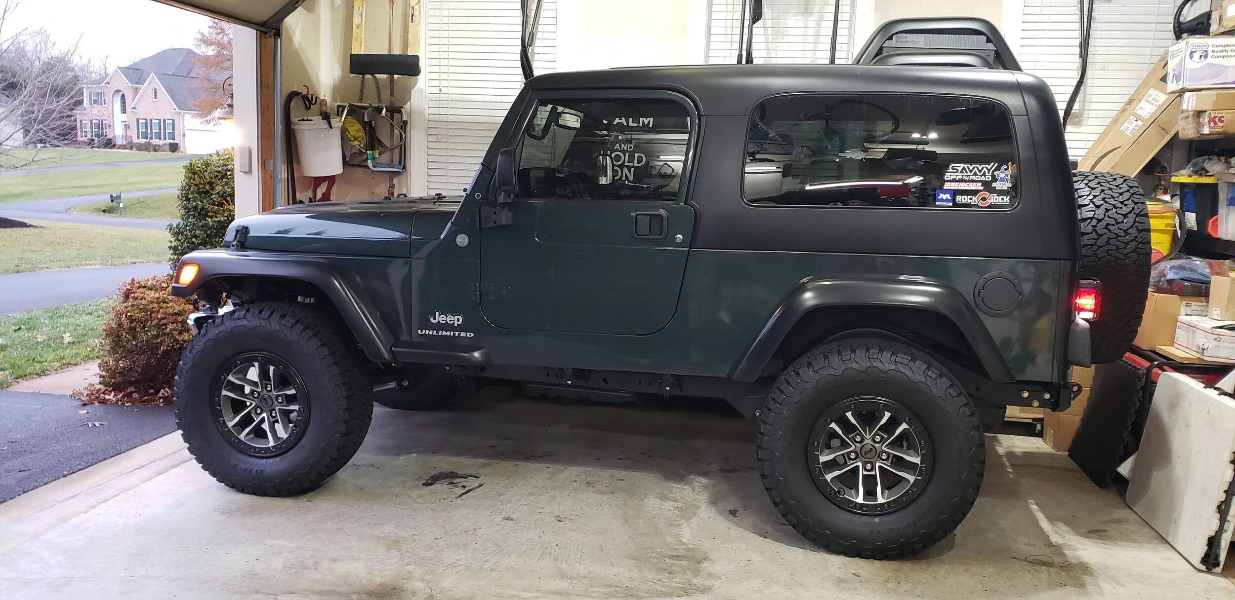

I finally had a chance to catch up on the build and things are going well. My interim plan was to run 35s and build to a 10" travel shock (12" is the desired end state, but that will come later). I'm close to my target and here's what the numbers look like so far:
Springs: Rock Jock
- Front - CE 9133F (3") with a StreetRays 1" aluminum spacer
- Rear - CE 9131RH1P (3")
Shocks: BlackMax

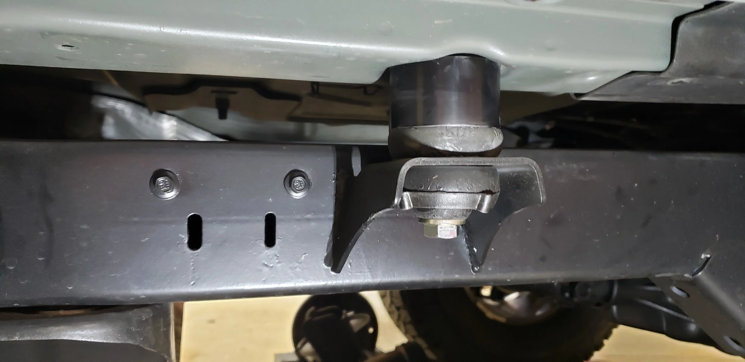

- Front - B8556CS Black Max 9.78 Travel - 5.5" Up and 4.28 Down - This is mated with 2" bump stop, which limits up travel to 5"

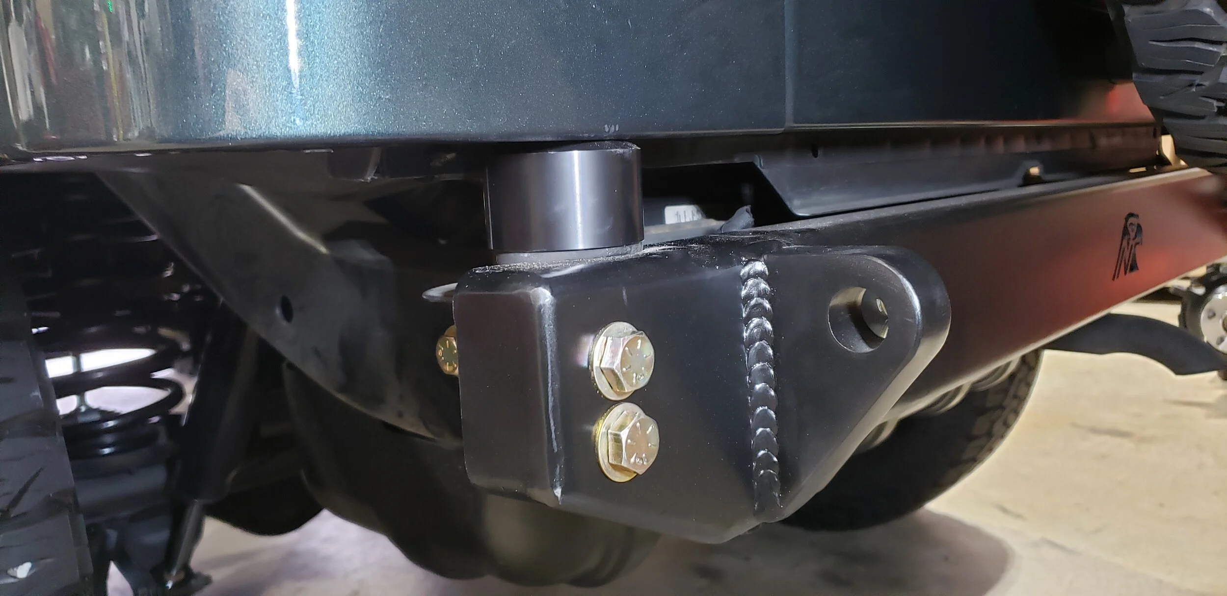

- Rear - B8518CS Black Max 9" Travel - Travel is split even at 4.5" up and down - This is possible due to a Teraflex (#1244800) Bar Pin Eliminator adapter. The rear is bump stopped at 1.5".
Overall, I have 6" up travel before the tires are into the fender flares. I've cycled the suspension and although the front tires get into the Swayloc slightly, this won't be a problem once I move the front wheels out a little more.

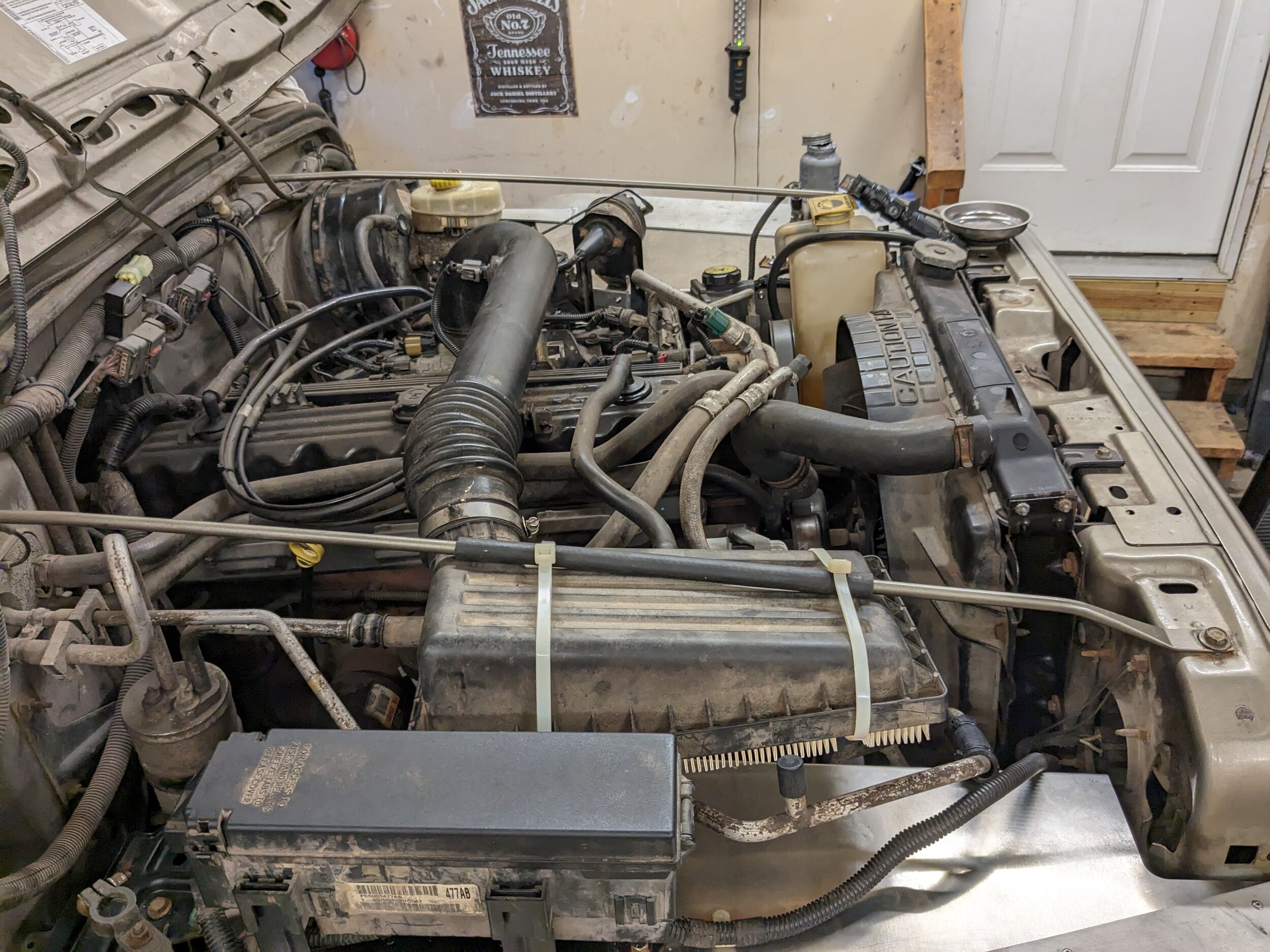

My understanding is the GenRight inner fenders don't work with the stock airbox.
At some point the butt crack will be fixed! (y)
Correct - It won't fit.

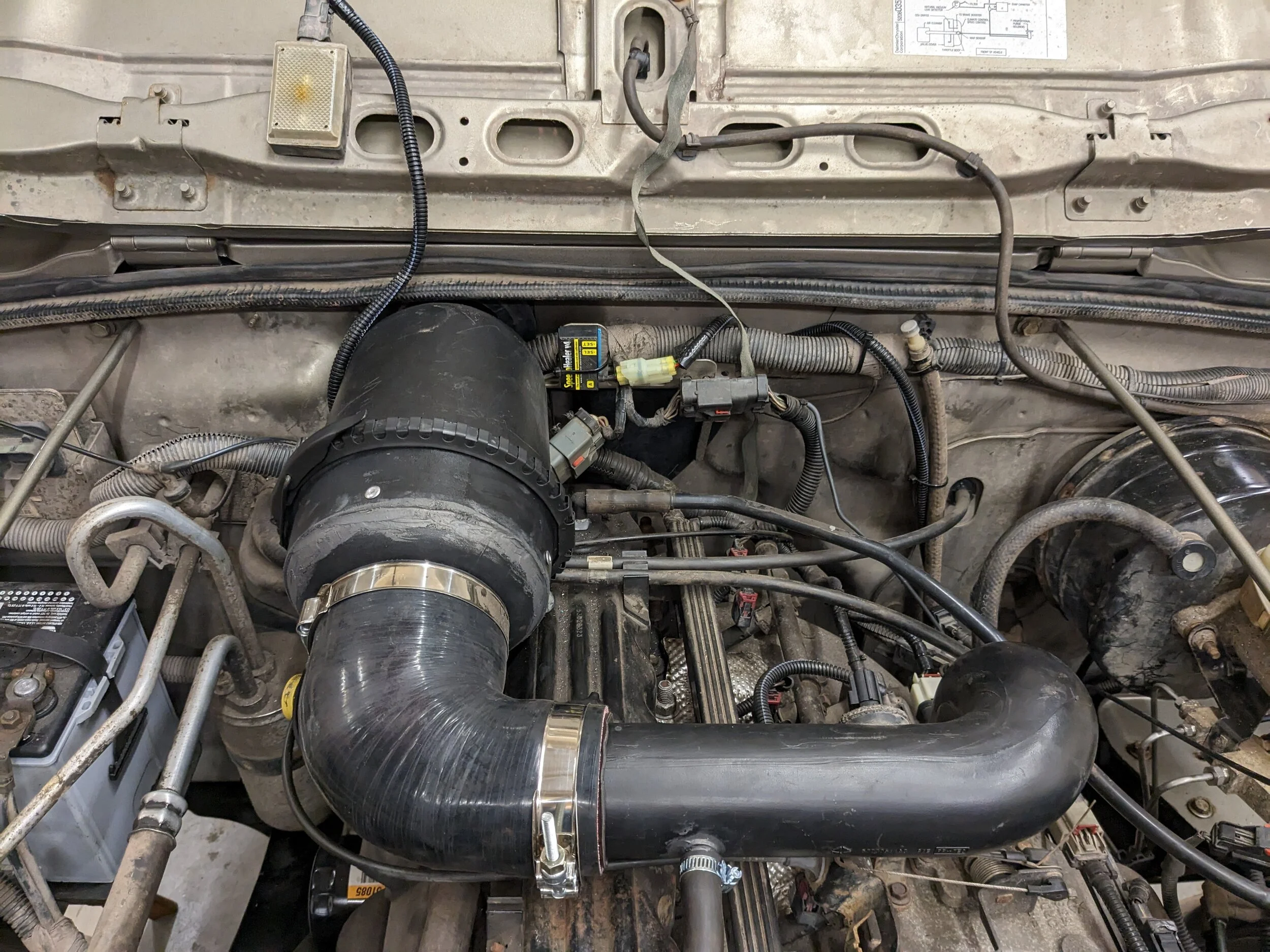

I went with the popular Ford Windstar upgrade. Here is my latest (still some brackets to be added for stability):
Many have done this Windstar mod. You can see more of my pics in my build. It's a better option than cold air, if you drive in water/mud. Otherwise a CAI is a good/easier option.
I did this to get the Jeep driving and to pass inspection.
But you can see there isn't room for the OEM air box.

Correction: There is a post here on the forum that you can fit an OEM box but you'll cut about 60% of it apart at the bottom of the box - So just go CAI at that point (from my perspective....).
I've done the Windstar modification in the past. I'm considering that, along with the Buick air box.
Springs: Rock Jock
Shocks: BlackMax
I am running the same springs part numbers front and rear on my LJR.
Used 2” streetRays spring spacers in the front along with front JK B8575 shocks and a 2” bumpstops. It worked better for me than the longer TJ b8549 or the shorter TJ b8525
Installed B8528 rear shocks with 2” bumpstops.
Ah, I missed the inners. I was able to re-use the stock inners and keep the stock air box.
