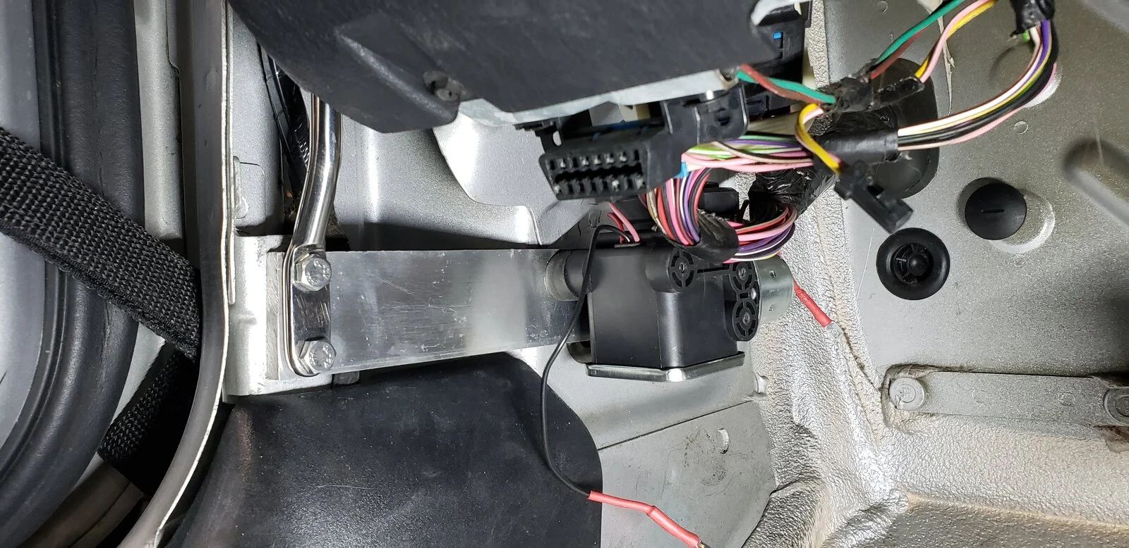

Here are the switches mounted in my TJ. I also made a bracket out of aluminum and mounted the pumps inside the cabin. The door strap hook bolts made an ideal spot.
20210605_175211-jpg.257273
That’s starting to look like a cockpit! Looks great. Nice bracket for the locker pumps. Good idea for my son. I really don’t like them on the TCase Skid.

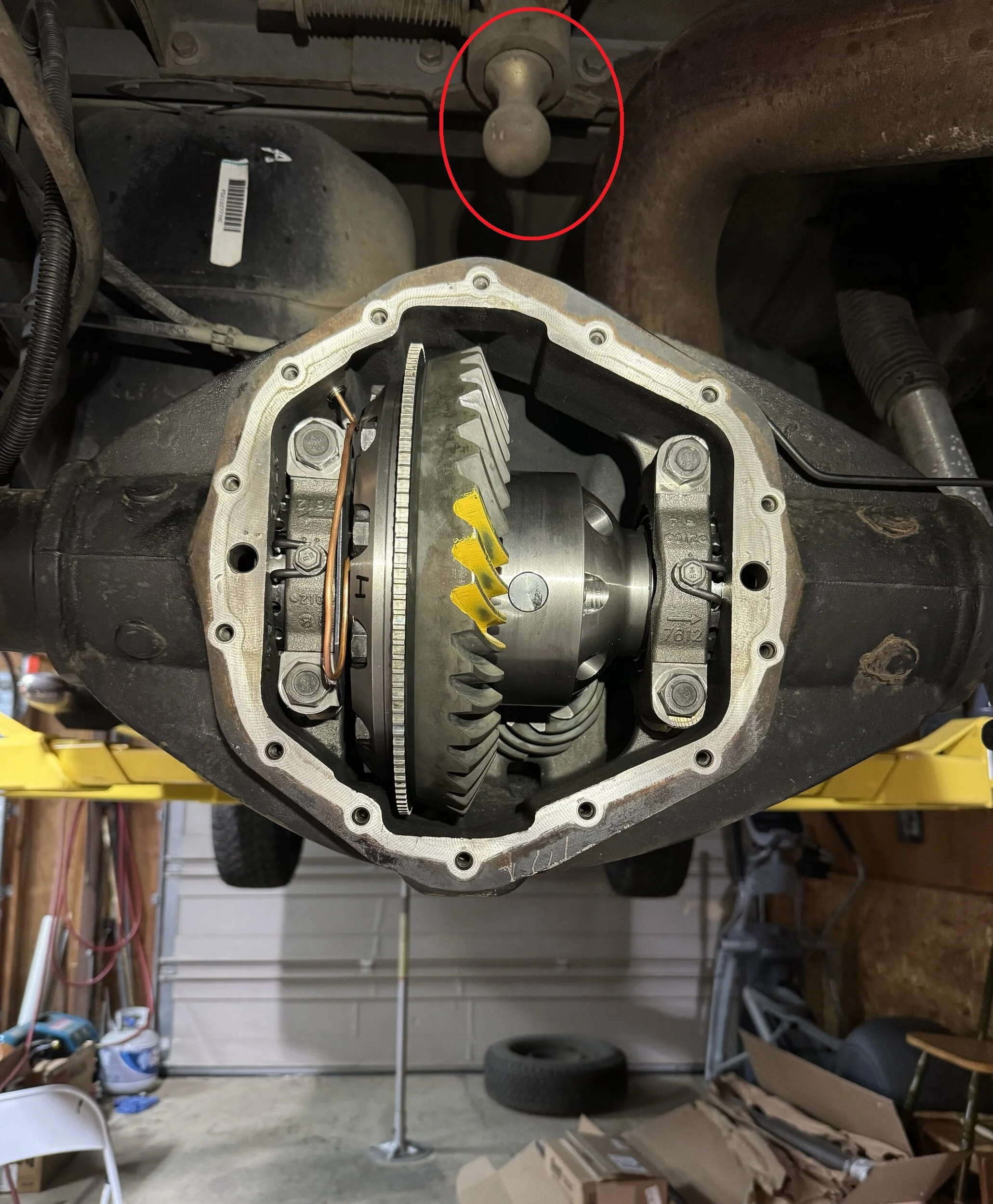

I like to learn about cars - I know you said this in your tow rig. But help my head understand why there is a tow hitch under the vehicle?
Is this a 'flip-able' 5th wheel? (I've not dealt with 5th wheels before... So sorry if this is a really dumb question)
It's a turnover gooseneck hitch ball. Most pickups with a gooseneck hitch installed are turnover type so when not in use you can turn the ball over so you have a flat bed to load things onto. The best IMO is made by B&W and I've had 4 of their hitches installed in my past trucks.
If you look you can see a spring next to the base of the ball on the left side. This is for a lever you pull to release the ball so you can grab it and turn it over. Once back in place you release the leaver and it locks the ball back in place. They can be rated for up to 30K lbs.

As you guessed and @Wildman noted, it is indeed a B&W Turnover ball in the storage position.

Looking at it, I figured that's what it was. Appreciate the additional details. Never seen one in person so a new info card in the brain for me. 😉

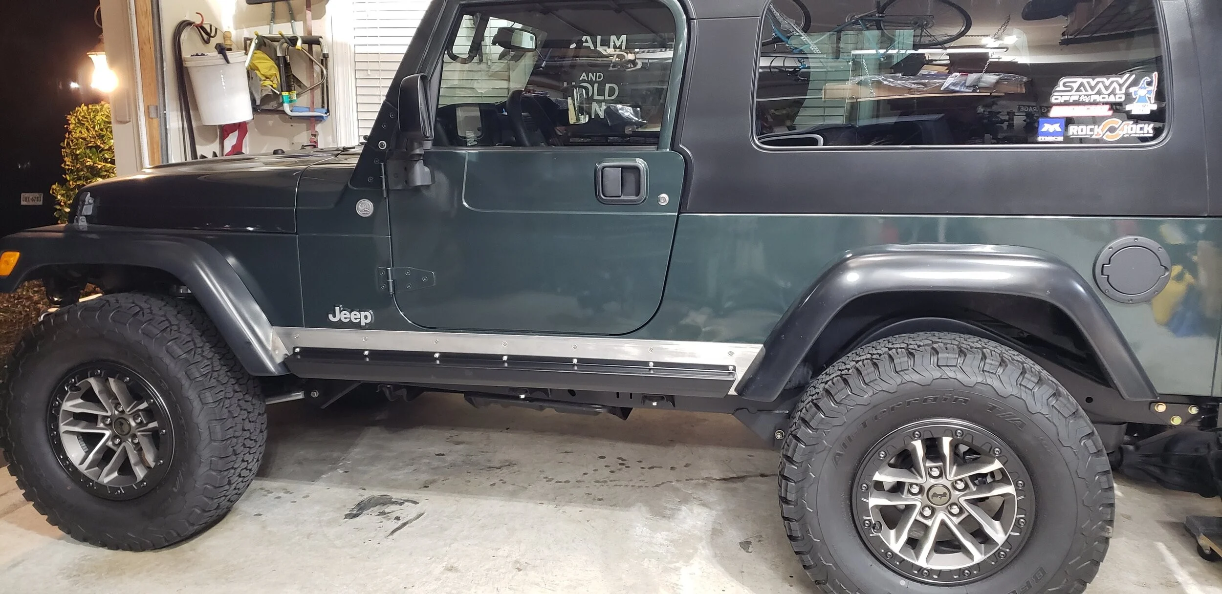

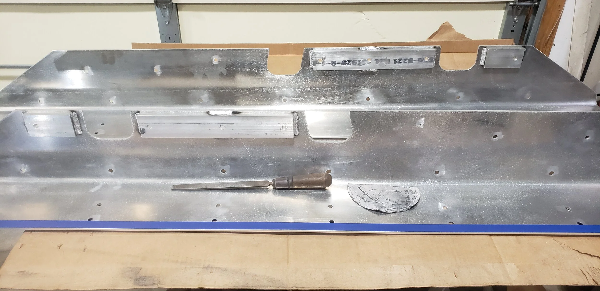

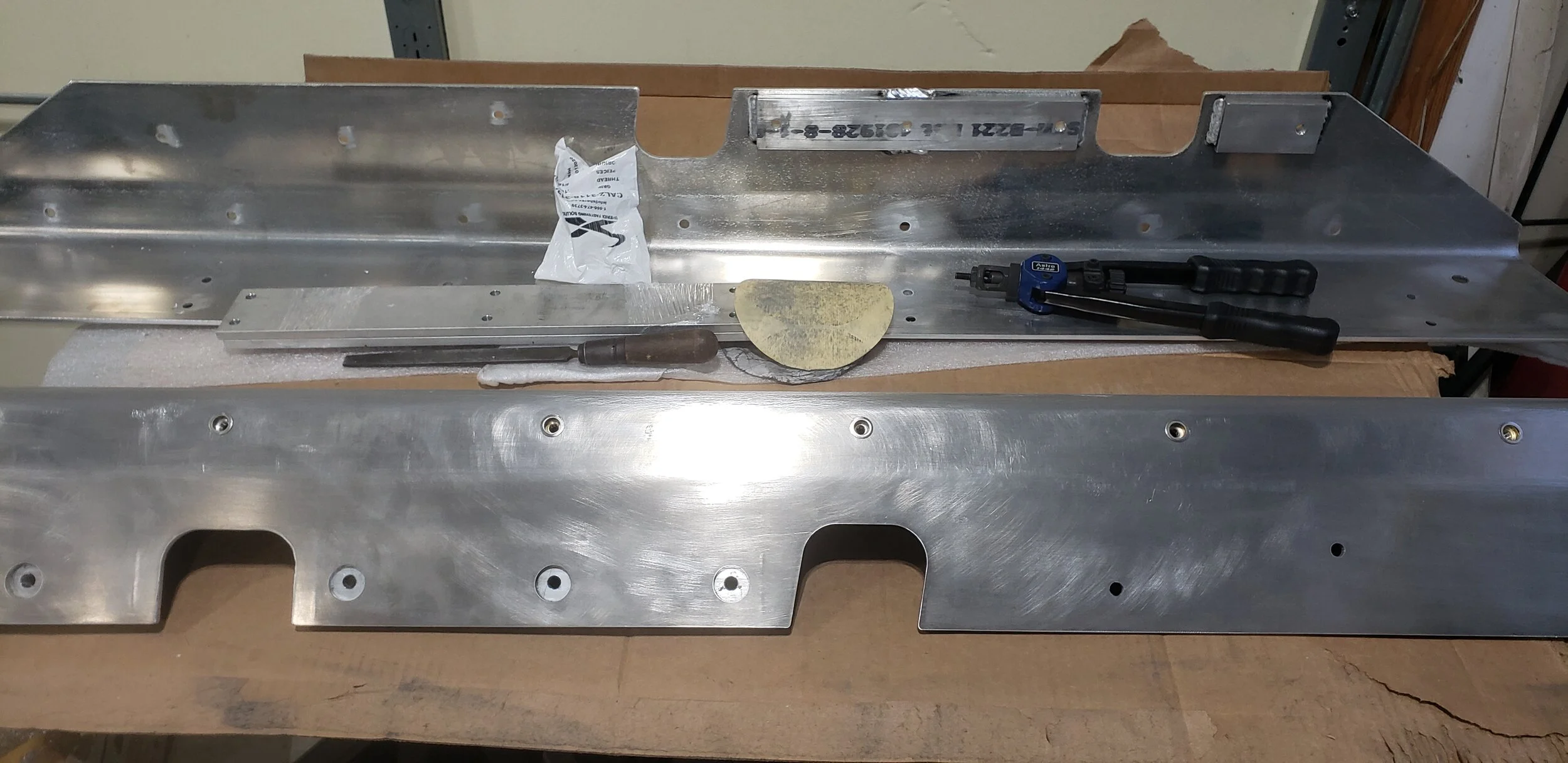

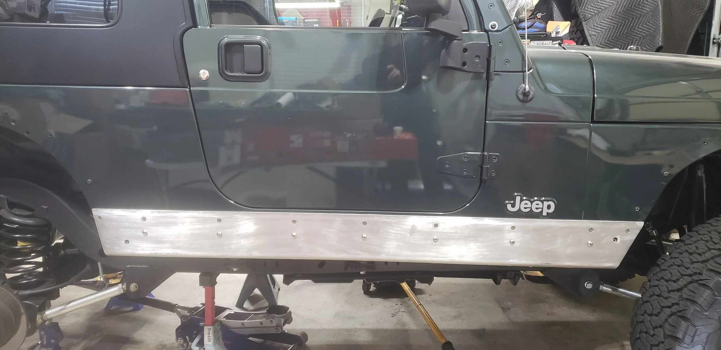

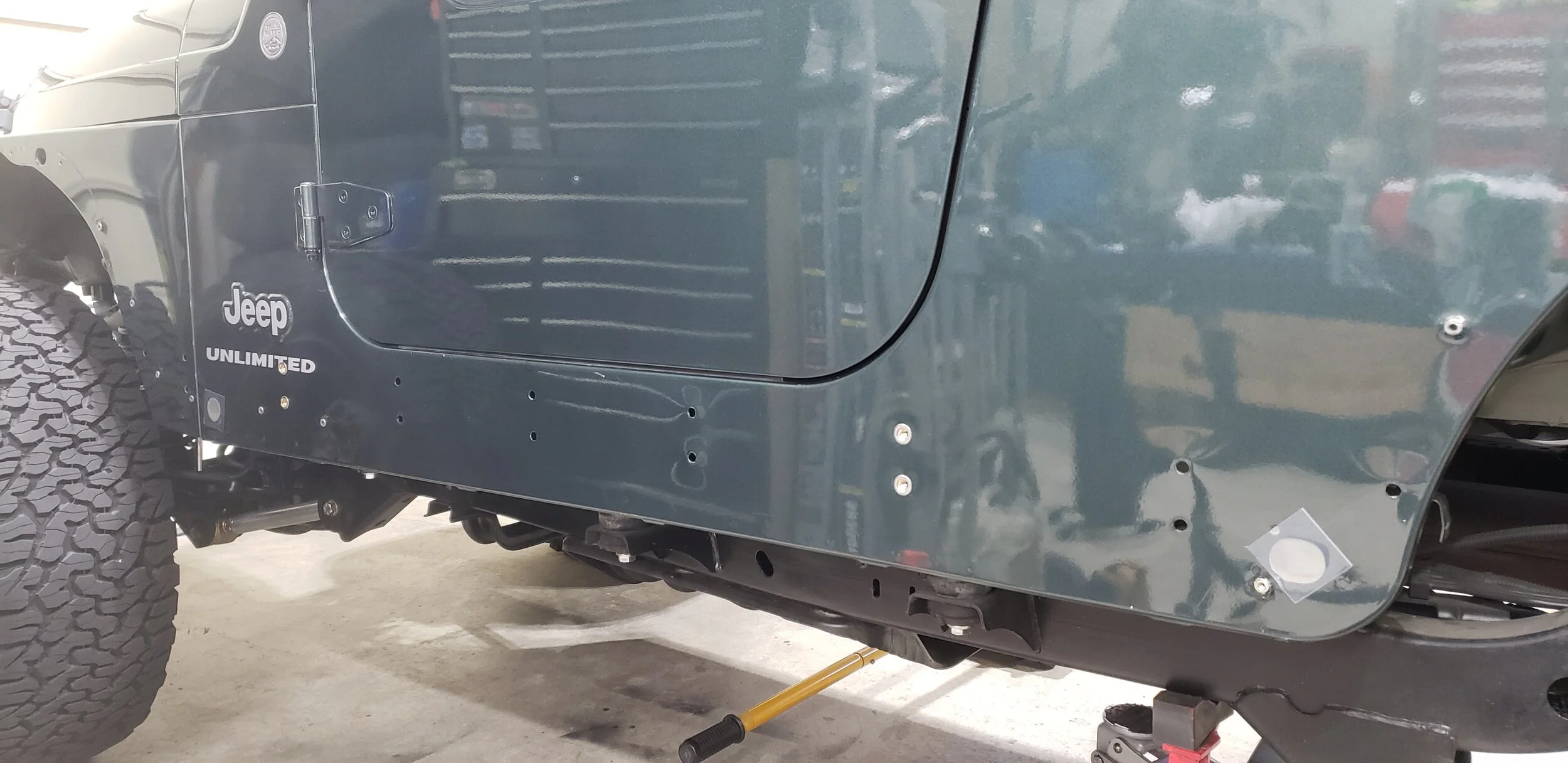

Took advantage of some free time and started on the Savvy Rockers. Prepped both aluminum rockers, filed edges and smoothed them out, then installed the passenger side. Still need to paint the sliders, which will get done later this week. When the weather warms up I'll pull everything and paint the aluminum body color.

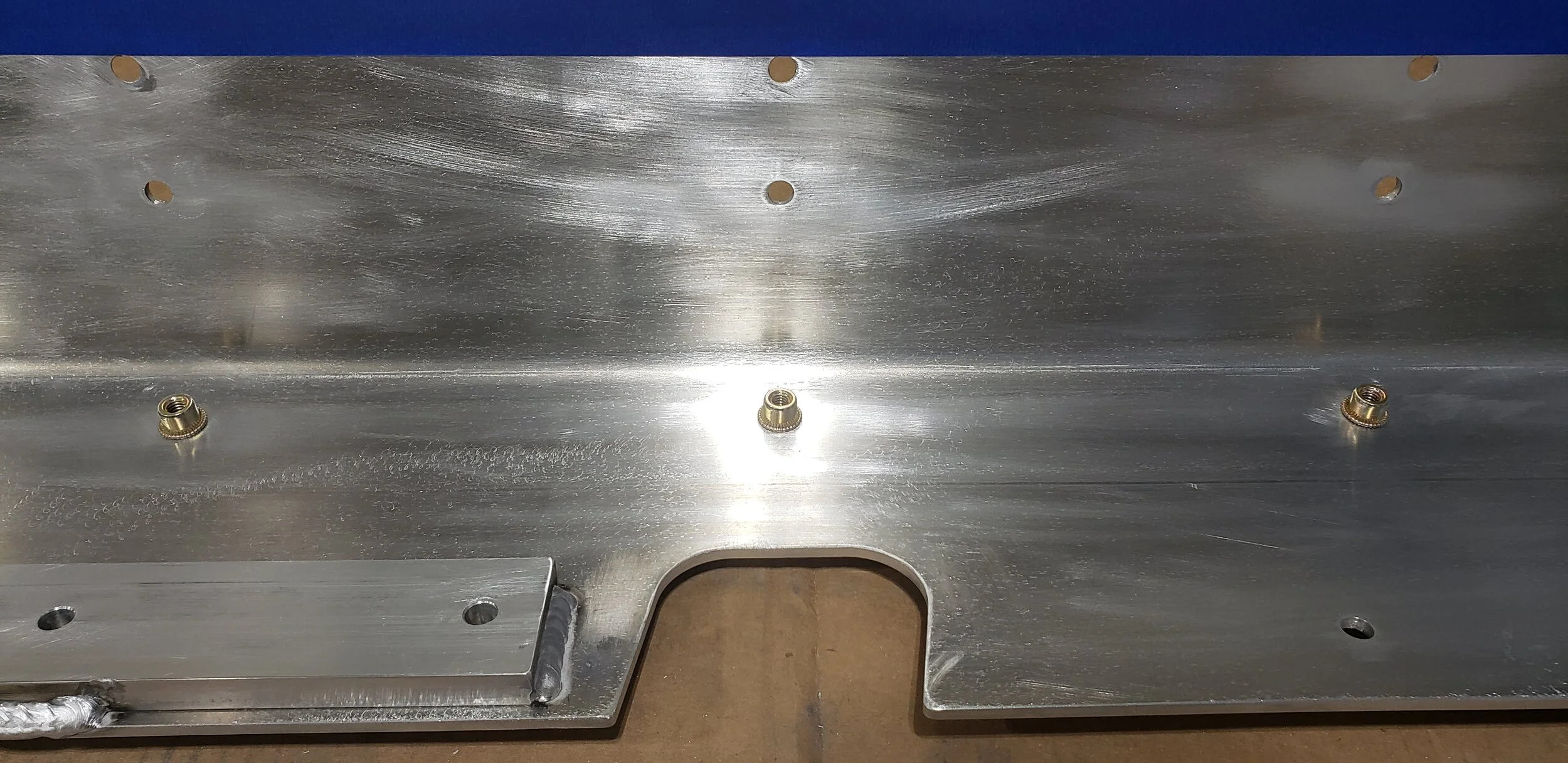

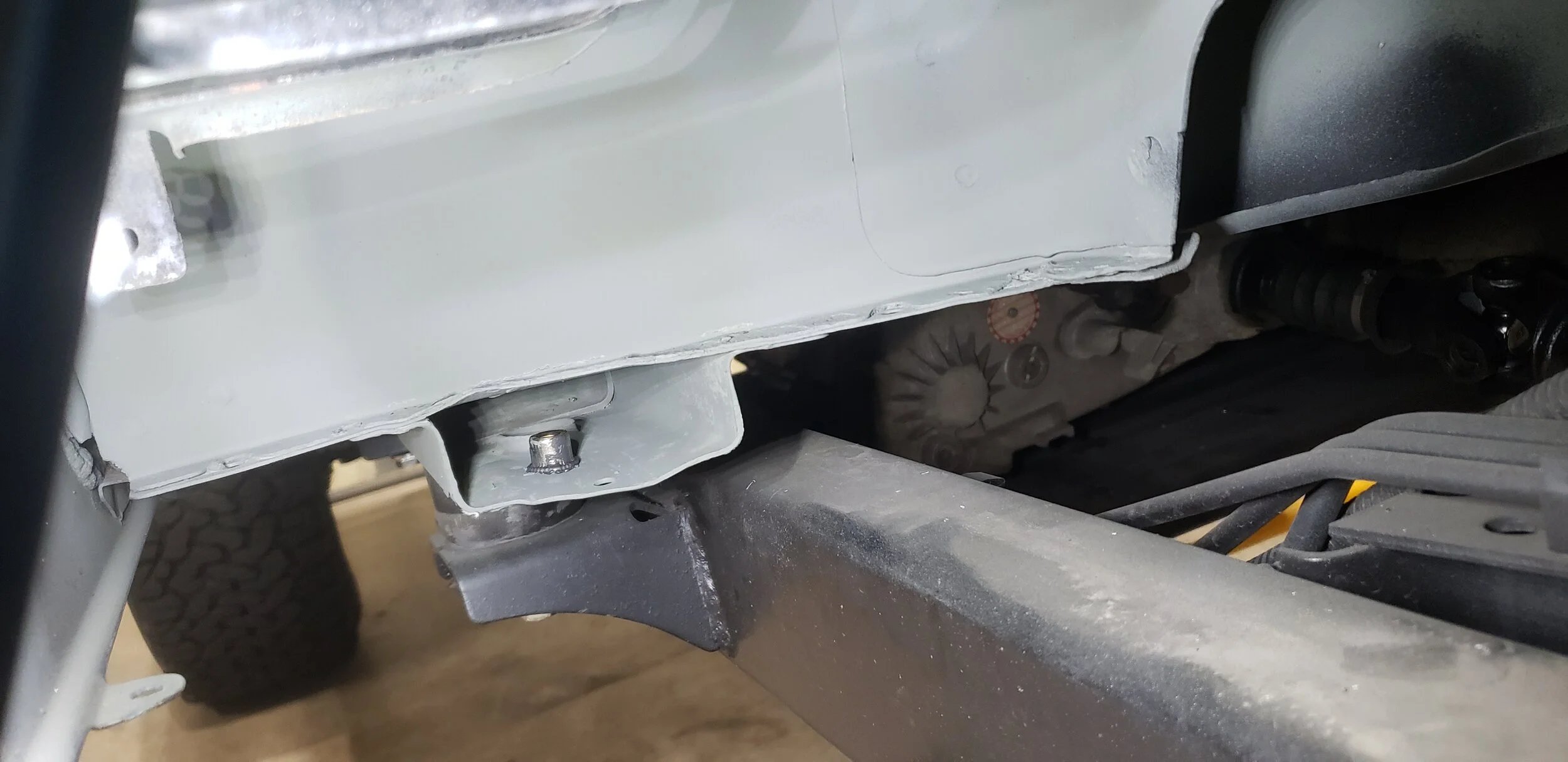

Weather was decent on Wednesday, so I painted the steel sliders. Yesterday, they got installed. Everything lined up like it should and installing the nutserts into the aluminum rockers makes installing, and removing, the sliders much easier. I did have to fight with the driver side torque box, when I discovered it was all bent up. To straighten it out I used a combination of pry bars and scrap pieces of steel.
Since things were partially disassembled, I did give serious thought to installing the Genright corners. However, my energy level has been low lately, so I decided not to push things.
As a side note, I'm watching the weight on the LJ. With the parts removed and the parts added, I'm now up approximately 280 lbs. Of that weight:
- 215 lbs is unsprung (adding the heavier wheels, 35" tires, and Dana 44 front)
- 65 lbs is sprung

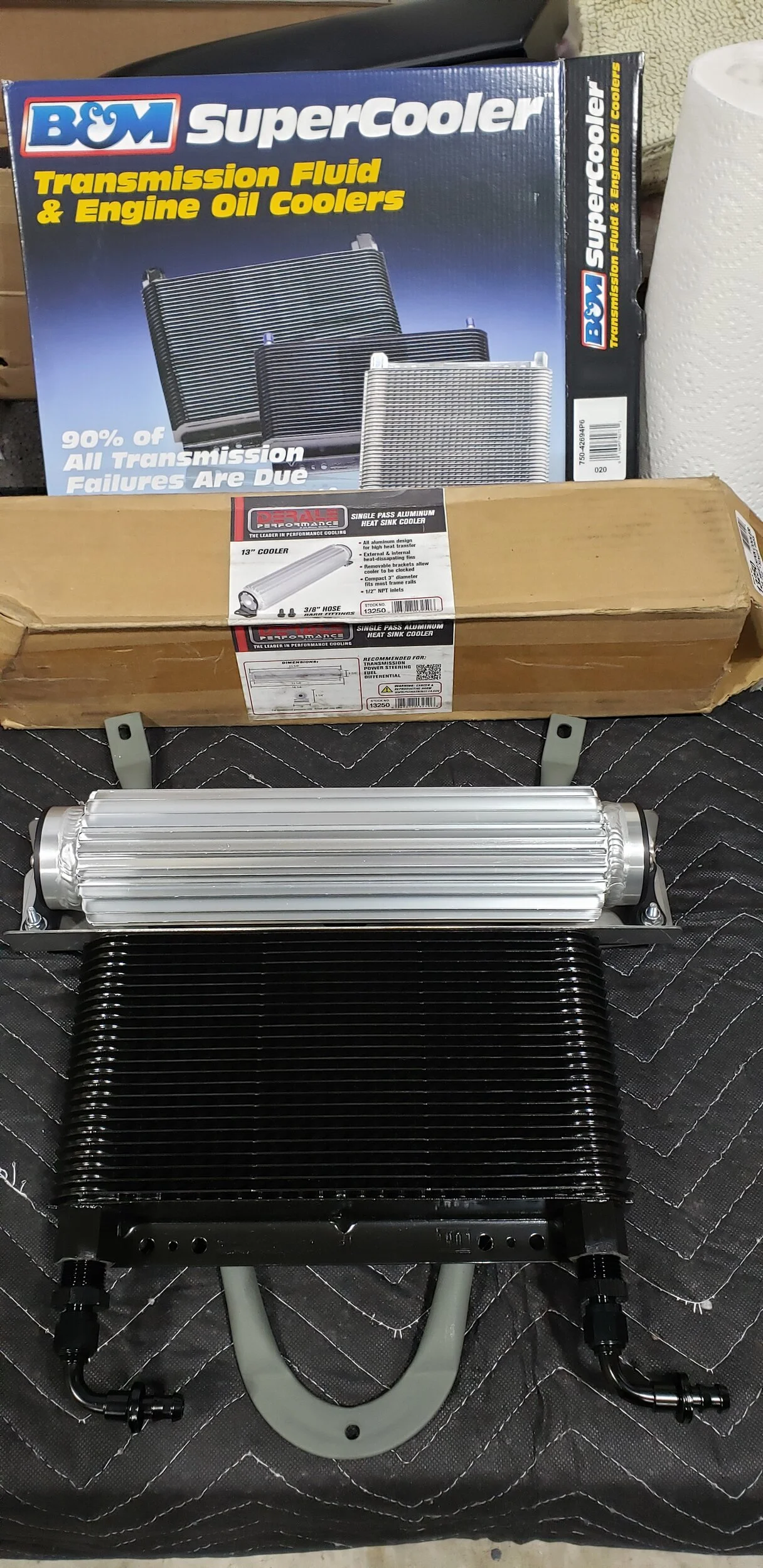

Did a mock-up on the transmission and power steering cooler. The transmission cooler tucks up under the power steering cooler bracket sold by BMB. It all fits, but I do need to figure out something better for the fittings. This fitting configuration, which I won't use, is just plain bulky and probably leak prone.

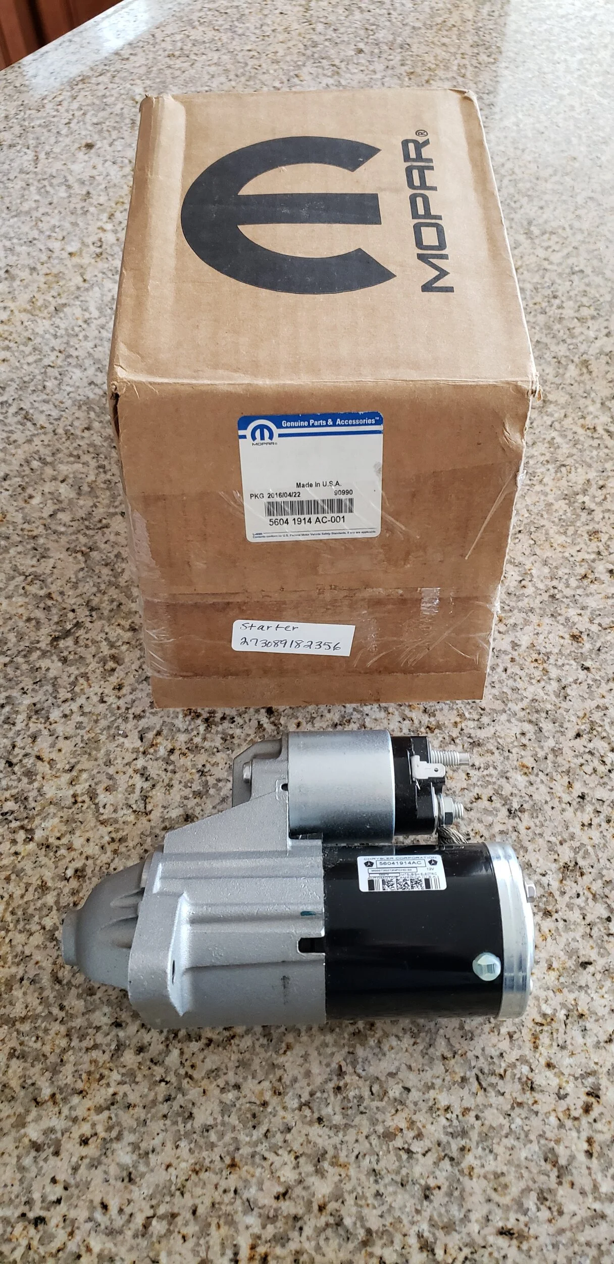

I had an occasion recently where I had to tap the starter to get it to turn over. My original plan was just to rebuild mine, but I found a place on ebay selling a few NOS Mopar starters for a great price. I ended up buying the last two they had.

Do you still plan to have the fittings pointing down? I've always understood that they should be pointed up, or the outlet up if mounted sideways, to help with bleeding air out.
