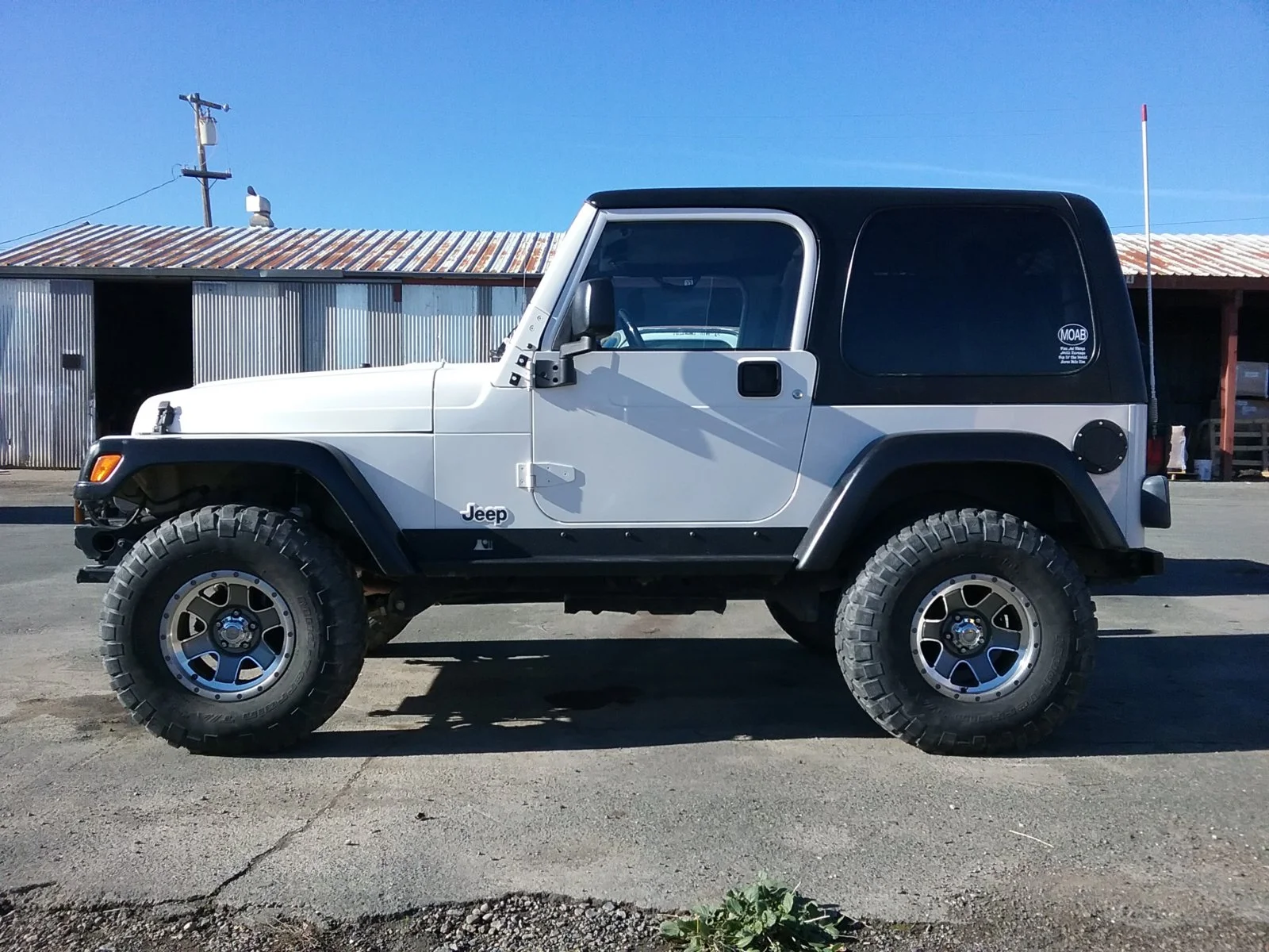

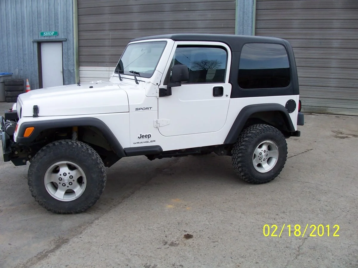

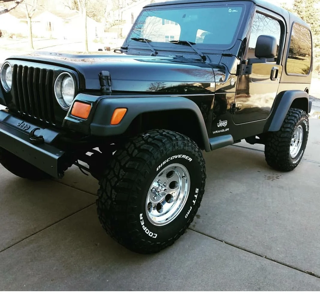

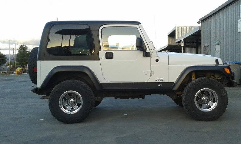

Nice looking list. Tire size looks reasonable although they will stick out more. I know
@bobthetj03 mentioned his 33x10.50, which I think is a great size on the TJ in regards to tucking under the flares and being reasonable in size and weight. I will admit to a bit of size envy looking at my 31x10.50 next to his and
@lowranger 33's
33's will inevitably need a gear swap, something that will add a good amount to your budget.
