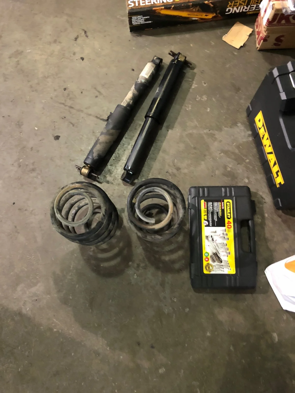

Parts! Had over 100lbs of jeep parts delivered yesterday. I'm excited to get to installing hopefully sometime soon :). Still debating between 32's and 33's.. starting to lean towards 33's, I really do like the look. Now I'm mixed on tires todays thought was Duratracs but it changes often, hah (I like the look of the Coopers also). Will probably pull the trigger on BMB front brakes soon as mine are near the end of their life and it'd be nice to have new brakes with the bigger tires. 5 Pro Comp wheels coming in tomorrow, they were the right price and I like the look with some tires.

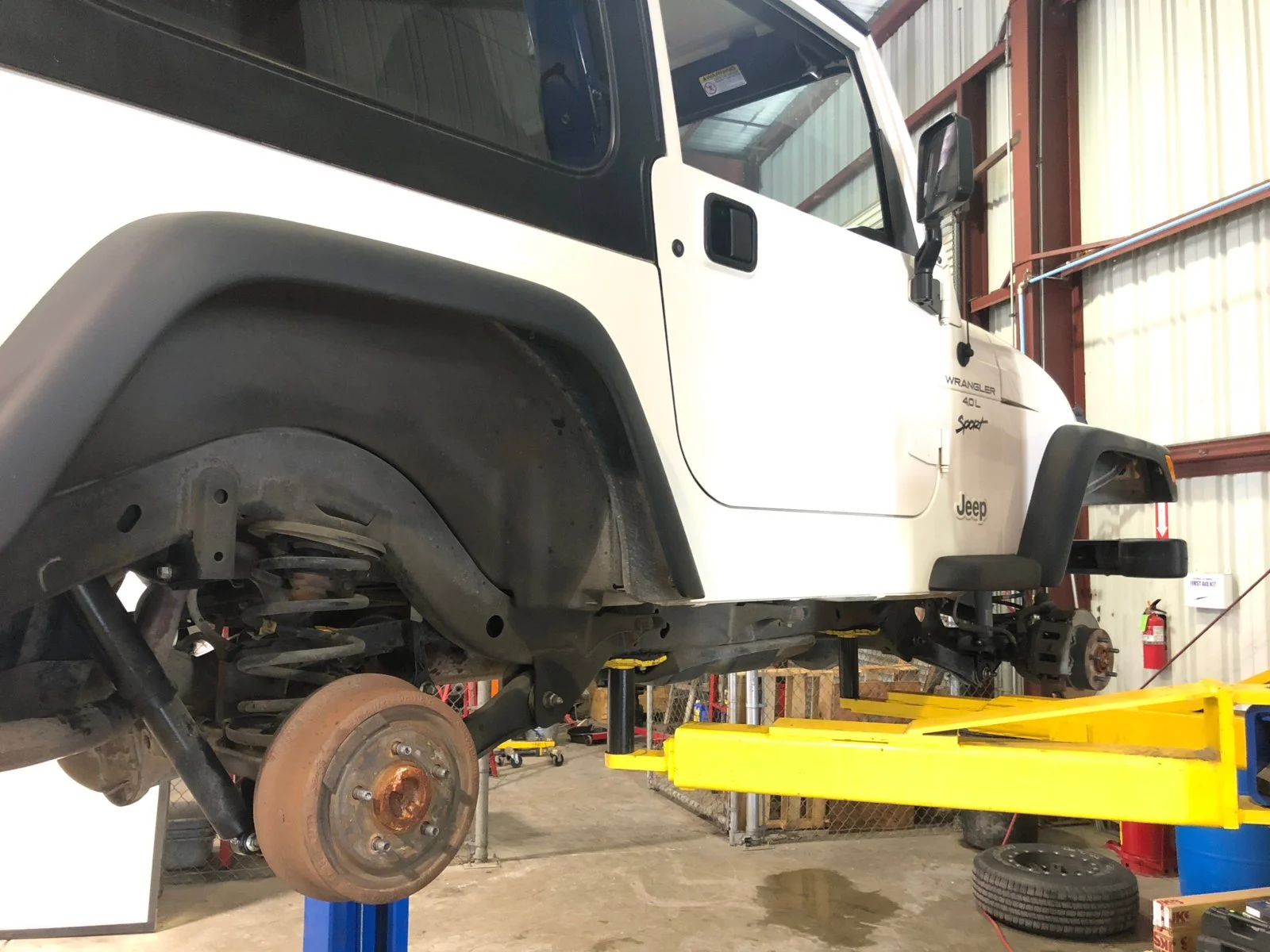

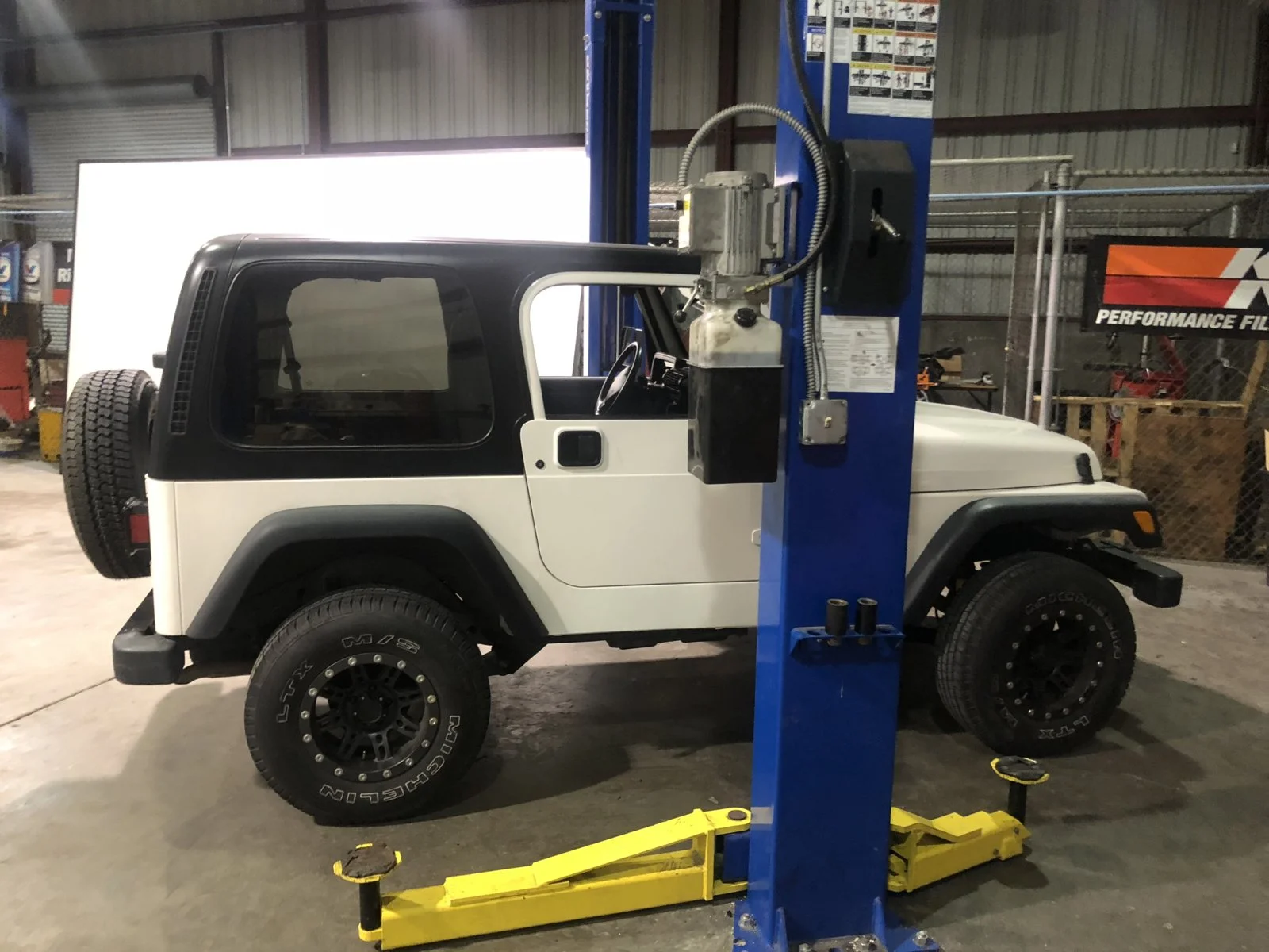

Today in a nutshell
The Frustrating
- I didn't realize until I got to the shop the PO had some weird lug nuts which require a special adapter on all tires. Managed to get said adapter from PO after the fact but didn't get to do anything today (Shop is about an hr away)
- While driving around my CEL came on for the 3rd time since I've had it.
The Good
- Confirmed what I kind of already knew with 3.73 gear ratios and rear dana 44
- PB Blasted everything
- Its really clean underneath, a lot cleaner than photos/videos I've been watching on install. I could still read the Chrysler tag on the shock which was shocking
- Shop was nice enough to not charge me, although I walked away with my tail between my legs

Dumb question: I'm guessing the OME shock with the black casing is rear and the yellow casing is front? It didn't say anything on the packages. EDIT: Just realized the front and rear will have different ends :rolleyes:

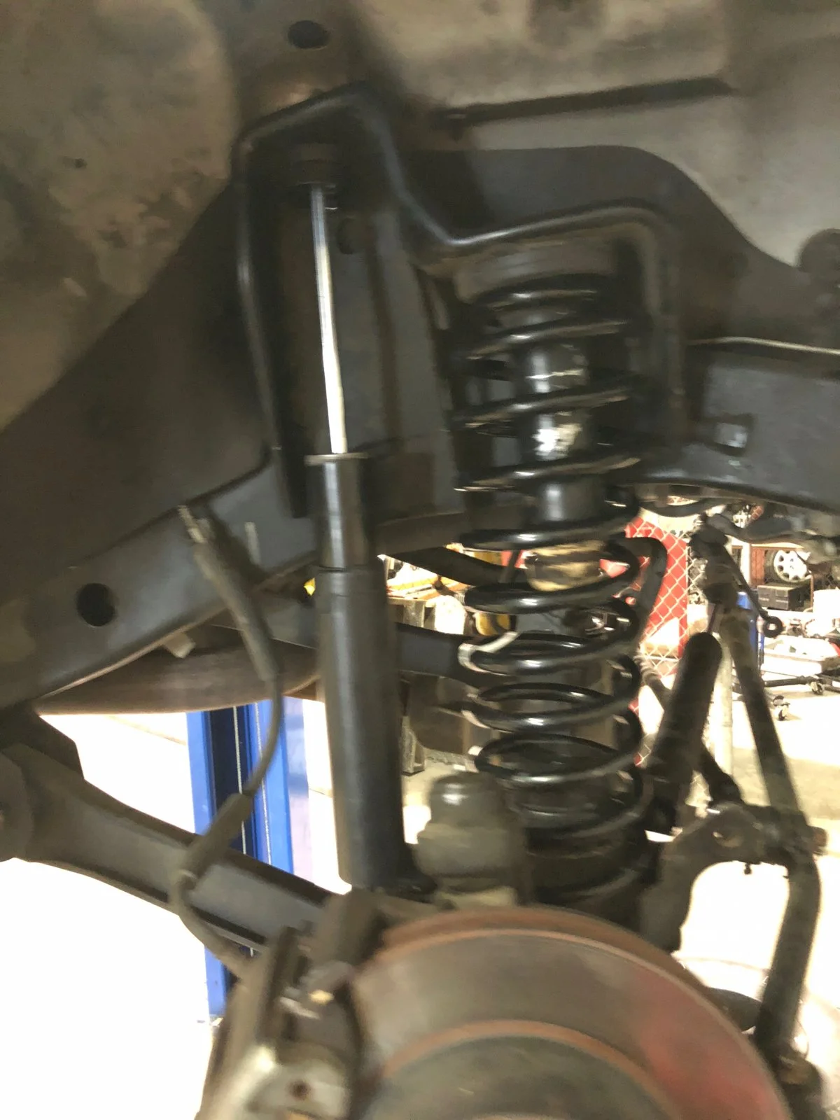

Stuck: What’s the best way to get the front shock uppers off? Don’t think I’ll get done today unfortunately, can’t find the drill for my front bumpstop and the mechanic left a couple of hours ago
Why are you having trouble getting the front shock upper nut off?
Basically I would spin it with a 13mm wrench on top and obviously the shock would just spin. I was having a hard time grabbing to anything with a wrench, as theres kind of the foam near the top and not much to hold on to. Tried doing something like this to remove the foam but didn't have the best tools for it.

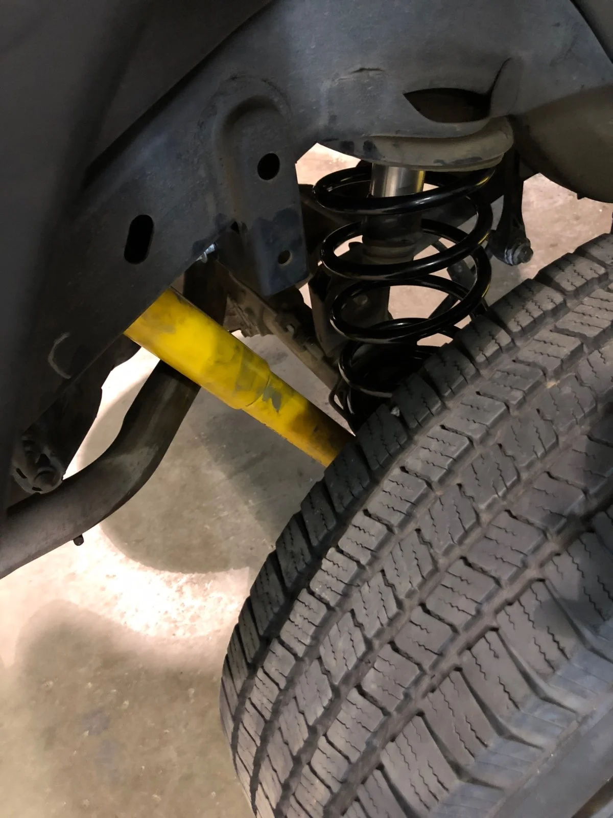

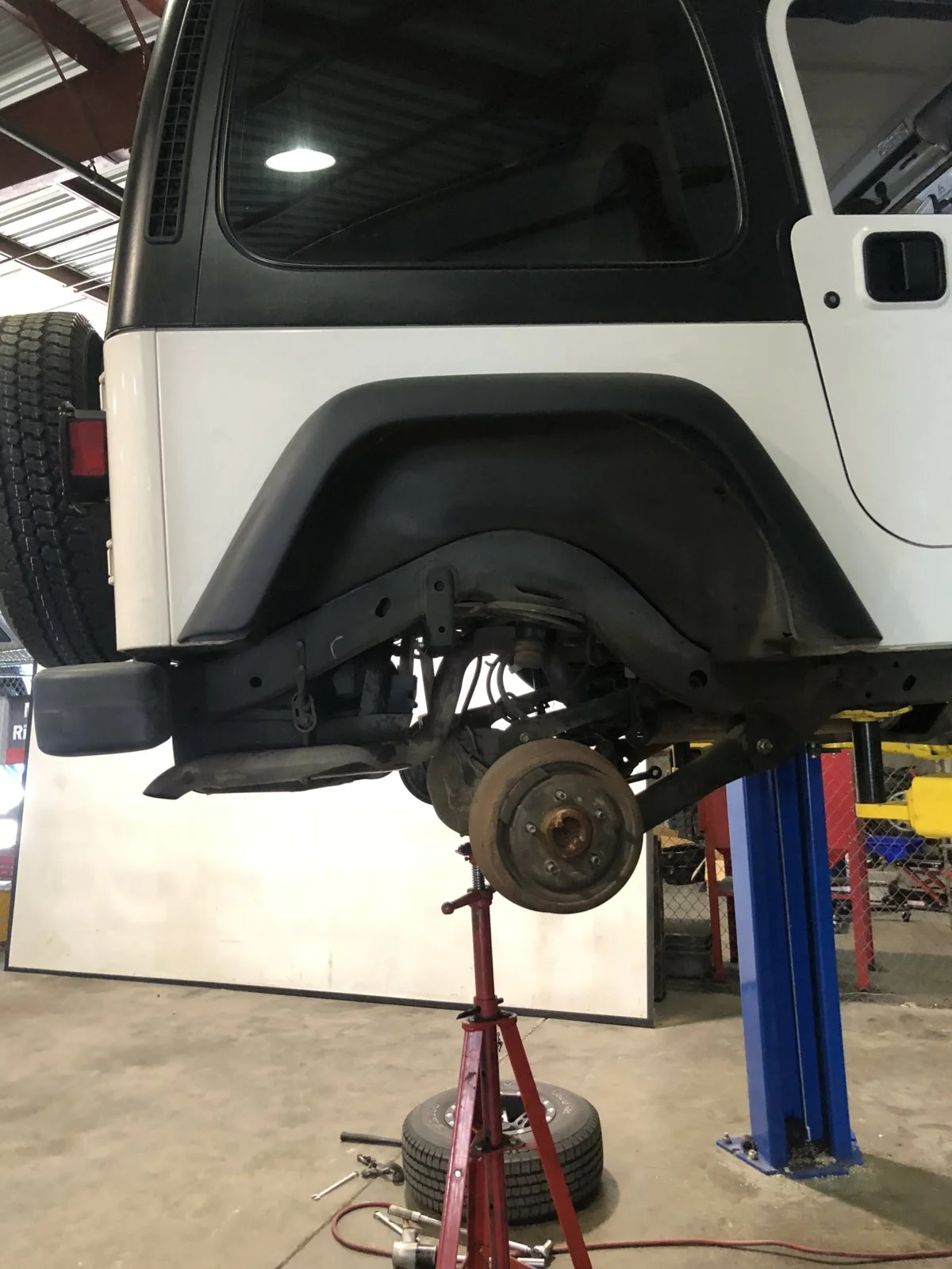

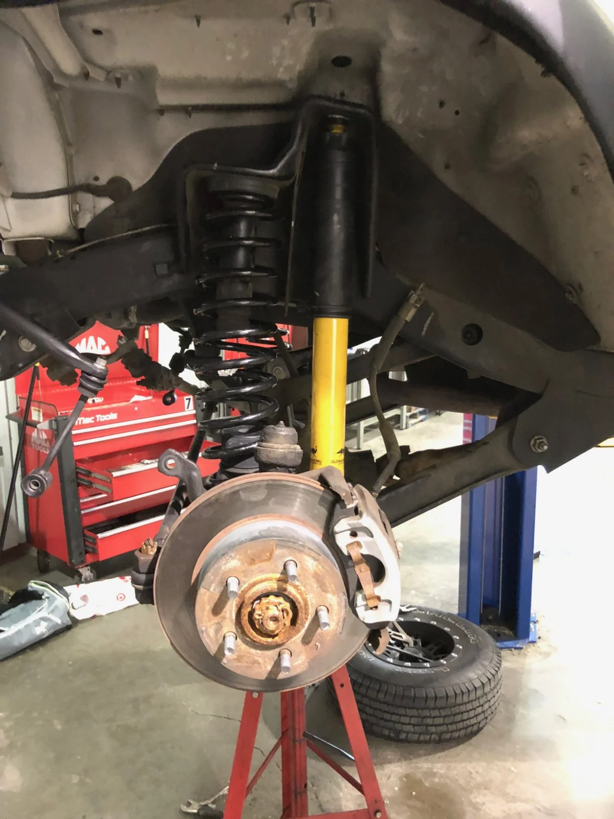

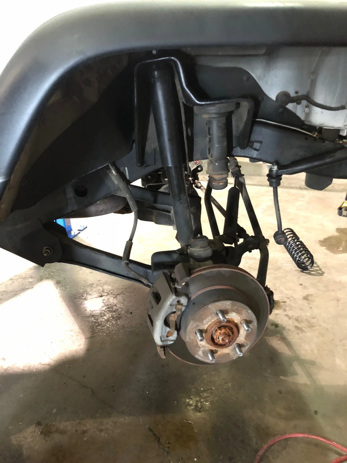

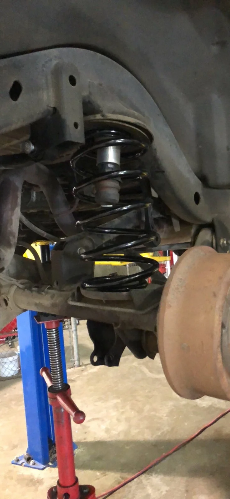

Finished up the suspension today! A lot more planned for the weekend.
As for right now pictures installing OME shocks/springs. The passenger side shock took forever to get out, the nut was kind of seized up on the thread. I wanted to cut it off but the person who I asked for help with it at the shop was hesitant so a few hours went by before it finally came off, it was quite seized up.
It was a good learning experience, nothing fell off on the way home, and I still saved a lot vs the labor rates (even though it took me quite a lot of hours and I did it at a paid for shop). I ended up doing the whole thing myself. :b1:
That's gotta be a great feeling. And you're right, it does look clean under there! Gotta love that! :thumbup:
Reactions: tomtaylz
Great work! I saw a few posts about the process didn’t get responsed to. Glad you figured it out. First time is a bit cumbersome
