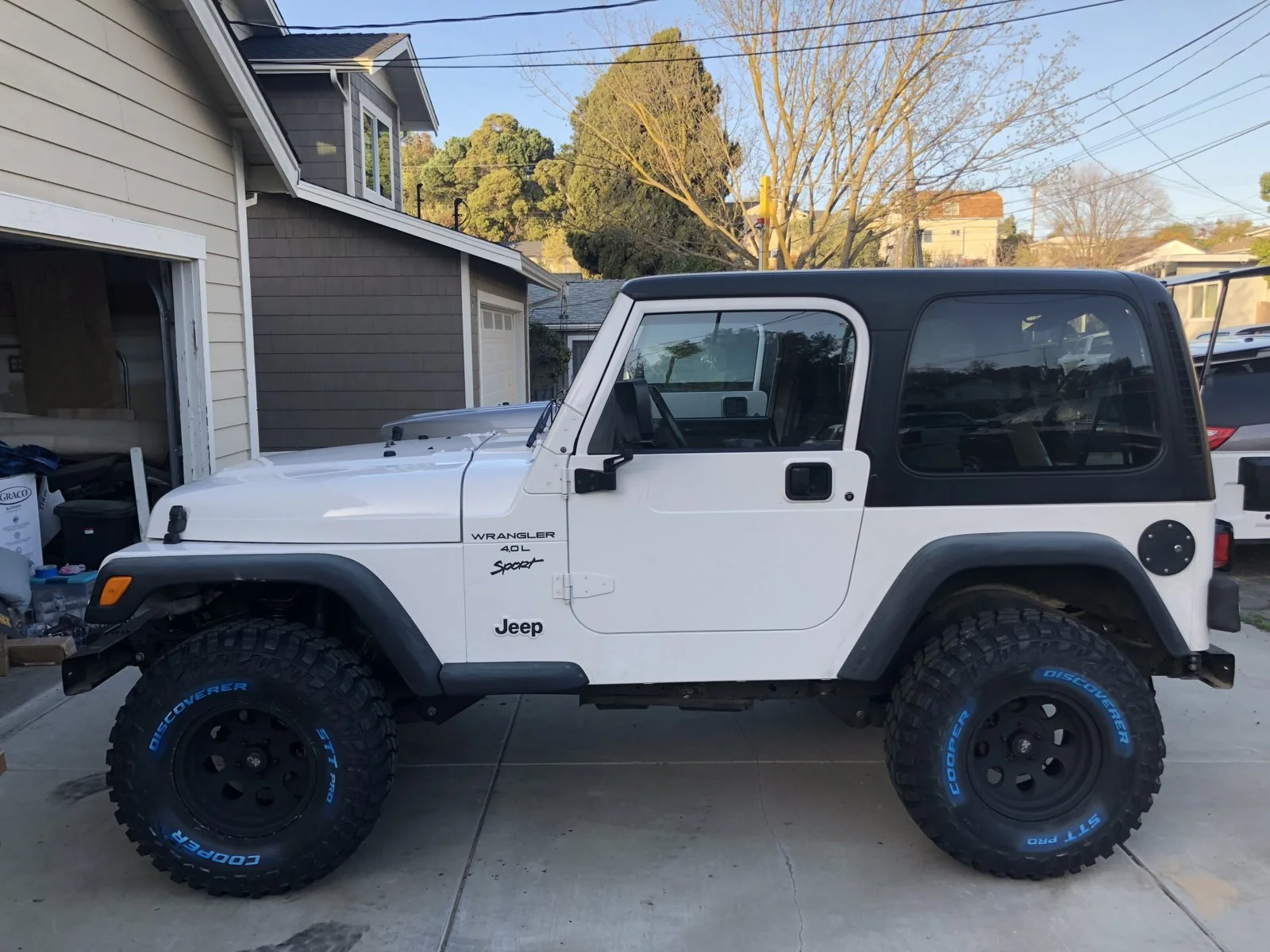

Today was a busy day driving all over, picking up parts, getting tires mounted, etc. Decided to go white out which was a toss up for me, I think it’ll look good with the white Jeep, or I’ll live with regret/figure out a way to de-white it. (And Thetacorocker’s white out coppers look awesome!)

Good news @tomtaylz! DW can be a real pain to track down. I think you mounted the tires w the blue out, not white. :D

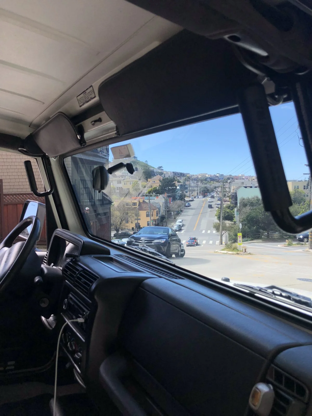

GraBars installed, visors flipped. Did it while street parked and got some weird looks but the view was pretty good! You can just about see the ocean.

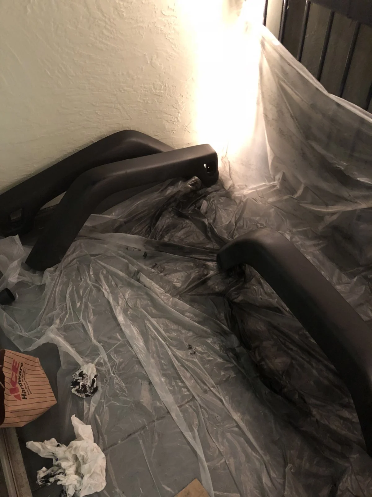

Slowly getting around to painting my flares on my balcony. I picked up a curt hitch off Craigslist today and got a hitch based bike rack with my 20% off REI coupon as an early birthday present. More stuff to install. Anyone know what hardware I’d want to install the hitch?
