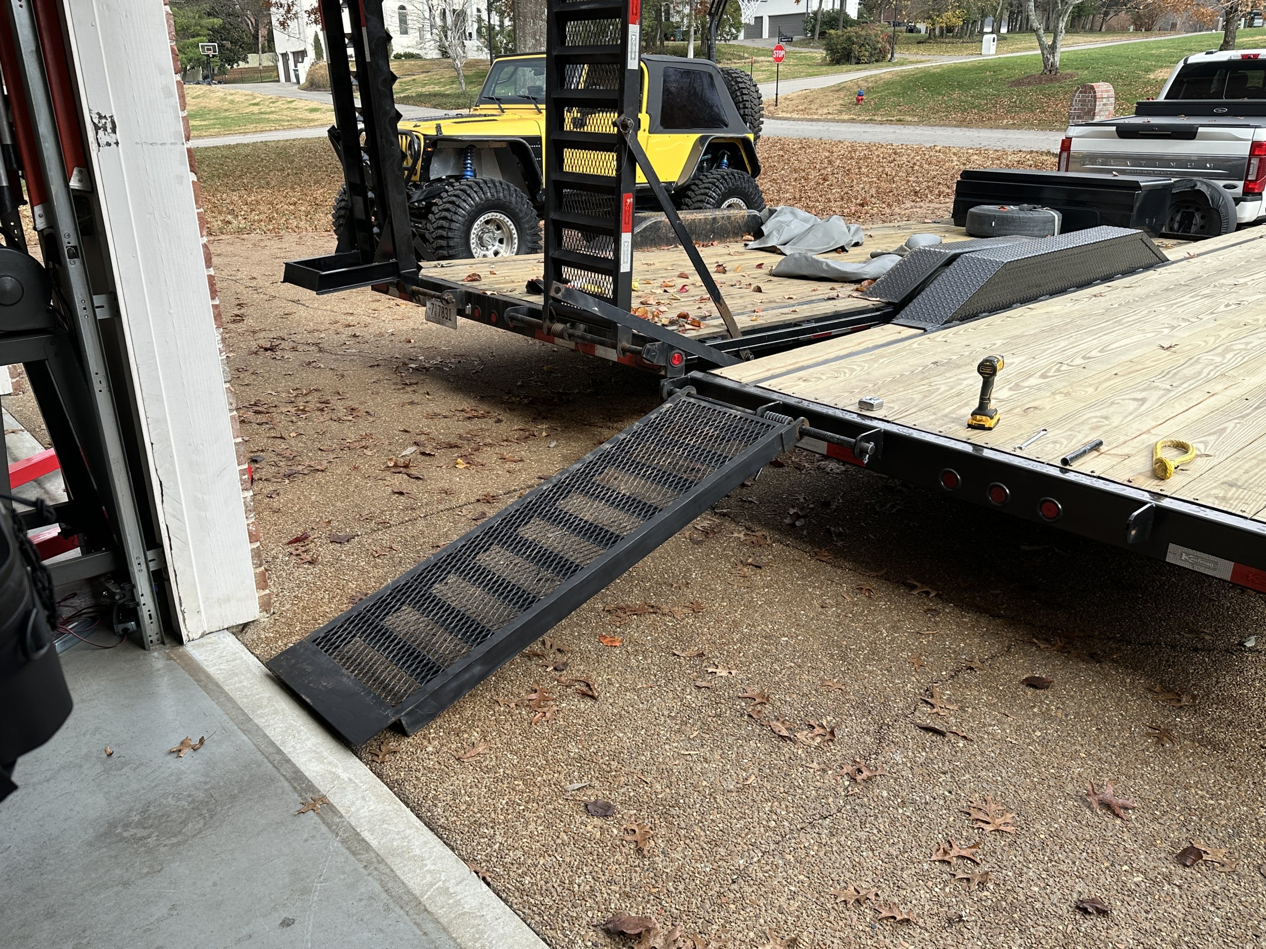

One thing I definitely wanted to swap over was the ramps. I ordered the same configuration on the back end so I was fairly confident that I could do so.

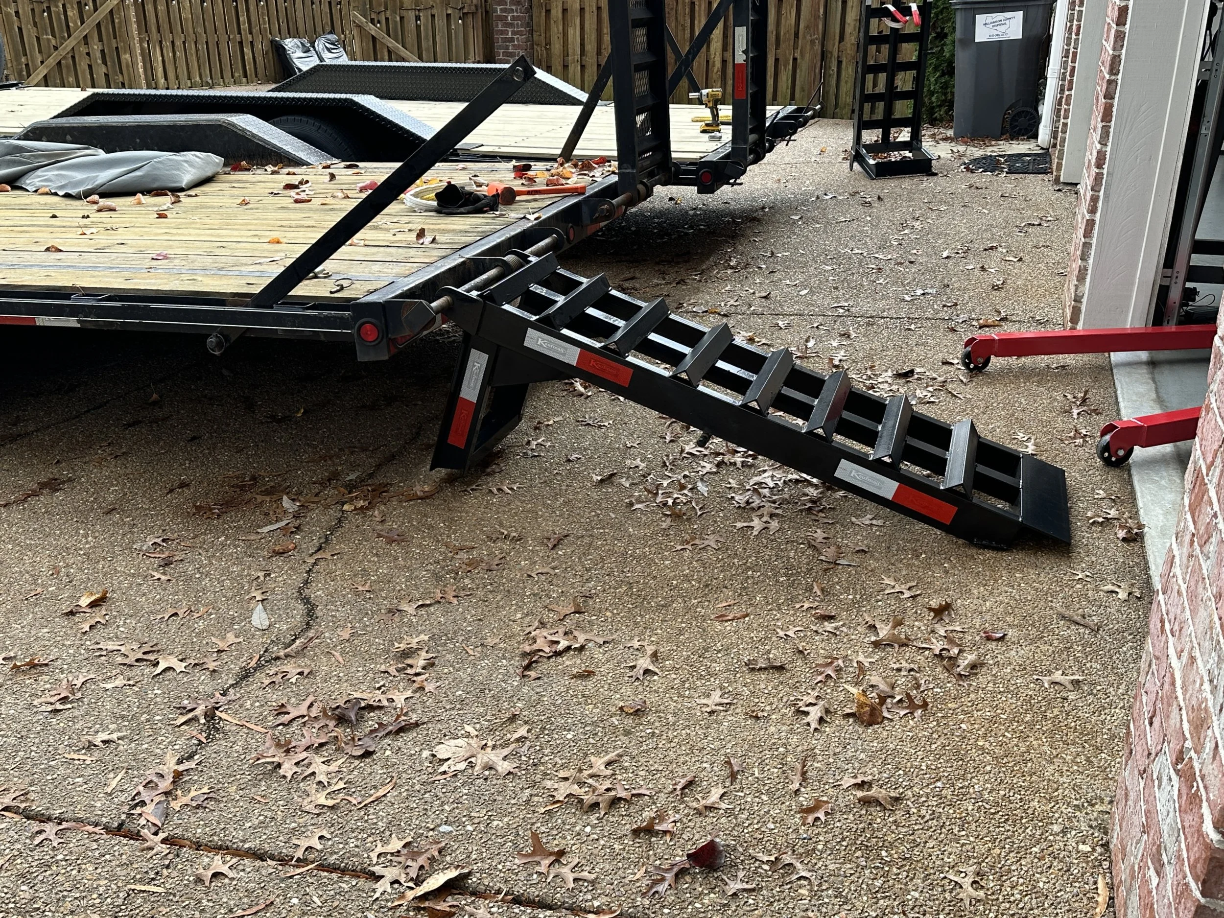

The ramps which came with the original trailer, and those which came with this one as well, are made for heavy equipment. Here is the ramp which came with the new trailer (already swapped over to the old trailer here):
For my use, there are two major things wrong with this design. First, the lower brace / foot, designed to take the weight while loading heavy equipment, is a problem on anything but flat ground. Off road, or in uneven gravel parking lots where I spend a lot of time, that foot strikes the ground and can make it impossible to deploy / retract. Second, I use the trailer often to transport motorcycles, and it is very difficult / dangerous to try and run a big bike up those big treads.

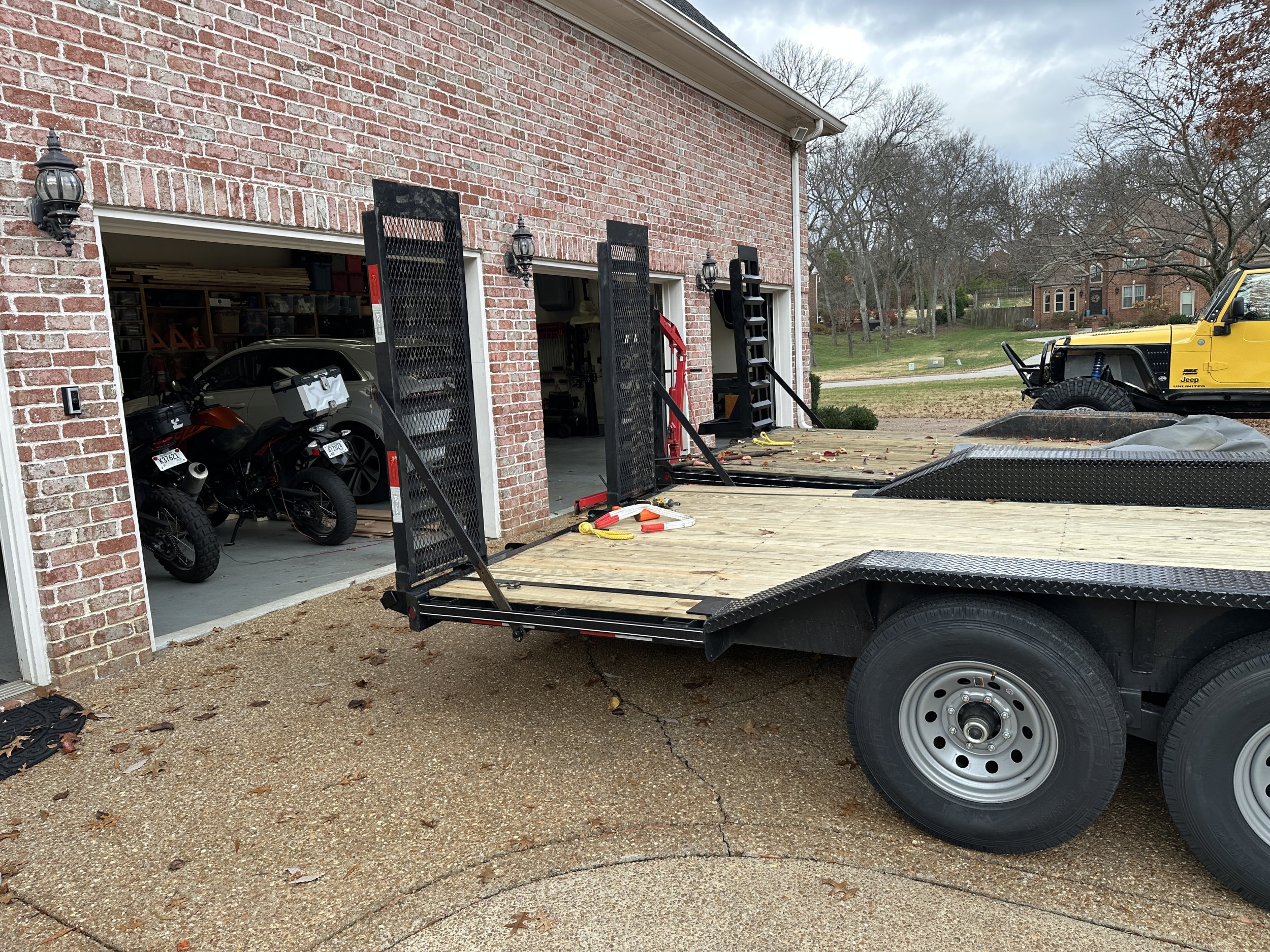

On my previous trailer I modified the ramps to remove the foot (not needed at all for the Jeep), and rebuilt the surface to be flat using expanded metal. It was actually a crazy amount of work which I had no desire to do again. Here is the modified ramp:

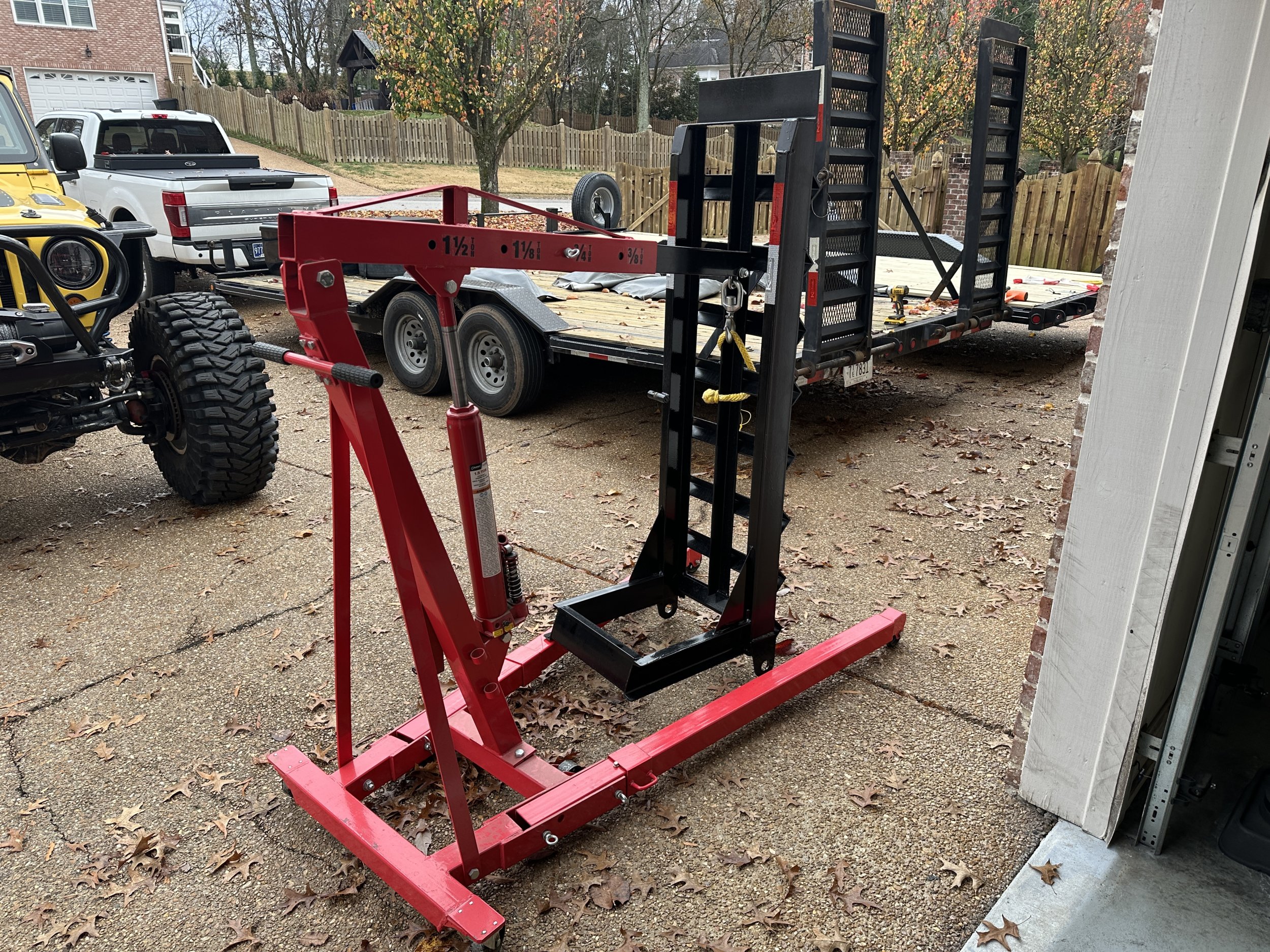

And man, these new ramps were heavy! Clearly designed to support a 10 or 12,000 pound piece of equipment, these things must have weighed 250 or 300 pounds. I had to resort to the engine hoist to do it by myself, but it worked well.
...and, the final result:
