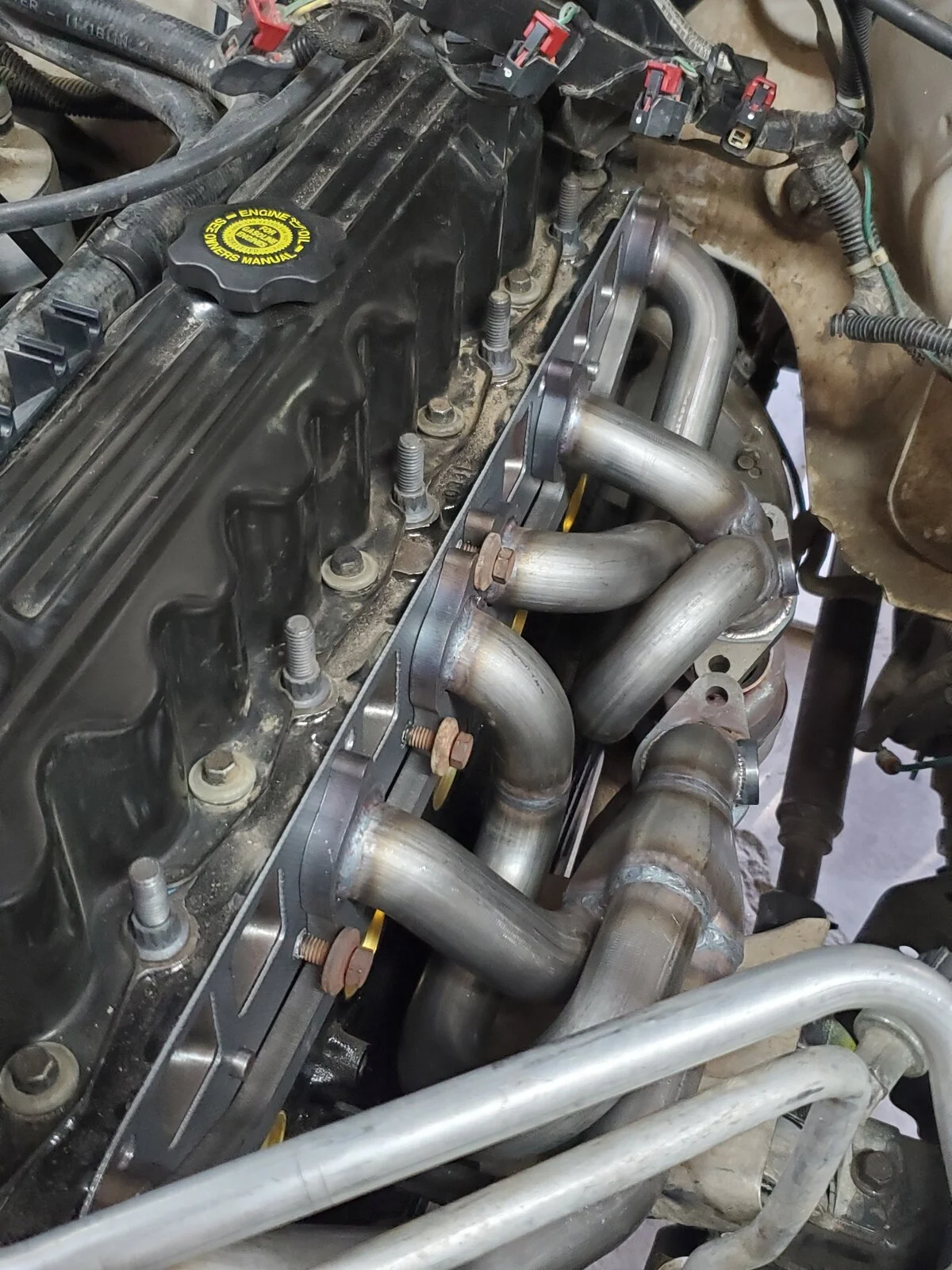

Quick update. I hooked up the stock exhaust manifolds which isn't the way to go. I have exhaust leaks so I ordered the Banks header and will get it in about a week. FiDI will be sitting until hopefully next weekend when I can out it in. I also talked to Russ and he recommends the Banks as well.

Put the Banks torque tube on yesterday. What a pain to get the lower bolts tightened. I'm glad it's over with. No more exhaust leak. I have a fuel leak somewhere that I need to find but I think I'm nearly done.
