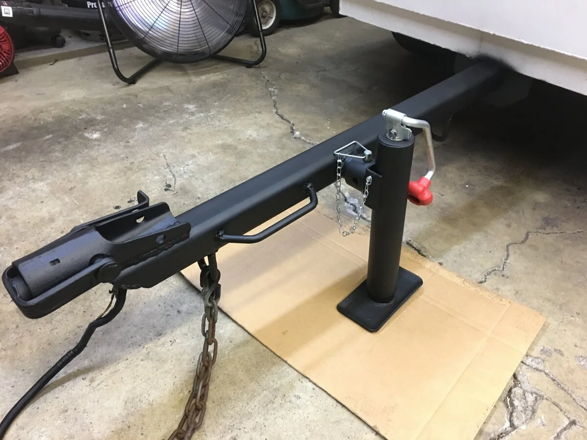

The thrust bearing on the screw for the tongue jack was seized so I ordered a new one and a whole new crank handle. The jack manufacture is unknown, no markings on it. The original thrust bearing had a 1.4" O.D. and .5" I.D. Couldn't find any locally so I ordered one from Amazon, but it was only 1" O.D. and all I could find with the .5" I.D. The bearing had a little bit of grease already but didn't seem like much so I packed a little more high temp bearing grease in there. Got it all lubed up and back together and it works nice and smooth again.
Thrust washer
Jack handle

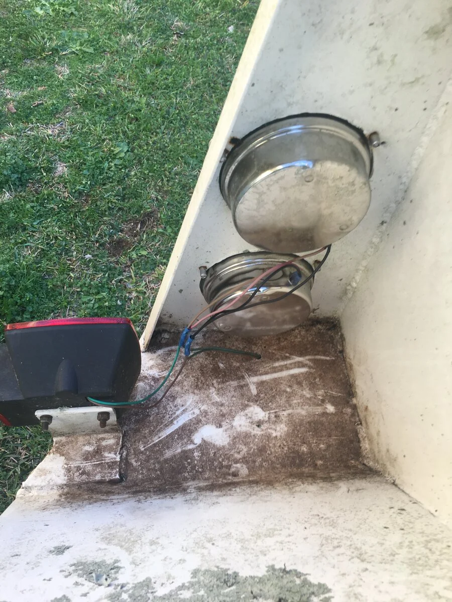

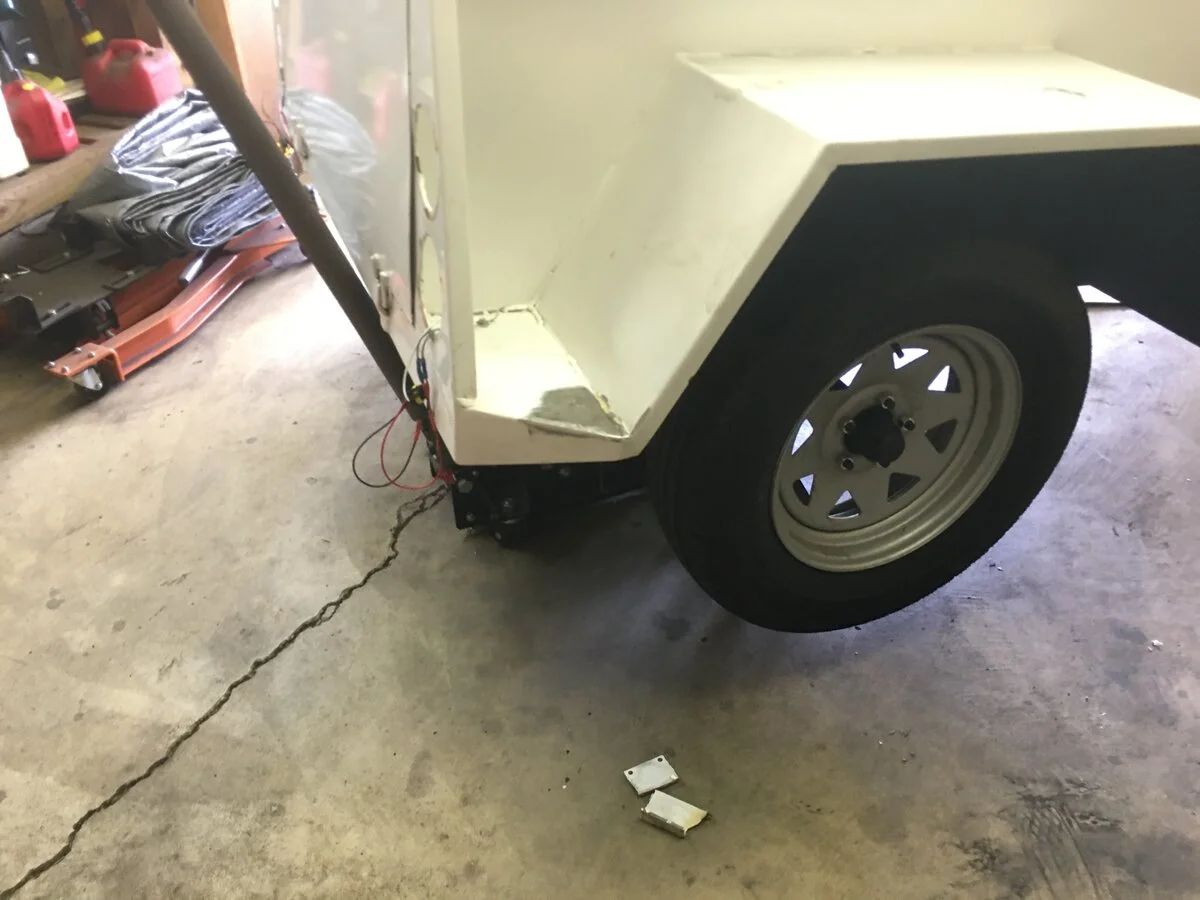

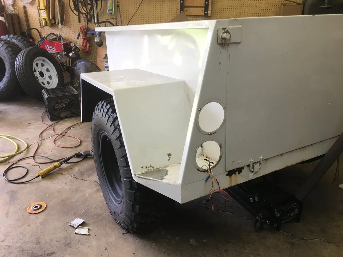

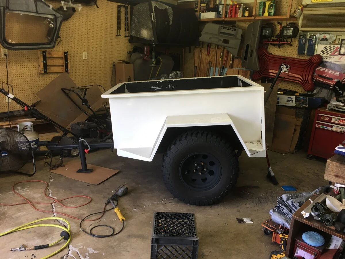

Wire wheeled the inside fender well and frame and then sprayed it with the Rust Reformer on the drivers side of the trailer. Still need to do the other side, but ran out of paint. Put one of my new wheels/tires on that side. Just have temporary lug nuts on there for now. I have some of theses Extended Lug Nuts on the way that @k-huevo posted a link to in another thread. If they work well and hold up well, I may get a set for the Jeep too. I also cut off and cleaned up where mounts were welded on by a previous owner to hold another set of trailer lights. I'm going to mount a 3/4" round 3 wire LED light near that rear brace that holds the tail lights to act as a side marker and turn signal light.
I plan to fill in the upper tail light holes that a previous owner drilled. They must have really liked tail lights.

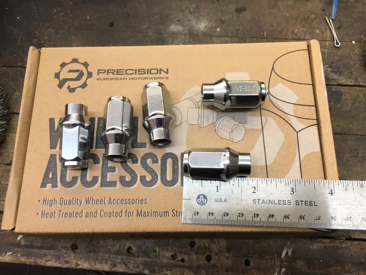

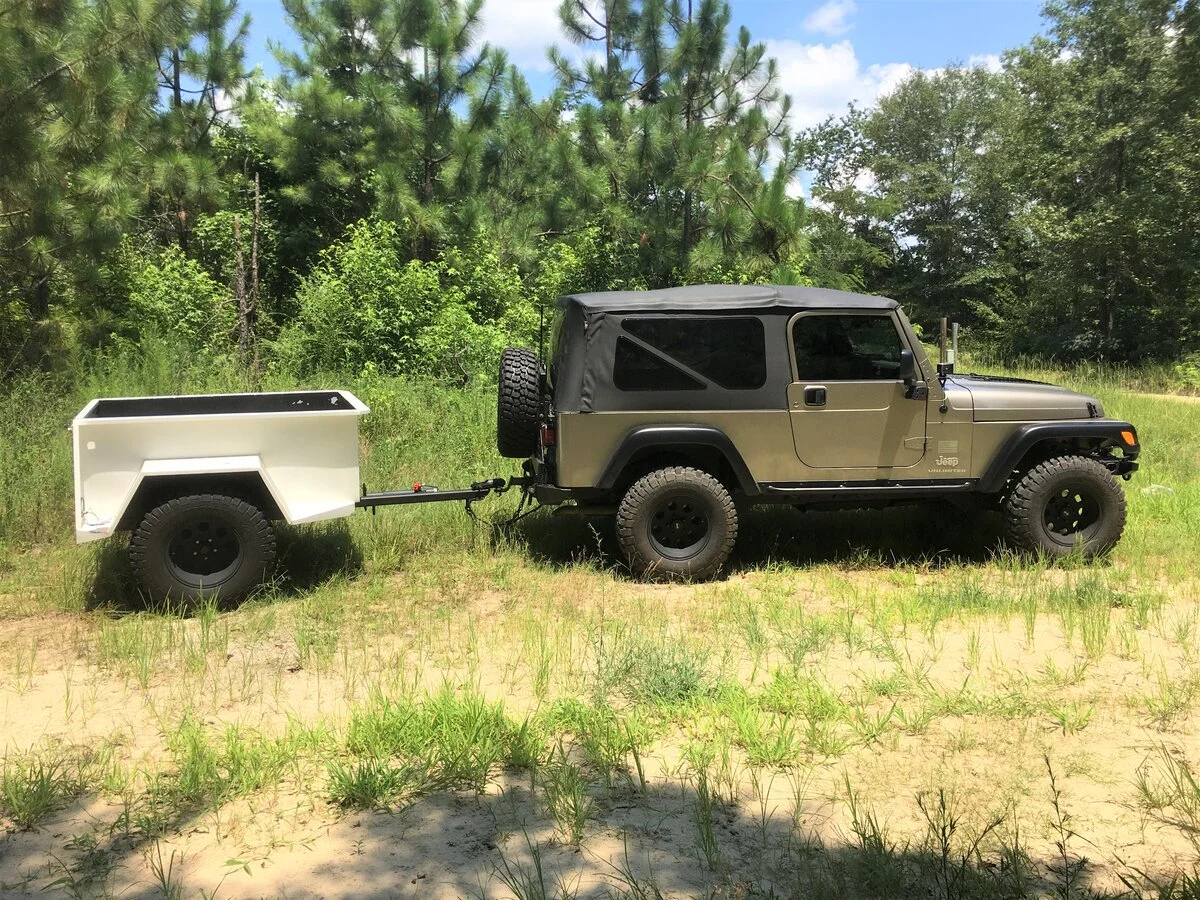

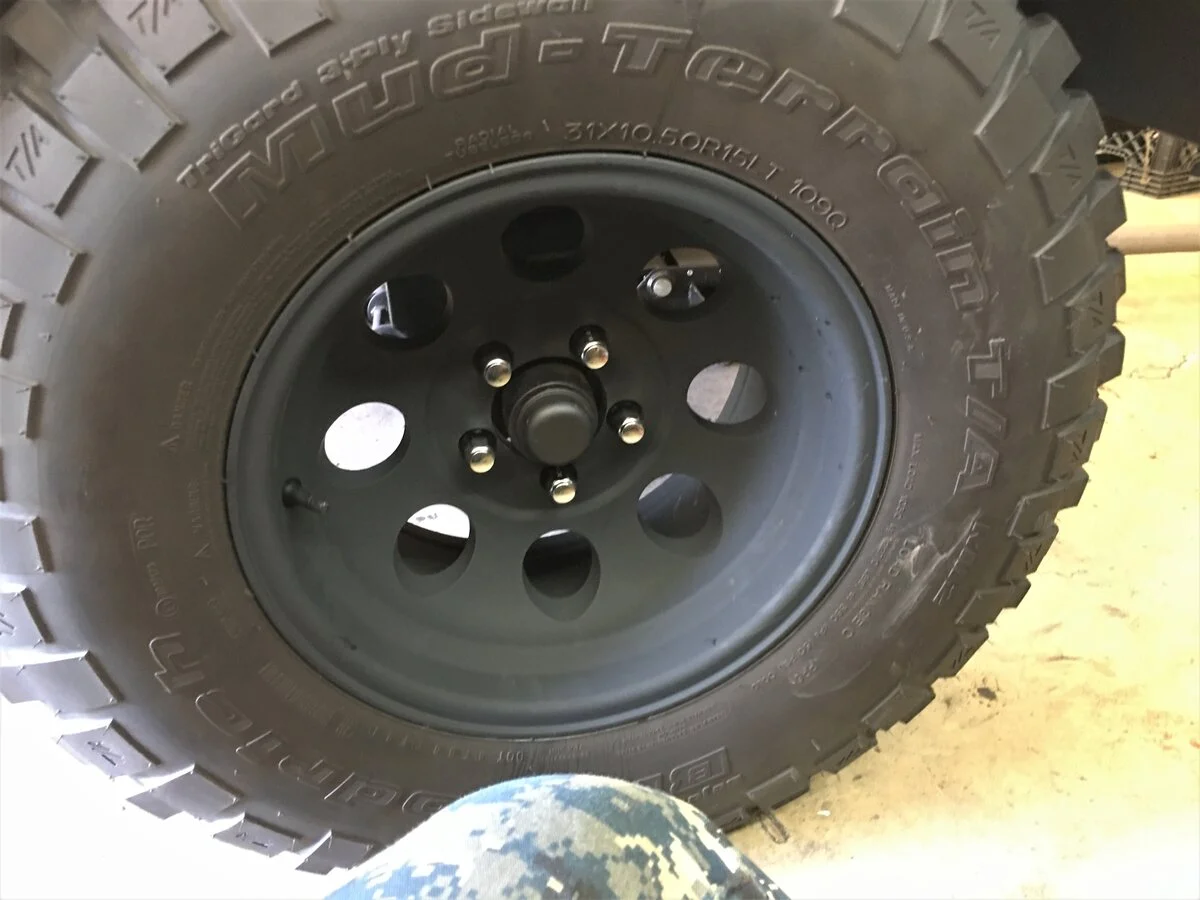

Got the passengers side wheel well and side of the frame cleaned up and painted today and the new tire/wheel on that side installed. Decided to take it for a drive to see how it handled with the newish tires and the new hubs. Aired the tires down to about 24 psi and it rode pretty good and was only bouncy on a couple hard pot holes in the road. Just as I got back home the mail ran and my extended thread lug nuts came in. They appear to be good quality and fit well. Just as good as any other chrome lug nuts I've seen. Hopefully they don't rust up in the first rain storm. I read one review that they didn't fit inside the opening of some customers wheel (don't remember what kind), but they fit great in my Pro Comp 7069-5865 wheels. I ordered a set for the Jeep this evening.
Looks great! Glad it towed good.
