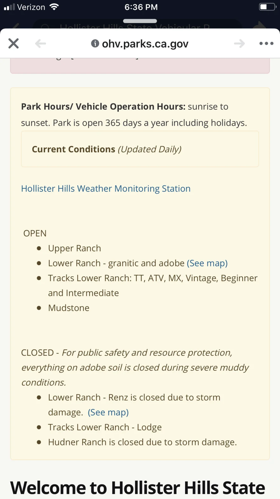

I would suggest watching the HH-SVRA Facebook page for potential closures due to rain. Ten days ago, both Hudner and Upper were closed. Hope it works out for you, I'm about an hour away from HH - in the San Jose/Cupertino area - but can't get out this weekend. Maybe next time.
