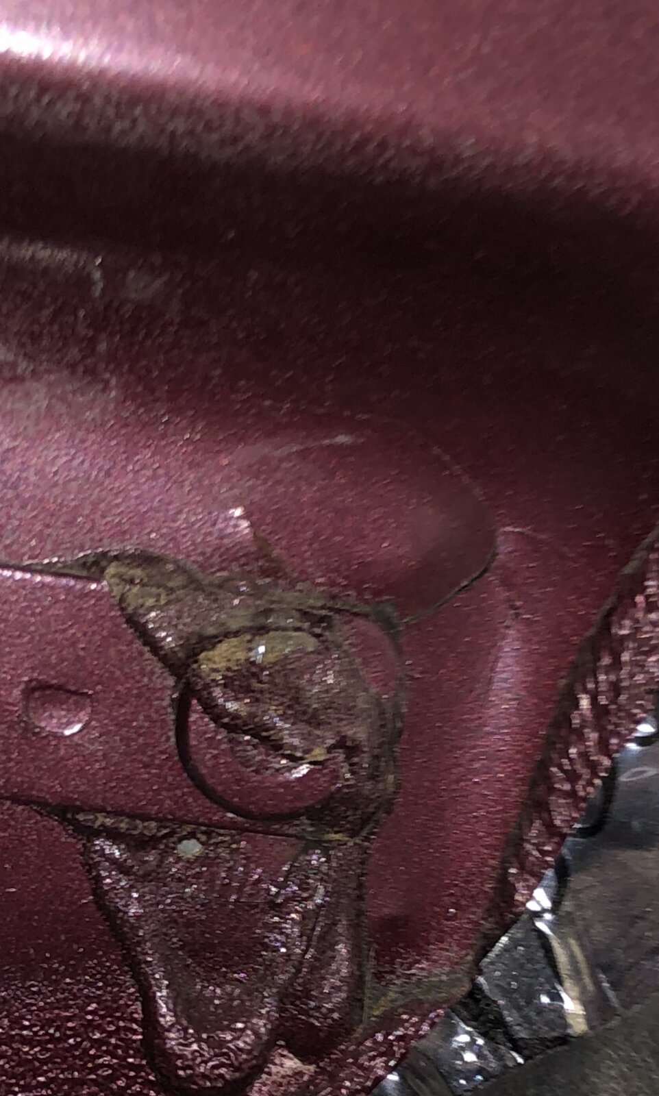

Thats a picture of my blown out firewall. Made a hell of a racket as the battery shook around. The really sad part is all it needed was something to tie the battery tray bracket into the fender like the factory did. A small bracket was welded to the poison spyder bracket and now the battery is rock solid.
If you can shake your battery/tray this is going to happen sooner or later.

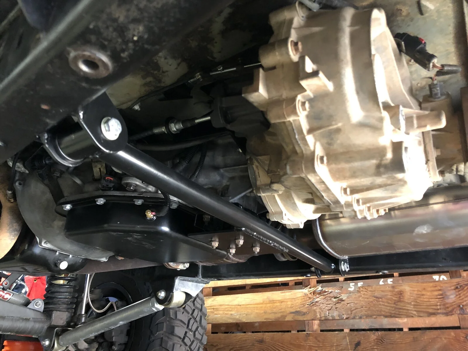

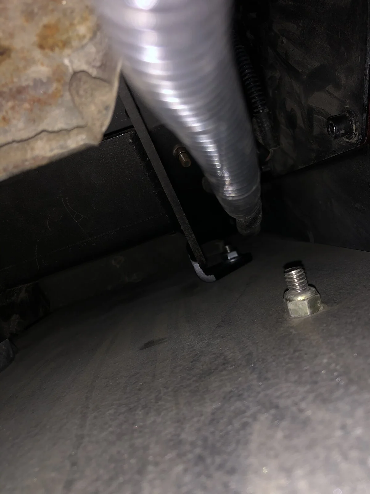

I didn’t take a good picture of it but here is one looking up from under the jeep. You can see a small bracket welded to the main bracket that ties into the fender bolt.
poison spyder decided it was ok to mount the entire battery to 3 bolts to the firewall. I think genright uses 4 but nothing on the fender.

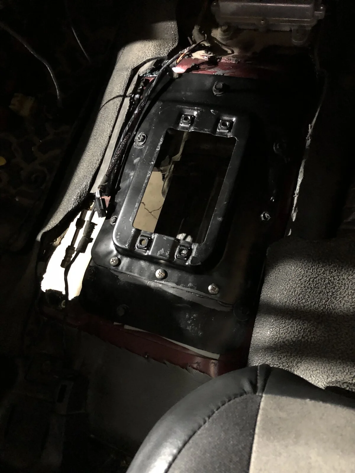

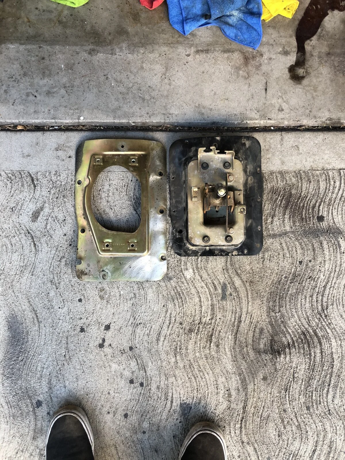

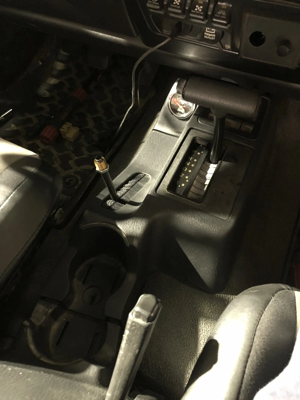

I have been meaning to make a thread about all the details but havent gotten around to it. I dont really like writing long winded write ups but it would be a great resource for others. I did not replace the harness on mine because i am experienced with wiring so i just modified my own harness as neccesary. The goal is to convert a 2003/2004 to a 2002. You need a 2002 auto PCM but could probably use 2000-2002, whenever they went to the coil rail. I spent a whole day comparing 2002 to 2003 parts and wiring so i know for a fact that 2002 vs 2003 is all good.
The only non transmission related difference is the 2003 single wire oil pressure switch needs to be converted to a 3 wire oil pressure sensor, which is accomplished by splicing into 5v and ground. You need to run 2 wires for the TCC lock up. You need to cut open the harness and find a very specific wire to splice into the neutral safety switch ground. While you are at it you can run a wire through the harness for the trans temp gauge you should be installing anyway. You need to add a single pin in the PCM connector for the TCC lock up and its a little finicky to add a pin to these PCM connectors as the unpopulated locations need to be drilled out after the connector is disassembled. Its easy to mess up the connector, ask me how i know.
The only other issue is the floor plates. You need to use a 97-02 shifter handle because the throw of the cable is different compared to the 03-06. The floor plate opening is also different between 97-02 and 03-06. I cut up a late model floor plate and bolted the early model floor plate to the late model plate. You just need to take some time to make sure the shifter is lined up in the console before bolting everything down.
If you arent comfortable with wiring you could get away with using a 2002 engine harness. However, this harness goes all the way back to the fuel pump. You should not need to change the fuse box/harness as the tcc 12v is shared with the purge valve which is where i spliced in.

I forgot to mention the trans mount. The 32rh mount is more forward than any other trans mount in a tj. Early model skids had provisions to mount the trans mount to the skid. Late model skids do not. You could probably make it work but I opted to go with a crossmember which I did not make myself. I paid a friend to fabricate and install it. I reused my UCF skid with a little modification. 241 prevented a flat skid.
i don’t think you could get this to work with a savvy skid. Even if you found a used early auto skid, it would take some modifications as the frame nutsert locations are different between early and late models.
