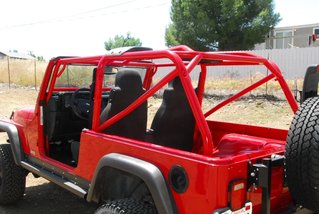

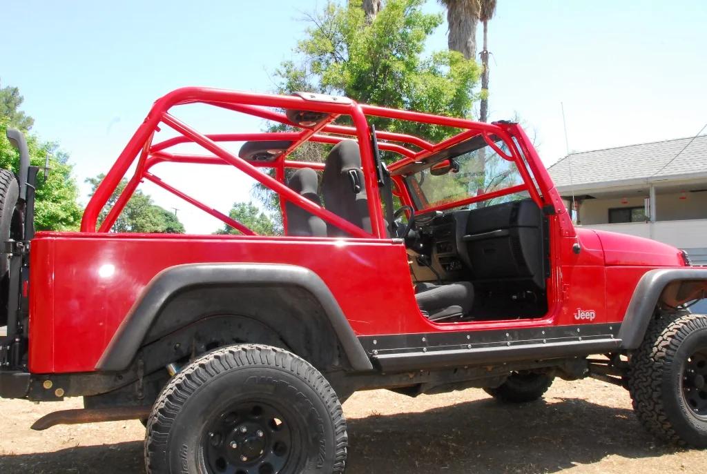

I have the Sport Cage from PS so the front is all replaced so I'd trust it over the windshield frame. I've see a few frames that have gone thru a rollover too. While they did OK I'd still rather have a cage.

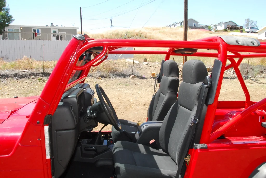

Why not do a thru the dash bars on the front? That would go to the floor and still allow you to pull the dash.
That’s probably what I’ll do then. I just don’t want to have to remove the whole cage to get the dash out, that would be a nightmare.

If you use the bent angle down legs that bolt to the dash where it is mounted on both sides with the 3 large button head Torx, you take a heater core job from 3.5 hours to about 30 hours. If you put the A pillar down legs in the corner behind the dash, the heater core job is still 3.5 hours.
I just did one, the owner was not pleased even though we had many discussions about why to NOT trap the dash.

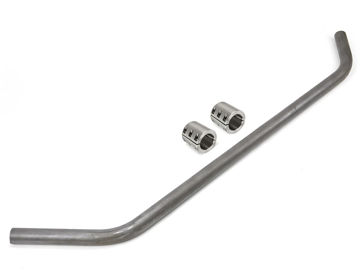

What are you doing for the harness bar? Weld in?
This is what I want to install into my TJ for a harness bar with the HD clamps. May or may not be the correct option but I I like that I can move it and remove it.
Universal Removable Harness Bar | GenRight Off Road
So you would drill holes through the top of the dash and feed the tubes down behind?
Problem : Roll over.
Answer : Don't roll over.
Is the stock cage not enough ? I can understand the benefits of what you are trying to do but .... do the benefits out weigh the cost ?
The stock sport bar is enough in most cases. However, I have a few things going on. For one I am going for the fastback look, which is purely cosmetic. For two, there will already be tubing installed for the harness bar and other provisions. I figure that while I am doing that I may as well just replace the entire thing.
