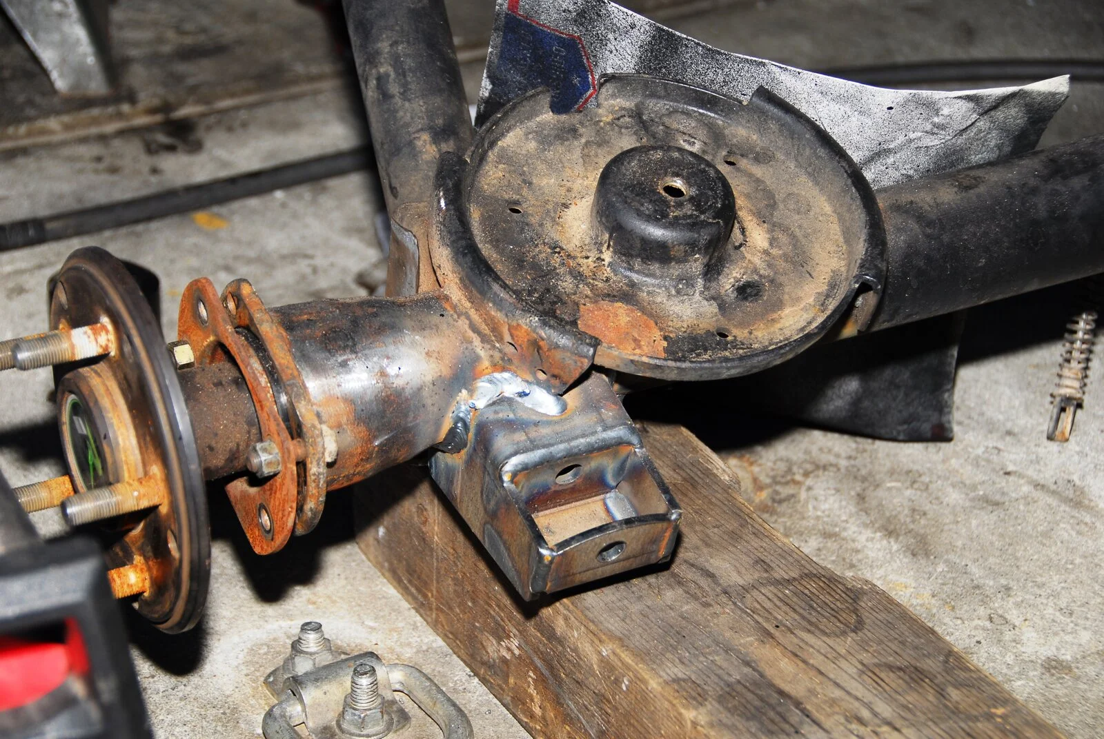

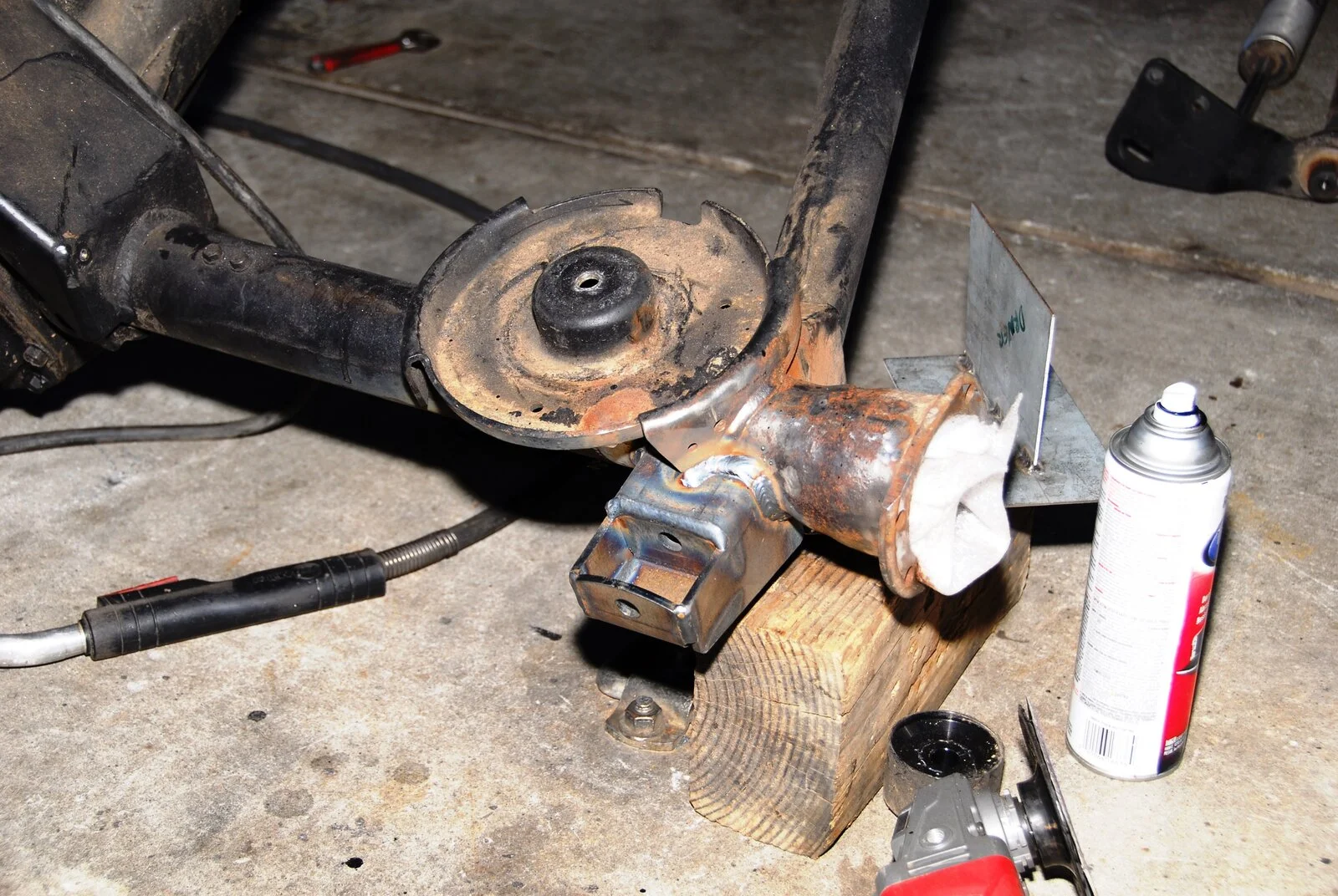

Blaine mentioned the rear calipers and brake assemblies were rusted so bad that there is barely any good metal to weld to. Any idea why that is? The rest of the frame didn’t seem to have any rust other than surface rust in very few places.

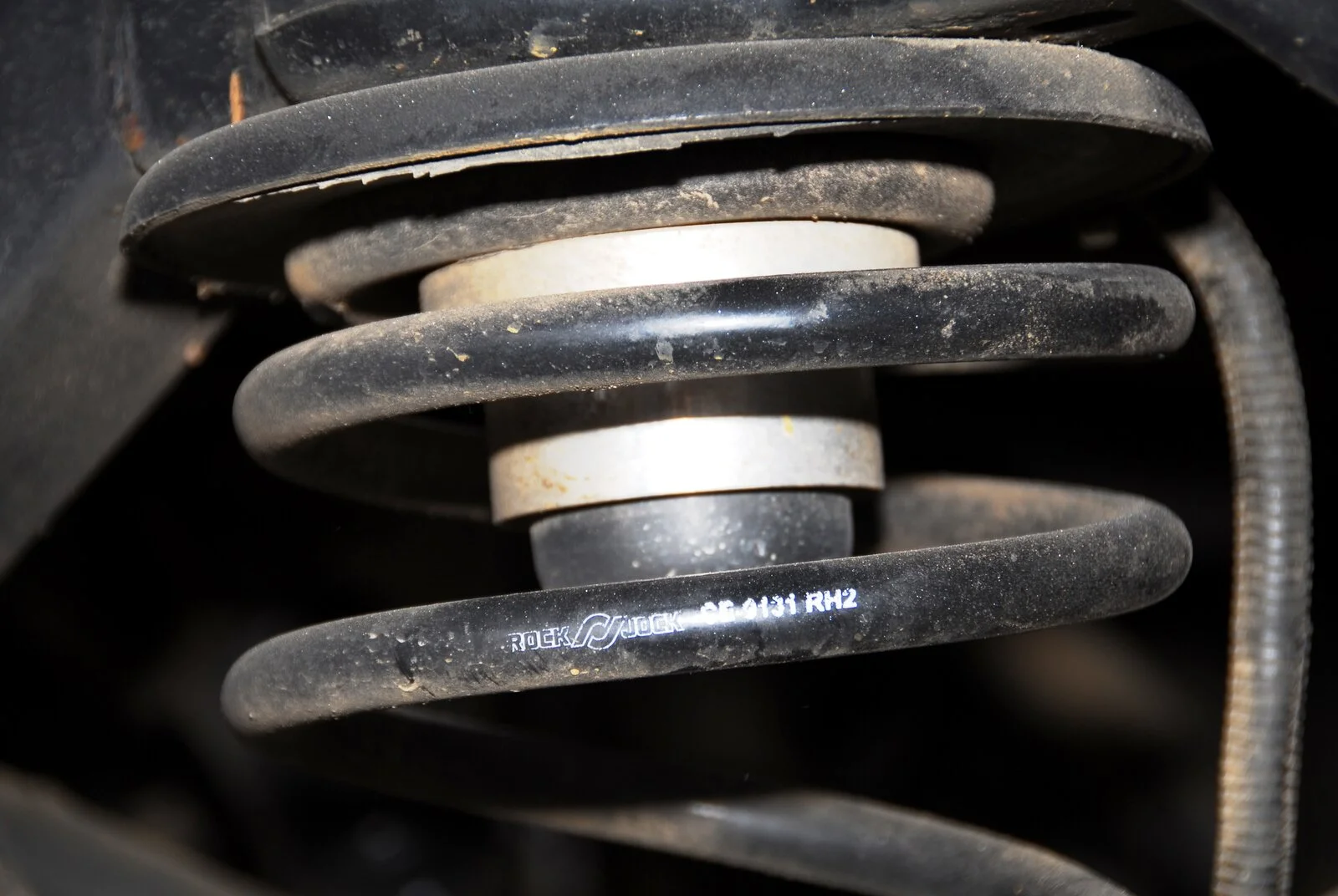

Bump stop cups are installer error. The calipers were very rusty at one point and got the rust painted over. No idea when or who.
The cup part is so the spring retainer goes over the stock dimple in the spring perch. Then the urethane bumper sits on the flat lower part. View attachment 231119

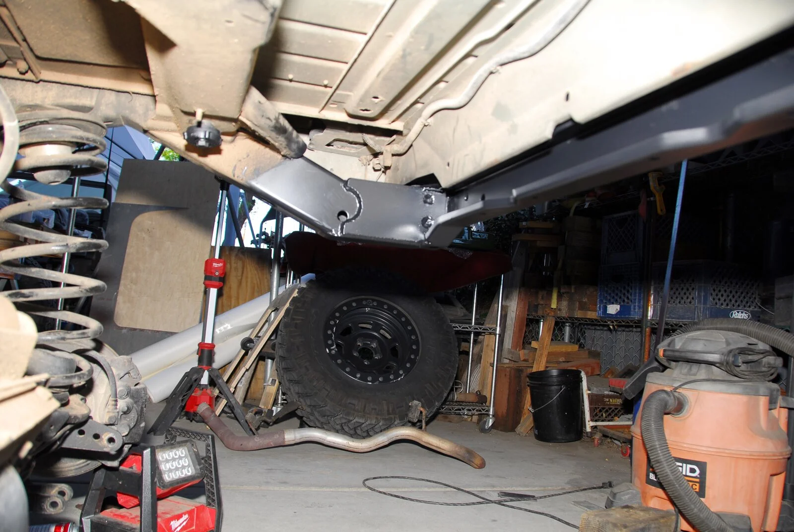

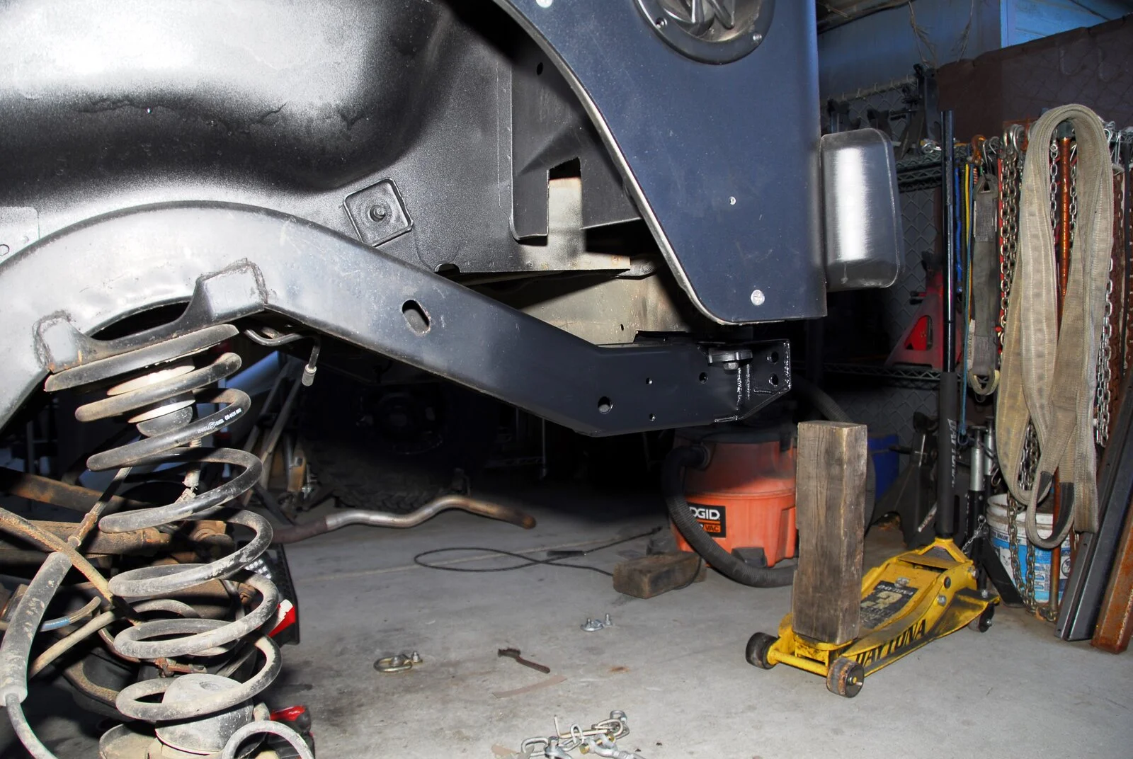

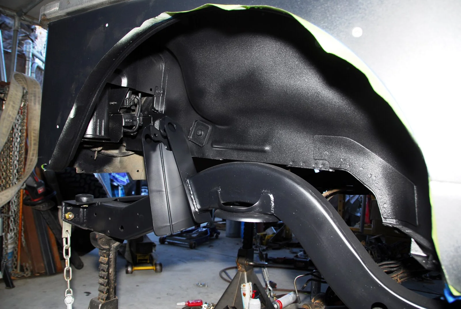

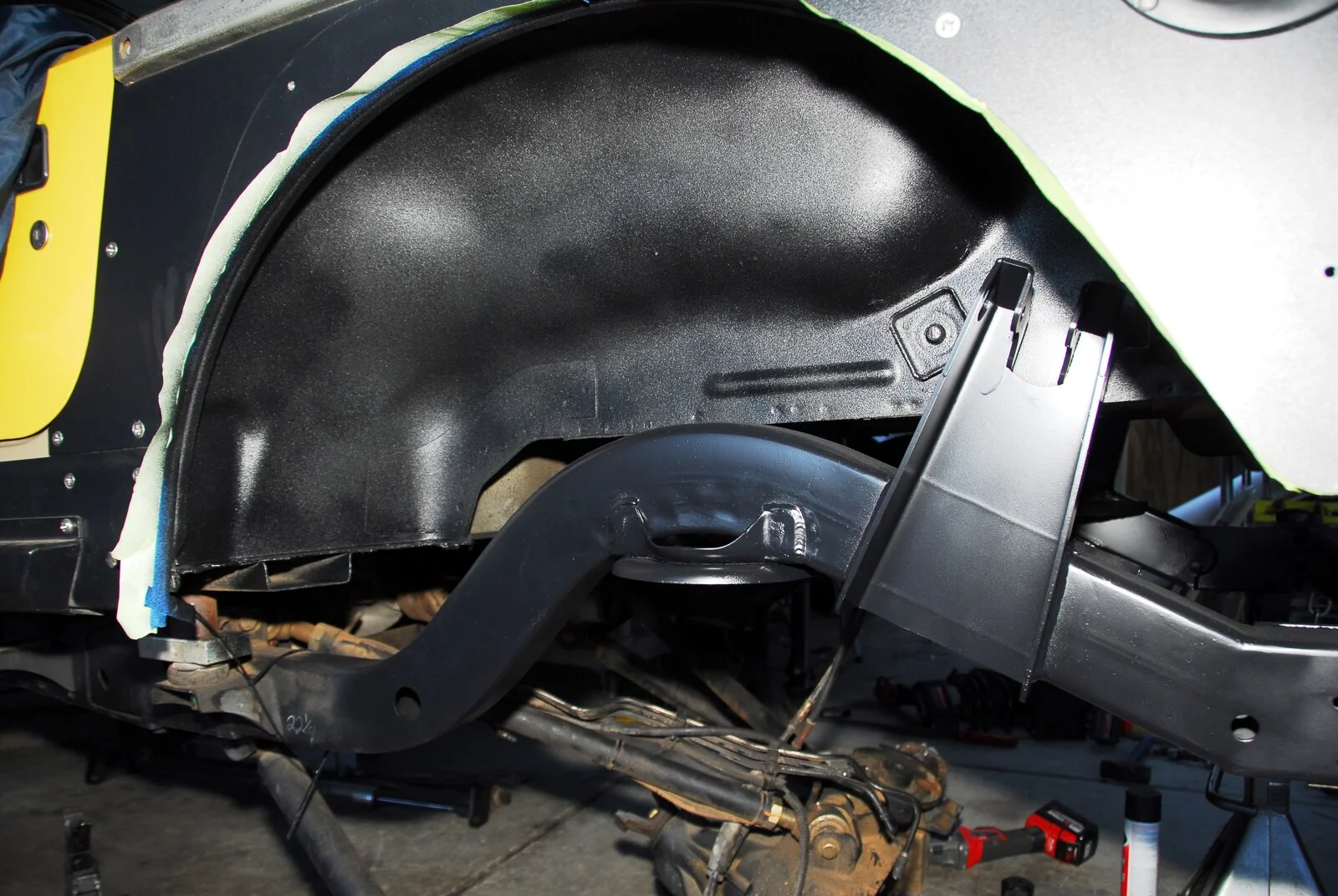

Correcting the upper coils mounts at the same time too?As many of you know my rig is now at Blaine's and he is doing a bunch of stuff to it.

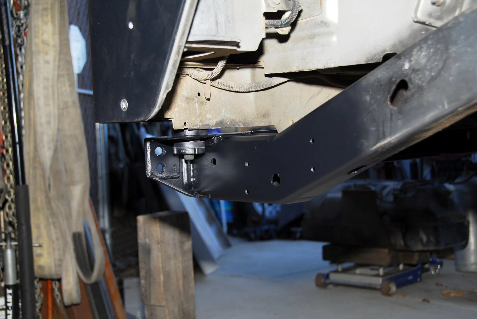

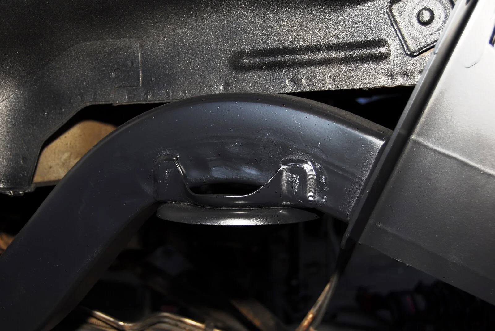

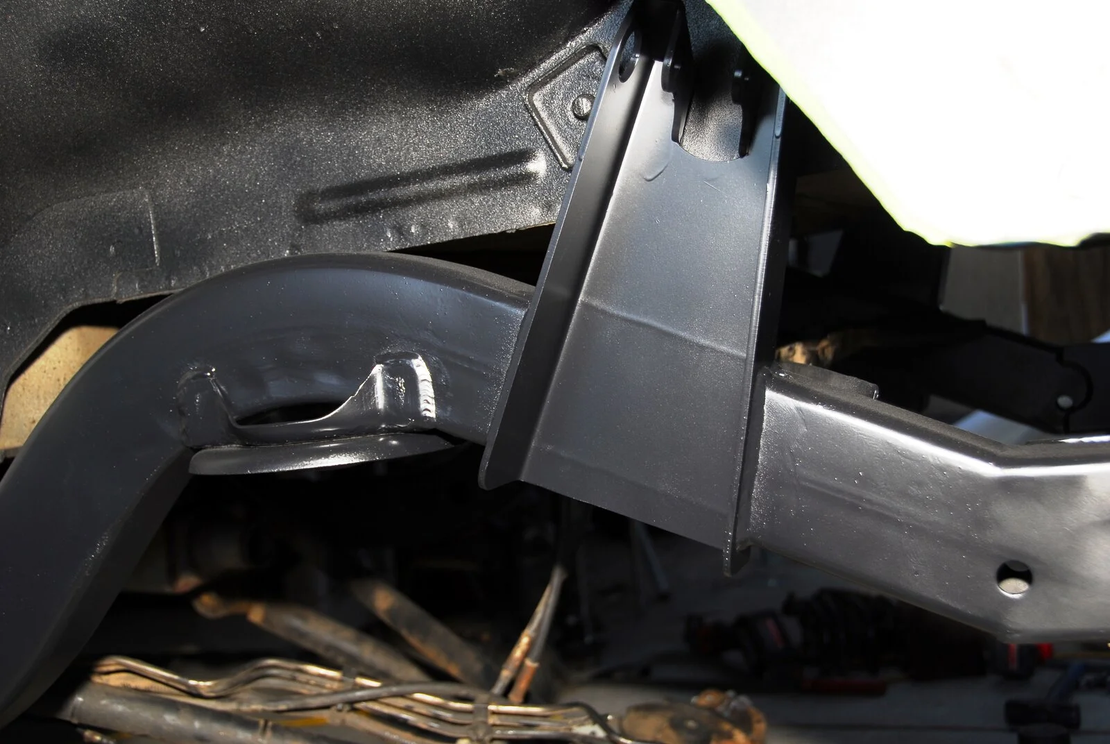

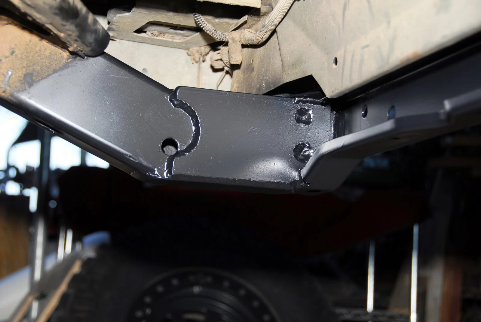

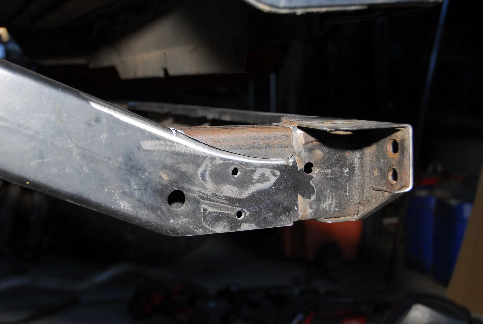

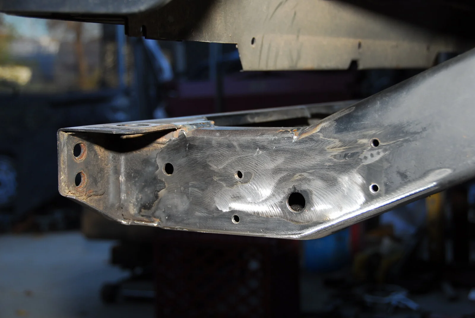

This is the finished result of him raising the rear frame. This will of course eliminate the body lift pucks in the rear (no more crack) which he is doing in combination with raising the body lift mounts on the side as well. Ground clearance will also be increased and the departure angle will be slightly improved as well.
If you didn't know what you were looking for you'd think this was factory:
Yes sir!Correcting the upper coils mounts at the same time too?
That question really confuses me.Correcting the upper coils mounts at the same time too?
Probably need to part it out based on all that rust.Of course then there was this:
View attachment 231382View attachment 231383
That’s from just one year in Massachusetts
