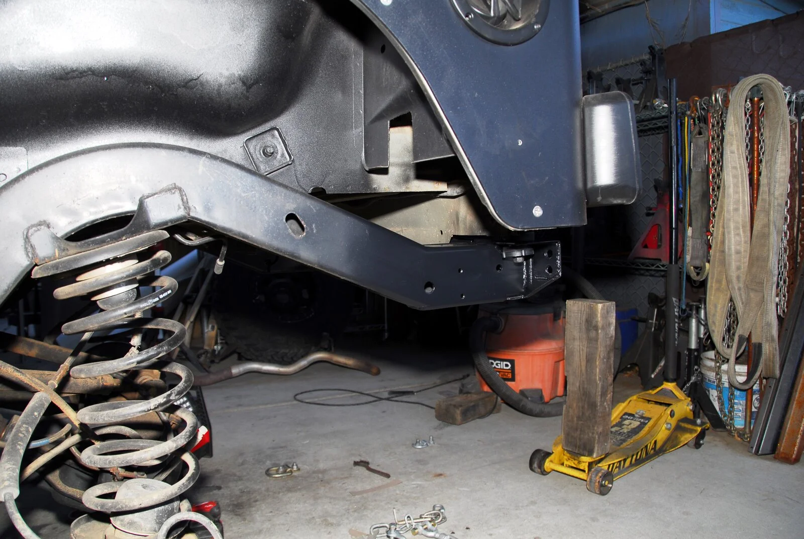

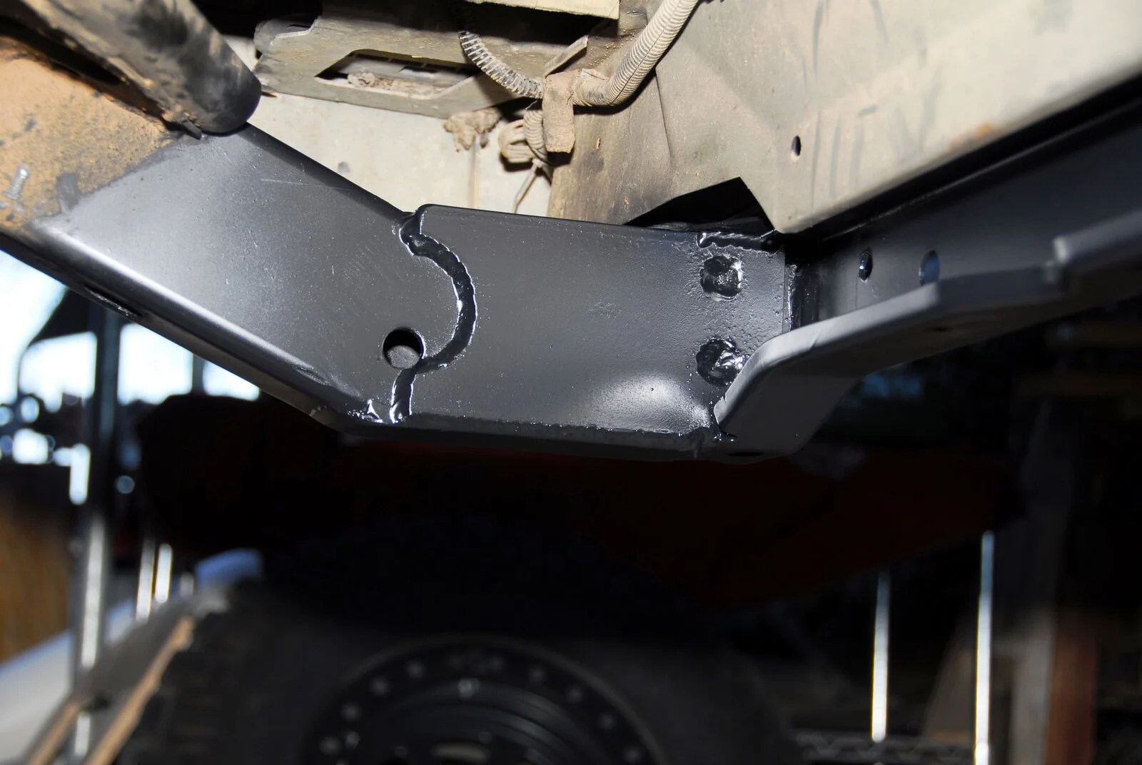

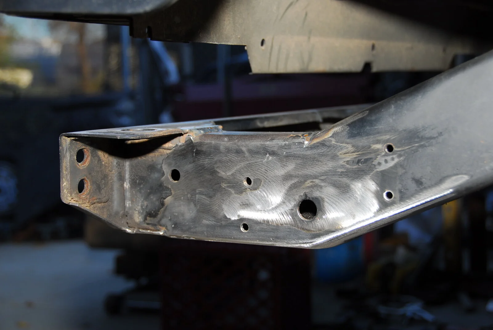

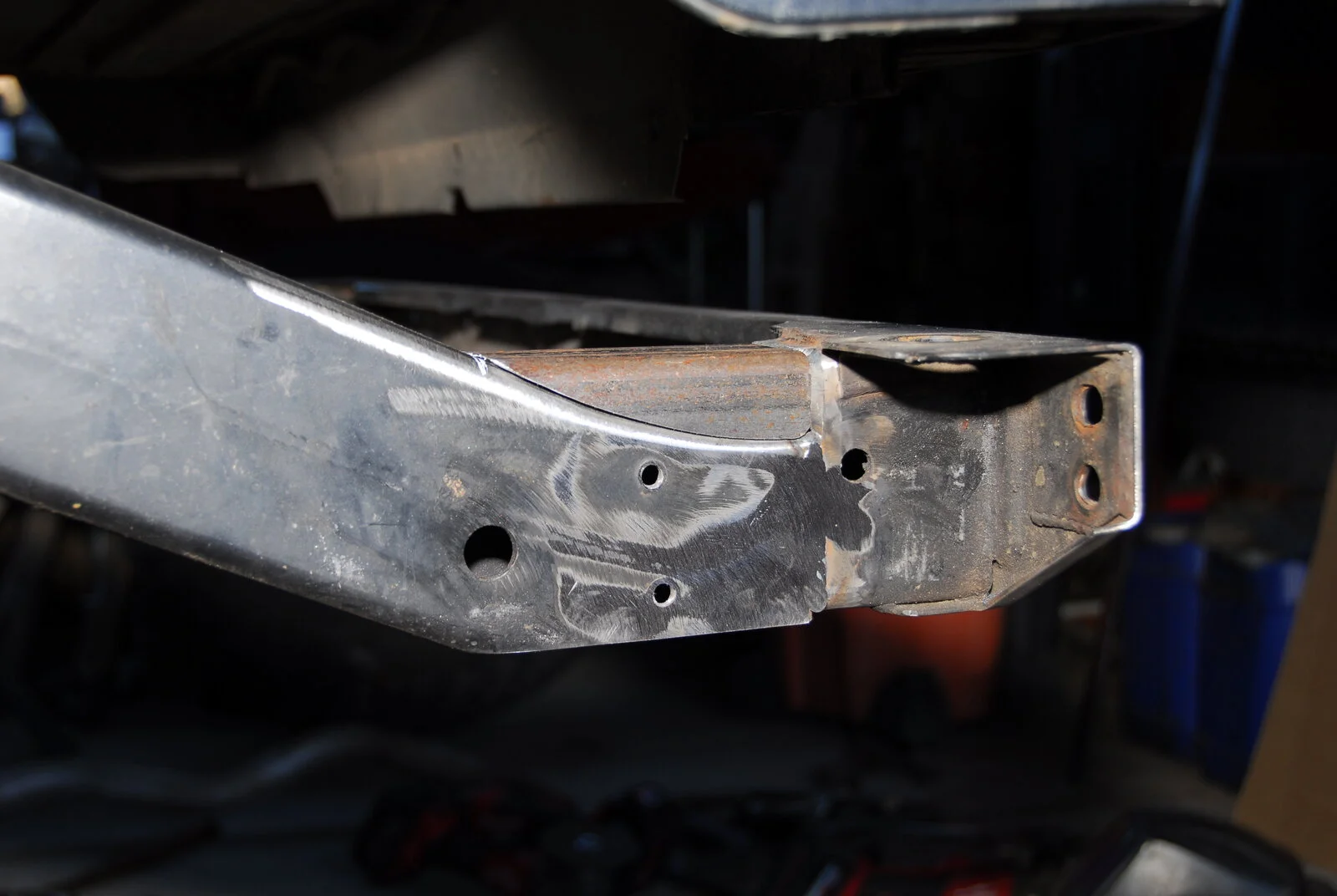

As many of you know my rig is now at Blaine's and he is doing a bunch of stuff to it.
This is the finished result of him raising the rear frame. This will of course eliminate the body lift pucks in the rear (no more crack) which he is doing in combination with raising the body lift mounts on the side as well. Ground clearance will also be increased and the departure angle will be slightly improved as well.
If you didn't know what you were looking for you'd think this was factory:

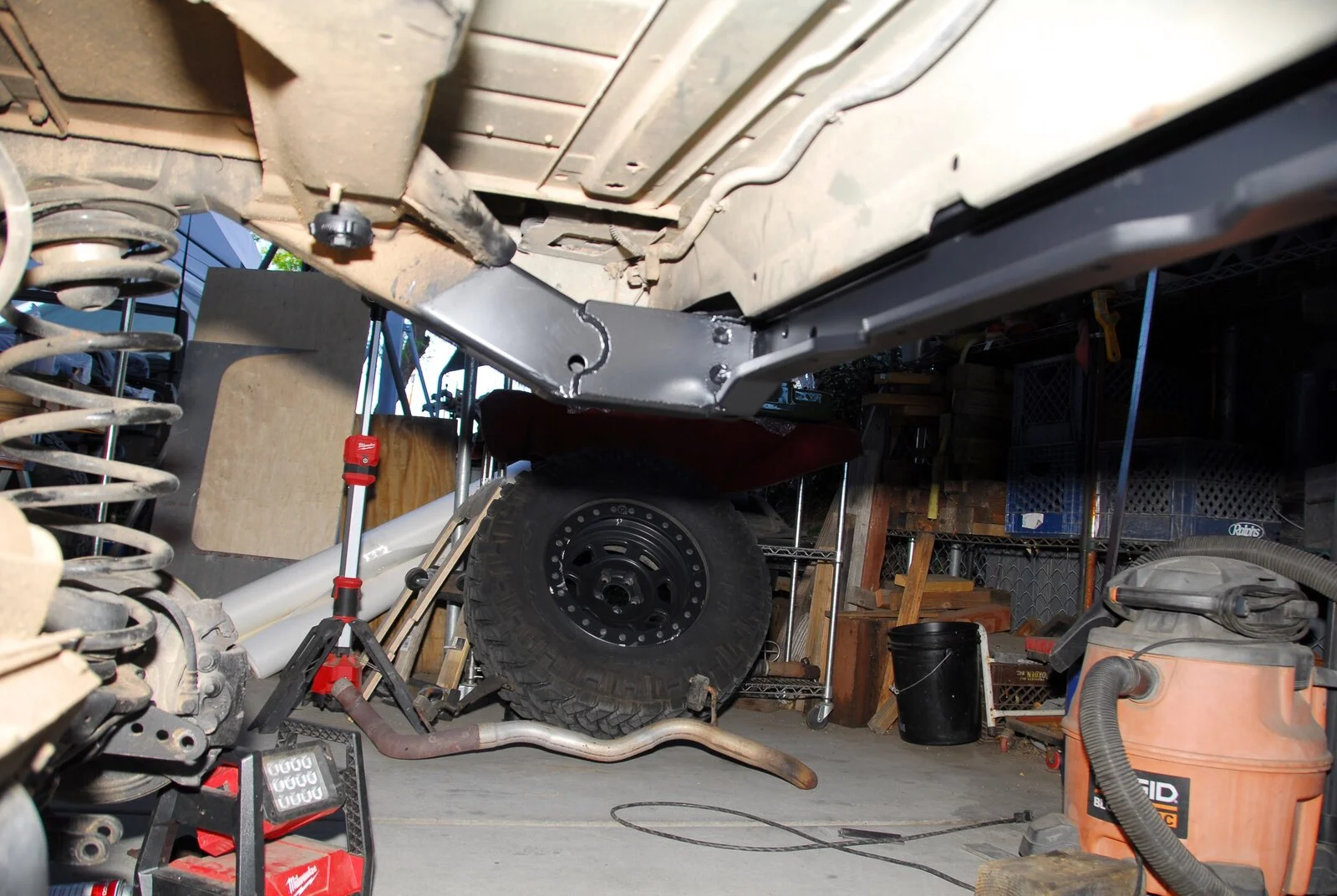

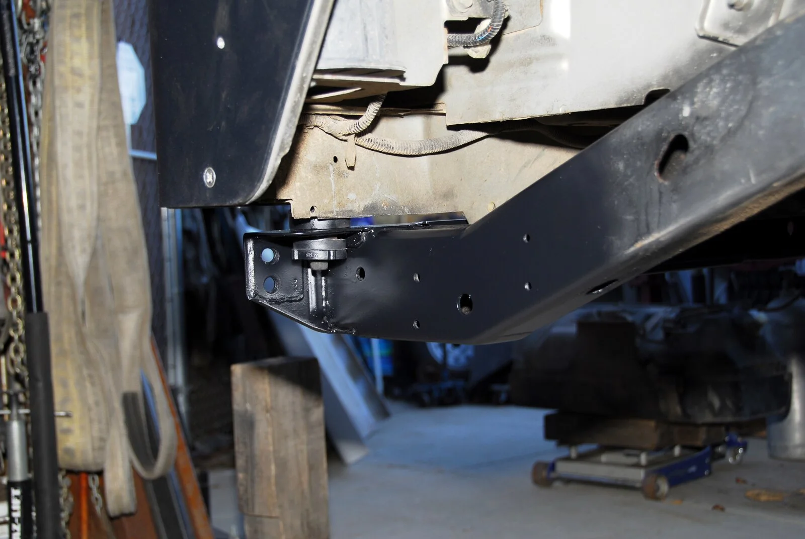

That always looks so much better than stock.
