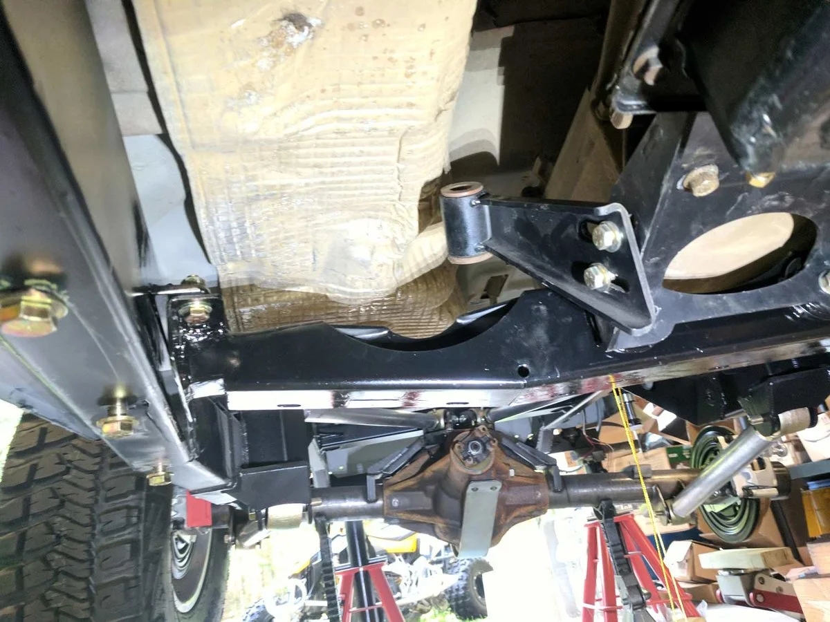

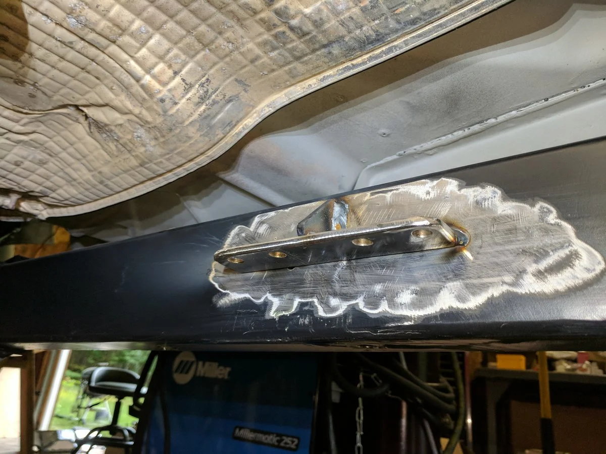

Could you still use the Savvy skid system with these? I wonder about the crossmember.
With some modifications, yes. Either open up the body mount hole or weld the crossmember mounting tabs to the frame and loose the wrap around portion. My intention is to weld.
Reactions: rasband and Sj's TJ
While you have the welder out for the body mounts just do a quick flip on the crossmember ends.
