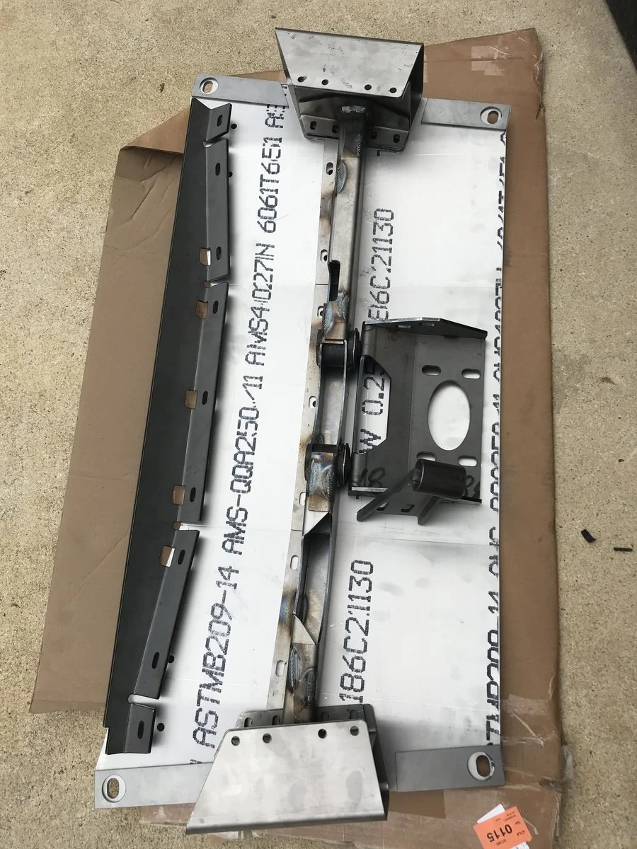

This thread was invaluable in helping me get the skid installed on my TJ. I wanted to add this pic though that shows all the parts in the orientation they will go...it can be a little confusing and might save someone some guess work...
Installed the Outer Cs last night was hoping I put them in correct. This photo shows the diagonal cut goes to the rear
