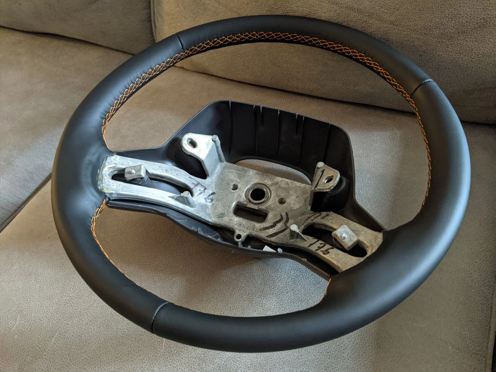

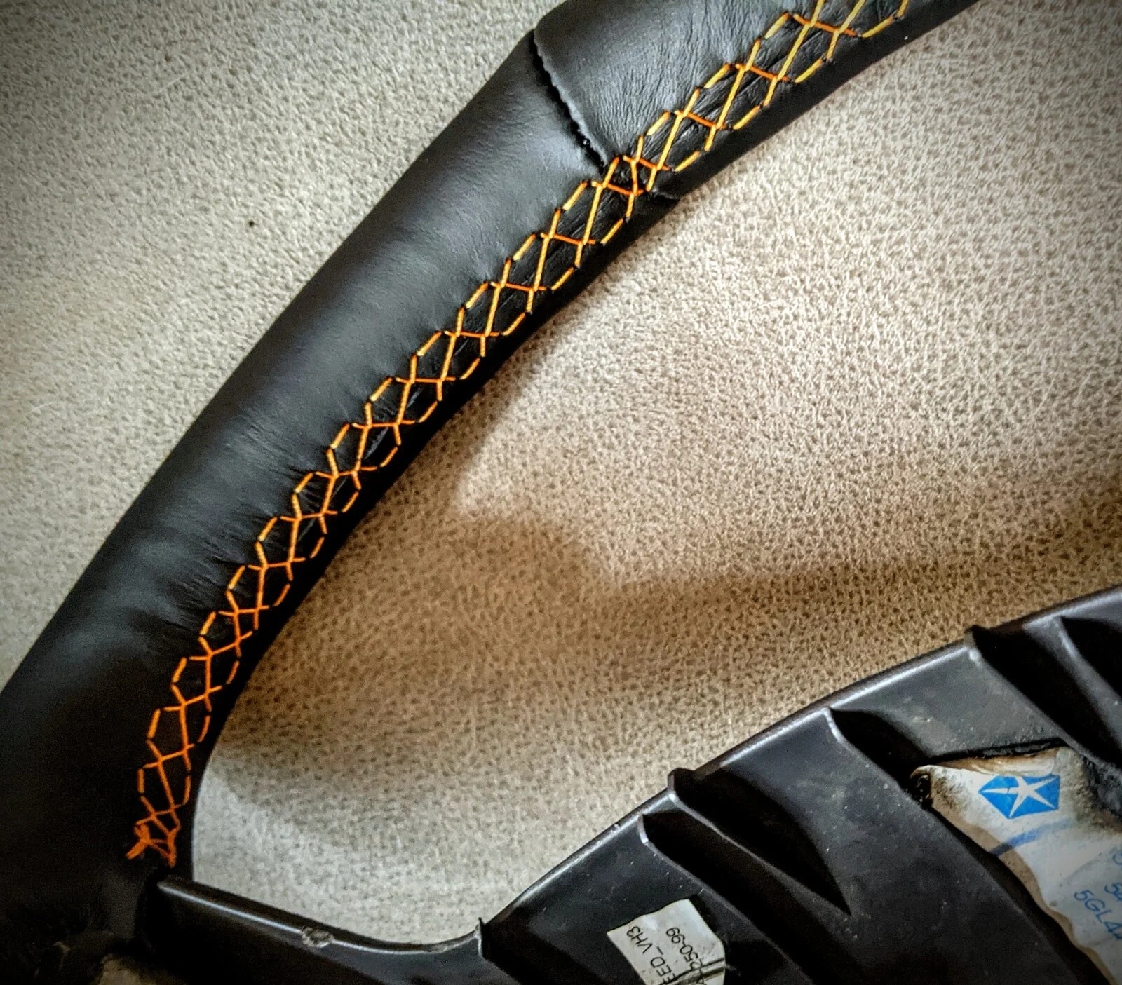

Well the guy in Poland came through. I sent him a message saying I wanted a wheel with black leather and orange stitching. He said no problem, PayPal him $265. A week later this showed up. The craftsmanship is spot on, the stitching looks better than most new cars. This is a very nice wheel!.
Be prepared to send $265 into oblivion with little to no communication. He did send me a message saying it was shipped with a tracking number. He obviously wanted to avoid giving money to eBay and had me PayPal him direct.
I guess you could keep things on eBay if you don't like taking risks. Yolo.
That's stitching is beautiful
