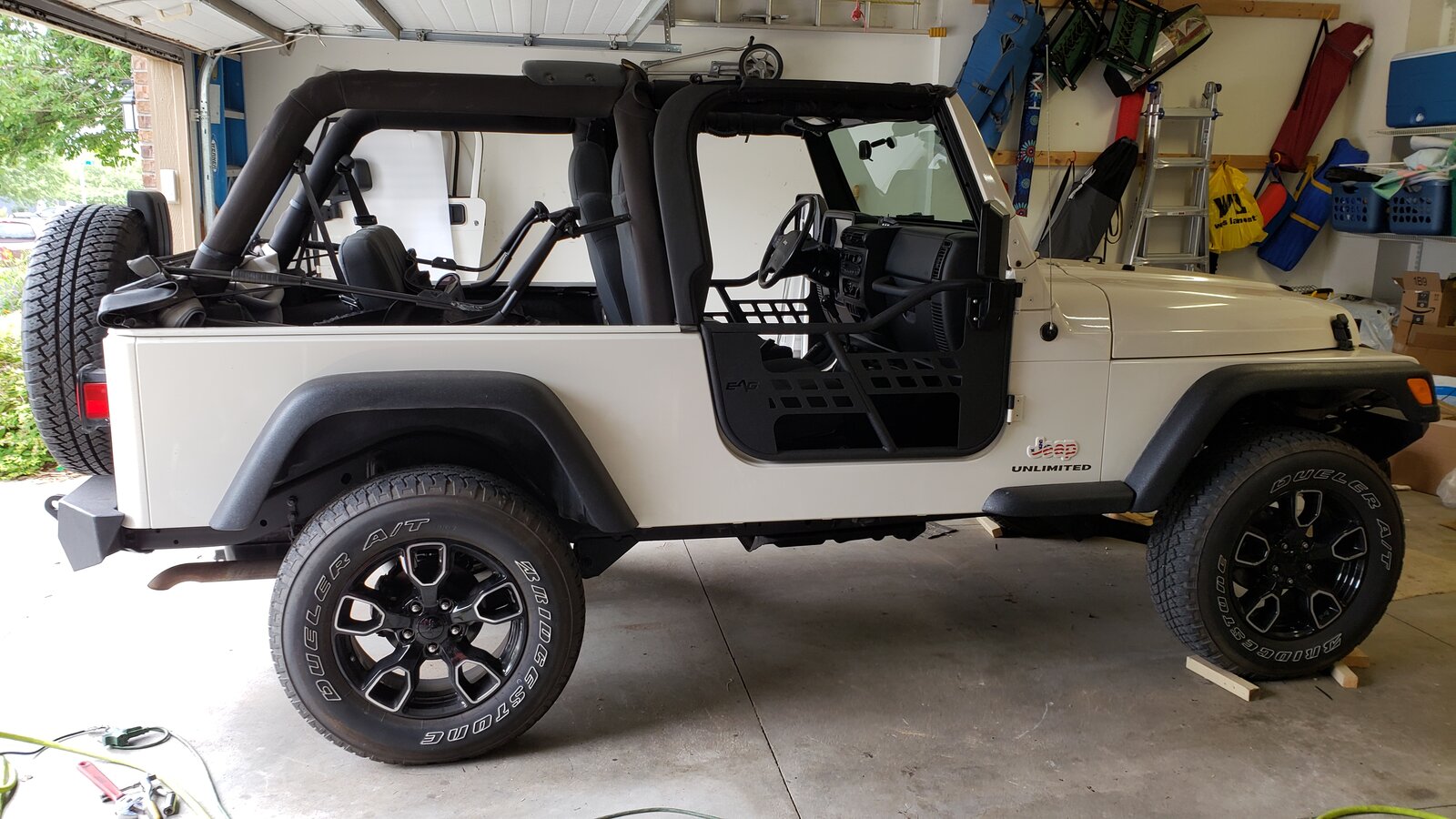

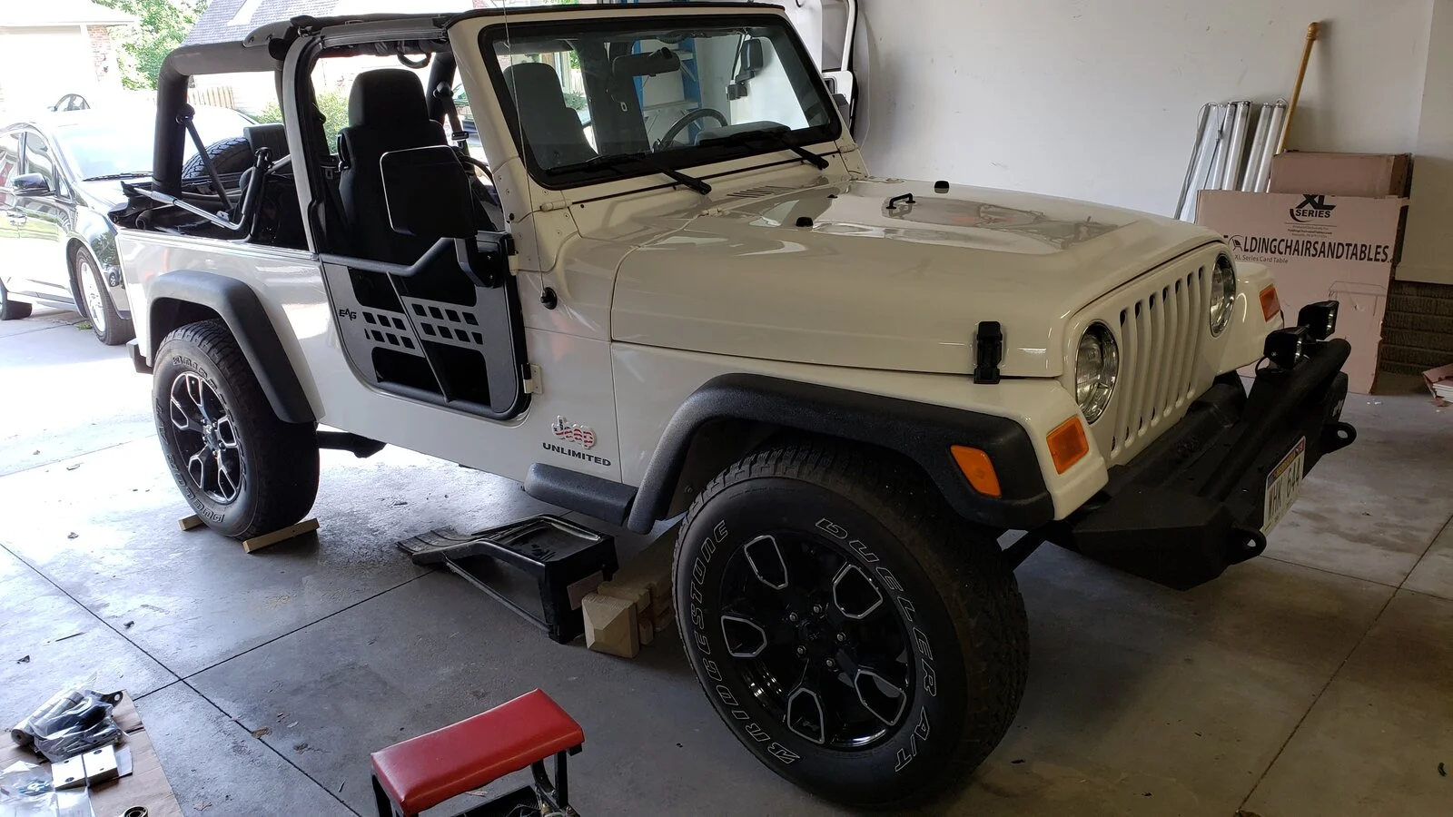

I have these. I don't like looking through my wheels to the other side. This is pre lift and looked way off to me.
Post lift was a little better. But I'm just not a fan.
