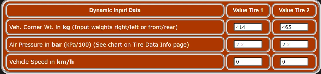

2.2 bar is @ 32psi
Note the contact patch differences
do you have a link to this calculator? I'd like to play around with it...and see what it says if the corner weights are equal. I would fully expect the contact patch to be bigger with 100 pounds more weight on it.
I played around with the numbers in that link I posted above and found that at a given pressure, the wider tire had a smaller contact patch at low loads load, but grew more quickly than the narrower tire, reached a crossover point, and then had the larger patch at more load. These were some sort of racing tires on 13"ish wheels that I can't find any more data for, so I have to assume they were similar load ratings...I would love to find some radius vs load data for tires we actually use.
