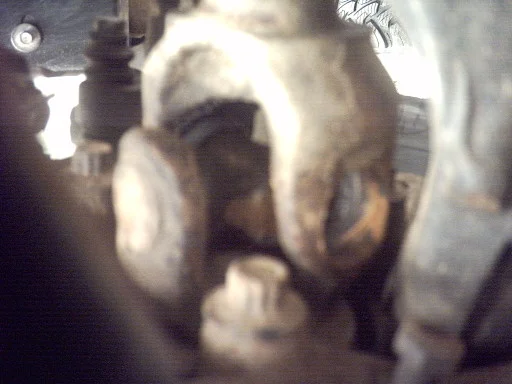

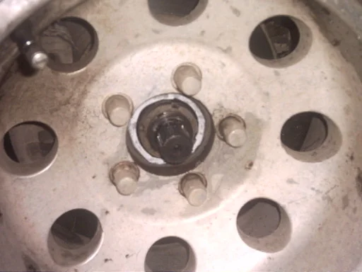

Broke the hub & u-joint when the tire got bound up. But as they used to say about the Warn small hub kit it was a good fuse.
If I'm not mistaken those are ford ranger explorer hubs. Certainly better to break one of those than shafts and spiders.if you have a lifted ttb rig you'll wind up breaking all that stuff too eventually.
Yup. That reminds me I need so find a spare hub for such an occasion. Lol.
They said back then that the Warn hubs were not a Ford hub but I don't know if that was true or not. But when that hub & u-joint broke it sounded like a gun going off and shot my hub into the unknown space cause we never found it.

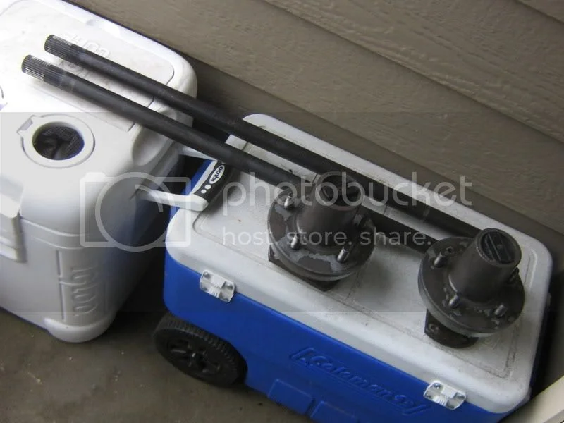

I had a Dana 35 rear but was running the Warn full float axles & Detroit and a lunch box locker in the front axle.

No it was still 27 spline inners & I think 30 spline 27 spline outers since it used the same small hubs that the front used. CroMo shafts of course. It was just the better option back then. Do wish Warn still made the full floater kits.
Edit: They were 27 spline both inner & outer as the Dana 35 hubs were 27 spline.
https://www.therangerstation.com/tech/warn-jeep-hubs-for-the-dana-35/
